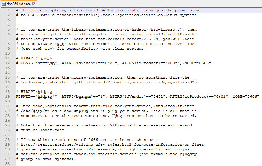

  • Hi User4686533,
    Have you created the .rules file under etc\udev\rules.d\ directory,
    please copy attached file into the target file system.
    /cfs-file/__key/communityserver-discussions-components-files/94/8015.dlpc350_2D00_hid.rules
    Let know if it works. below is the snapshot of the file.
    Sanjeev

    Since you were able to connect with TI released binary, I think the rules file not needed. From the above .rules file, you can just manually create a file and can have just one line, copy line #19. Rest of the things are comments.
    Are you executing your application admin mode or user mode, may be permission issues for the application execution. Otherwise I suspect your application compilation and linking, you can better compile HID library with your application.
    Sanjeev
