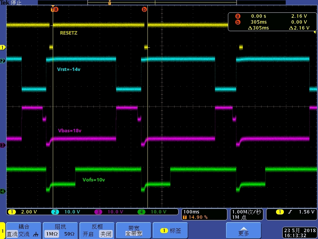

in my system, we use dlpc3438, dlpa2000 and dmd  DLP3010FQK.
but i found some of dmd is damaged withing dlpa supply's Vbias is drop down, and the RESETZ always fall down with period about 300ms
pls give me the right way to avoid it, thks.

  • Jianyuan,
    After analyzing your scope measure it looks something missed in your design. Can you share your design to review with us on Private message on E2E forum.

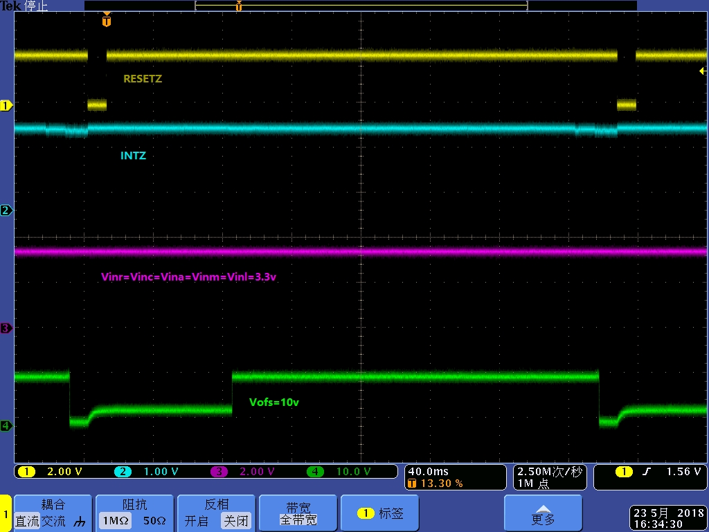

  • i think my system the fpc connect is ok. because:
    1. my system can get a correct projection with the good dmd.
    2. when we use the image to boot my system, dlpa can't brow up the Vbias if the connection is bad with dmd.
    3. it's has the same issue if my system use the demo board's connector,fpc,and the bad dmd.
    4. the demo board can't work ok , if we replace the bad dmd to the sets.and the Vbias and resetz are also follow down cyclically.
    it's can't find out the 3.3v fall down when the Vbias is fall down.
    and i replace the B68 form 10uH 200mA to 10uH 350mA, the issue is still in my system.
  • I have not checked your full design but i have seen that in your design you have connected RESETZ to strong Pull down. ReDesign that line and connect RESETZ to pull up.
    I hope this will resolve your issue.
