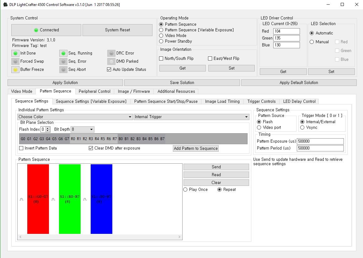

  • I follwed step below.
    1. I build the firmware by including images using provided GUI program(DLP LightCrafter 4500 Control Software).
    2. I updated firmware.
    3. I set the GUI program.
    - pattern source : Flash
    - Trigger Mode : Internal/External
    - Pattern Exposure : 500000
    - Pattern period : 500000
    4. I created the pattern sequence in the 'Individual Pattern Setting' section.
    I set it as shown below.
       Flash index is 0(it is image of DLP 4500 logo included in basic firmware).
    5. I click the send button.
    6. I play the pattern sequence in 'Pattern Sequence Start/Stop/Pause' tap.
      The result is the same as the follwing video.
    I do not see the image because I set it wrong? Or is it that way?

  • Hi MinGu,
    I see you are trying to display 3 8-bit patterns from image index - 1; you need to remember which index the image of your interest located. Accordingly you can select the image index in your pattern sequence page.
