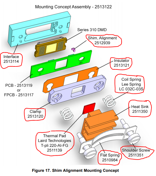

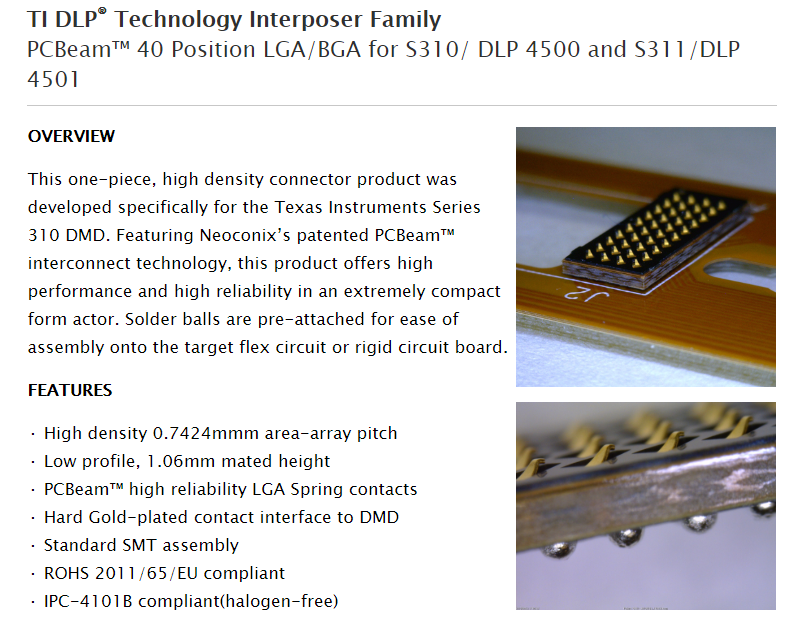

I have received information from sales that DLP4500FQE will be EOL in July 2019 therefore I wish to continue to use DLP4500. As I can see that the alternative is the LCCC package DLP4500FQD but I have the following questions which need your help to clarify.
1) DLP4500FQE comes in connector type and DLP4500FQD comes in LCCC package. Would like to know whether what is the soldering profile for DLP4500FQD and how is it to be mounted in the board? What is the installation and handling method?
