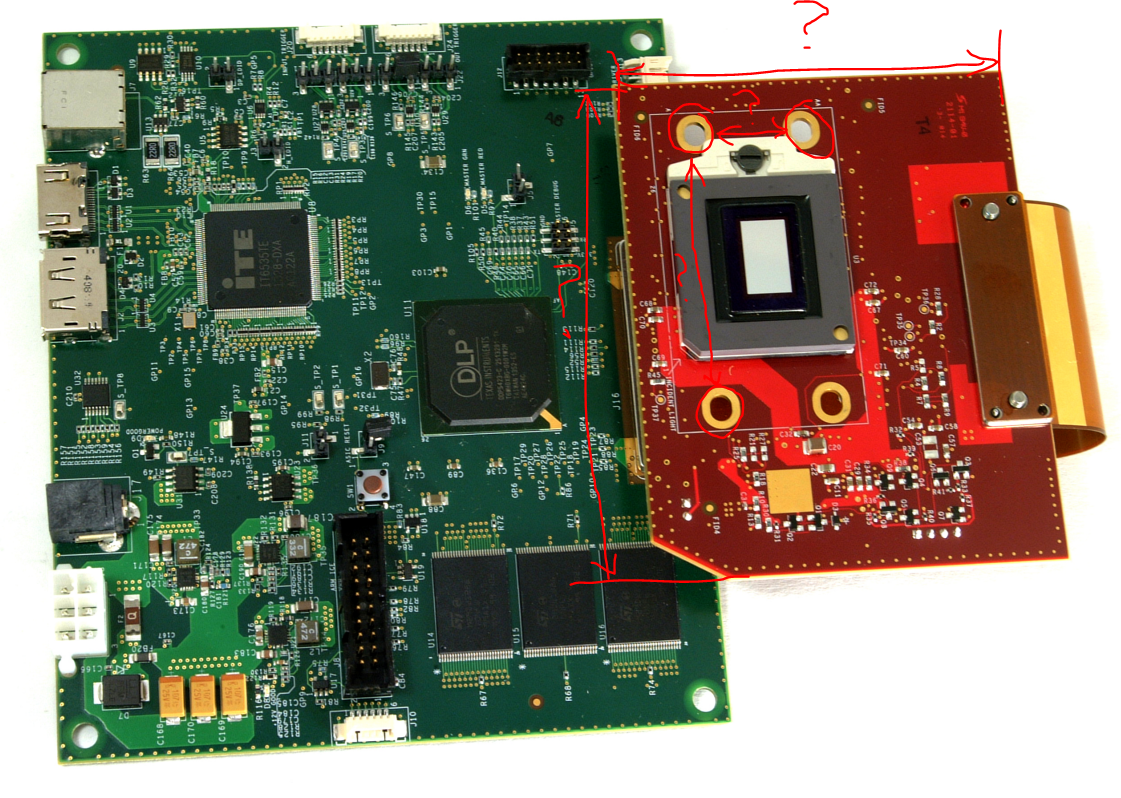

Hello Everybody,
Thank you for your patience to read this question.
I can't find the precise positioning  of screw mounting holes and  the size of the  DMD board  in the above picture.
Any mechanical dimension information would be very helpful.

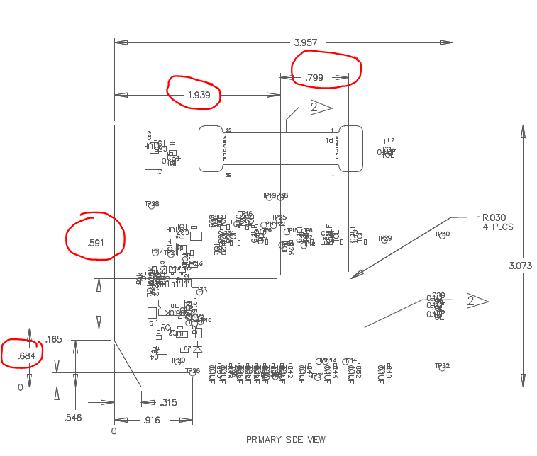

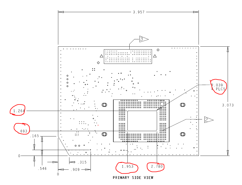

  • Hello Taylor,
    Thank you very much! I got something I need. However,i I was confused by the following two figures.
    fig1: from 2511980_LCR6500_DMDBOARD_P65_1080P_S600_CSTACK_FLEX_CONN_Assembly.pdf
    fig2: from DLPLCR6500_DMDBOARD_P65_1080P_S600_CSTACK_FLEX_CONN_Assembly.PDF
    As shown above,which is  the actual size?
    Furthermore, i have nothing about the size in the following fig.Is there a pdf file marking the size like DLPC910 SINGLE ASIC.PDF?
    Looking forward to your answer.
    lollows
  • Hi lollows,
    I am not sure why there are slight mismatches on those first two figures, but I recommend referencing the most recent file that starts with 2511980 as this one matches our gerber files. I have notified my team to remove the older file from this directory, so thank you for pointing that out to us! As for the screw mounting holes, there is a drill chart table on the left side of that same pdf file. It lists the dimensions of those 4 holes in units of mils.
    Taylor
