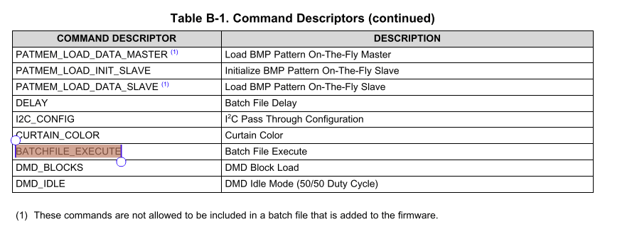

I am trying to understand how to program pre-stored pattern mode. As per the manual, we can load 400 uncompressed binary patterns into firmware. We did that. The overall firmware size is 9593KB which is successfully uploaded without deleting already existing images on the flash.
Now, I need to run the images one by one which requires changing the index from 0 to 417. After displaying one pattern, I need to invoke external program to save an image from camera. If I look at the programming guide, there is something like BATCHFILE_EXECUTE.
Can I use this command to invoke external application? If yes, could you please give any specific examples related to this command. I am looking to see if the triggering can be avoided as the voltage levels are different and if I change the camera, I need to redo the electronic circuitry.
  • Hello Chaitanya,
    This command is only designed to run batch file commands in the API, not any external applications. You should think of the command as "Execute Batch file"
    Our recommendation would be to set up a voltage translator circuit or even better and opto-isolator for the trigger.

    Hi Fizix,
    Many thanks for your reply. Just wanted to to ask 2 related questions.
    1) Regarding trigger input to the DMD, My camera outputs 5V high and 0V low. So wouldn't a simple resistor divider network be enough or am I missing something here?
    2)  Regarding batch file commands, May I ask how many batch files can be uploaded into the firmware? Can I execute each batch file separately from GUI?
    Chai
  • Hello Chaitanya,
    You are correct that a simple resistor divider network can work.
    Many that use trigger systems prefer opto-isolators in order to isolate electrical noise and/or voltage spikes.
    The voltage translator circuit has the advantage that you do not have to change the resistors in your network if you change to a system with a different reference voltage. You simply the reference voltage to the translator.
    I hope this helps.
    Fizix
  • Hi Fizix,
    Yes, Triggering mechanism worked. I used DMD trigger out2 to trigger camera instead of camera to DMD.
    Thanks a lot.
    Chai
