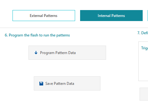

dear Sir.,
where is the save pattern data and how can I use the save pattern data?
2. from ticket below.

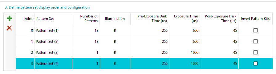

by the way, when i increase the pattern set to 4 sets, the program shows an error as attachment.

  • Hi Frank,
    Are you saying that the Save Pattern Data option is not working?
    Also, what error are you getting while using 4 pattern sets?
    Azad
  • hi Azad,
    no any response when I click "save Pattern Data".
    set pattern failure log is already in the first content. I upload again below.

  • Hi Frank,
    Please let us know if this problem still exists? Please let us know. I will tentatively close this thread
  • hi Vivek,
    can I know what's the answer?
    BR,
    frank
  • Frank,
    The issue with "save pattern data" button will be fixed in the latest version of the GUI, which will be available on ti.com soon. Please note that you can still use "Program Pattern Data" button to download the patterns to flash, though it doesn't return any success acknowledgement.
    I'm not able to reproduce the error relating to pattern sets. Can you share how many patterns were added per set and when exactly this error occurred?
    Azad
  • Azad,
    You mean it would save the pattern data to flash as well when I click "program Pattern Data". So, how can i use the data in flash rom without send the "program pattern data" again?
    I cannot see the issue again. But I can see the other issue with the same test condition. I just add the pattern set to 4 pattern sets as below. each patterns are 1 bit horizontal or vertical pattern. when I click "Run Continuously", the projector only displays once. I need to click stop so I can do others.
    BR,
    frank
  • Frank,
    Yes, pattern data will be stored to flash. To reload the patterns stored in flash using GUI, use the "Run" (or "Run Continuously") option directly without hitting "Program Pattern Data". Without GUI, patterns can be reloaded from flash using the Write Pattern Order Table (98h) I2C command. For more information on using I2 commands, please refer to the Programmer's Guide here: http://www.ti.com/lit/ug/dlpu075/dlpu075.pdf
    Regarding your other issue, are you saying that the 'Run Continuously' feature only loops one pattern set? Or that it runs only once? Please clarify the issue you're facing.
    Azad
  • hi Azad,
    it only run once even i click "Run Continuously" when the pattern sets is more than 4.
    So, i only can see one run of image from projector. After that the projector stop, I have to click stop and run to see next pattern out.

  • Frank,
    I'm not able to reproduce the issue. I'm using 16 pattern sets, and when I click 'Run Continuously', all 16 patterns sets are looped indefinitely. Can you try with a different set of patterns, preferably with the patterns in the default firmware image?
