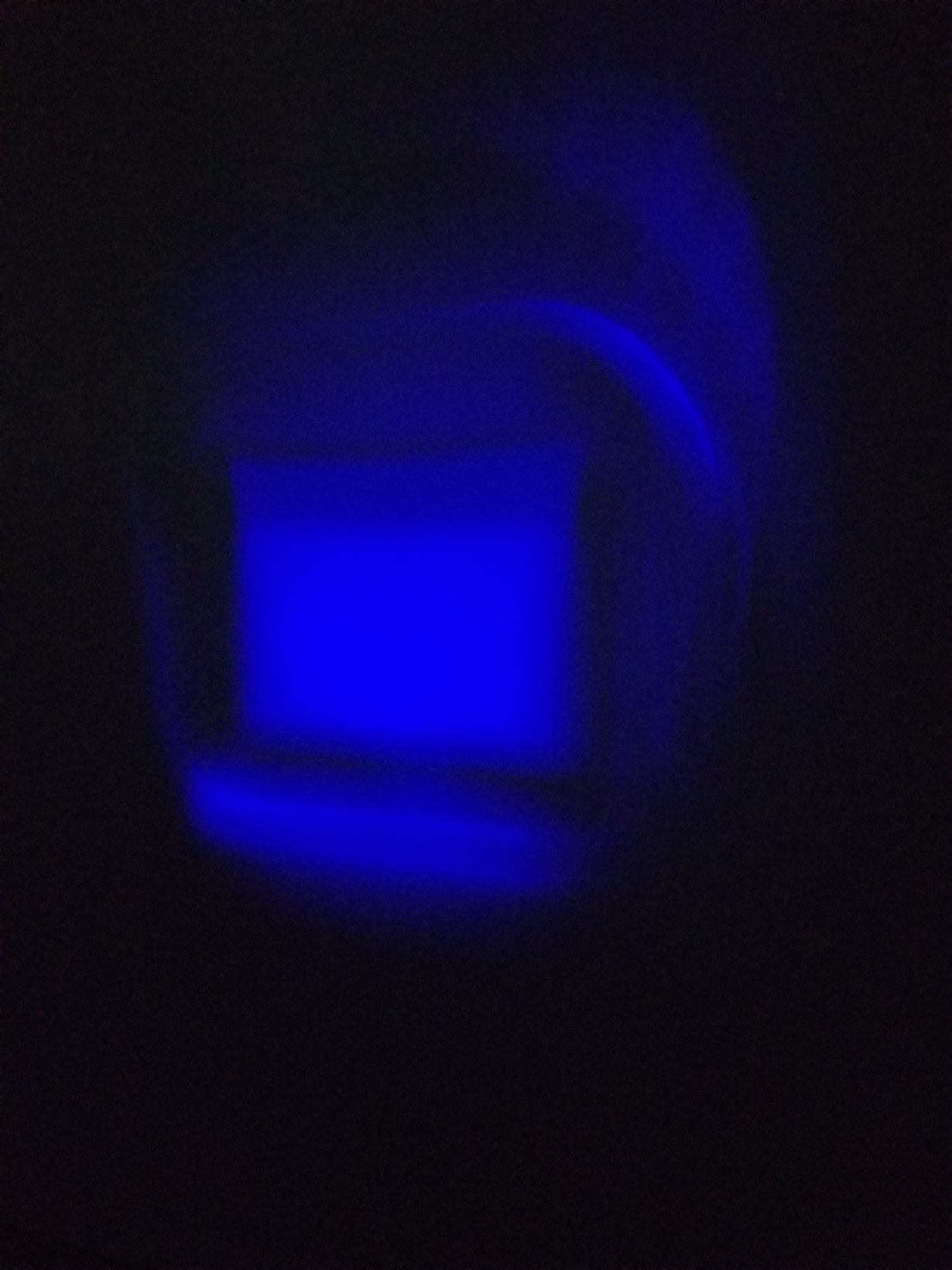

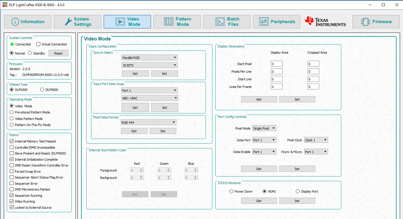

  • So we're actually running the DPLC900 off a Raspberry Pi with a custom python driver that uses the I2C commands. We have two more light engines that also use the DLPC900 that we control in this way and it works well. I decided to replicate your tests and install the windows software to see if there could be a problem in our system.
    I installed the software, and after startup I set the DLPC900 to normal video mode and I appear to have good status on everything, including video lock on the HDMI port:
    As soon as it starts up, this is the image I'm getting (below). Even in normal video mode when I switch the images, I don't see any change on the output of the light engine. I always get the same white square that shows up on startup.
    Do you see anything immediately wrong with this approach? I think I'm doing all the I2C stuff correctly in our other driver, but it is giving us the same result as this test with the Windows software. I also tried replicating your batch commands in the batch mode section and was unable to get that to work either.
  • Hi Matthew,
    First you have to get it working on video mode itself. Just try connecting a PC video output to hdmi first and see if that is working.
    What is the video frame rate?

  • When I run the DMD from the TI software from a windows machine via USB, normal video mode works. I'm trying to run it now from a raspberry pi via I2C. I power up and read all the status registers, and I get
    System status: 1  Hardware status: 1   Main status: 26    Error code: 0
    From what I understand, this means everything is working properly and I'm locked on source 1 with valid syncs. So everything looks good. I then set to normal video mode, and I get the same values from all the registers but I get no image. At this point from the windows software, it works.
    I decided to try to figure out how your windows driver was doing things so I monitored the packets being sent back and forth over USB and it looks like your windows driver queries status, sets power mode, and then sets video mode. After that it appears to read the firmware version and run some batch file.
    I decided to try to set the power mode on startup to normal by writing 0 to 0x87, but when I do this I get error #4 (incompatible DMD/controller) and then subsequent reads of the hardware status give back 2 (incompatible DMD/controller).
    I think the windows stuff works because there is something else the windows driver does during initialization. How do I properly initialize the system, step by step? Section 4.3 of the programmer's guide says this shouldn't be necessary, but I see the USB driver running something else to set it up.
  • Upon further inspection of the commands sent from the windows driver, I have confirmed it only sets the video mode.
    When I run the device without usb or i2c connected, it starts up into normal video mode without trouble. As soon as I connect the i2c and start it up, nothing happens.
    It appears that just connecting i2c (and not even sending any commands) somehow disables the auto power up configuration that happens otherwise.
    What I need to know is the sequence of commands that are auto-configured on power up so I can replicate them with i2c.
