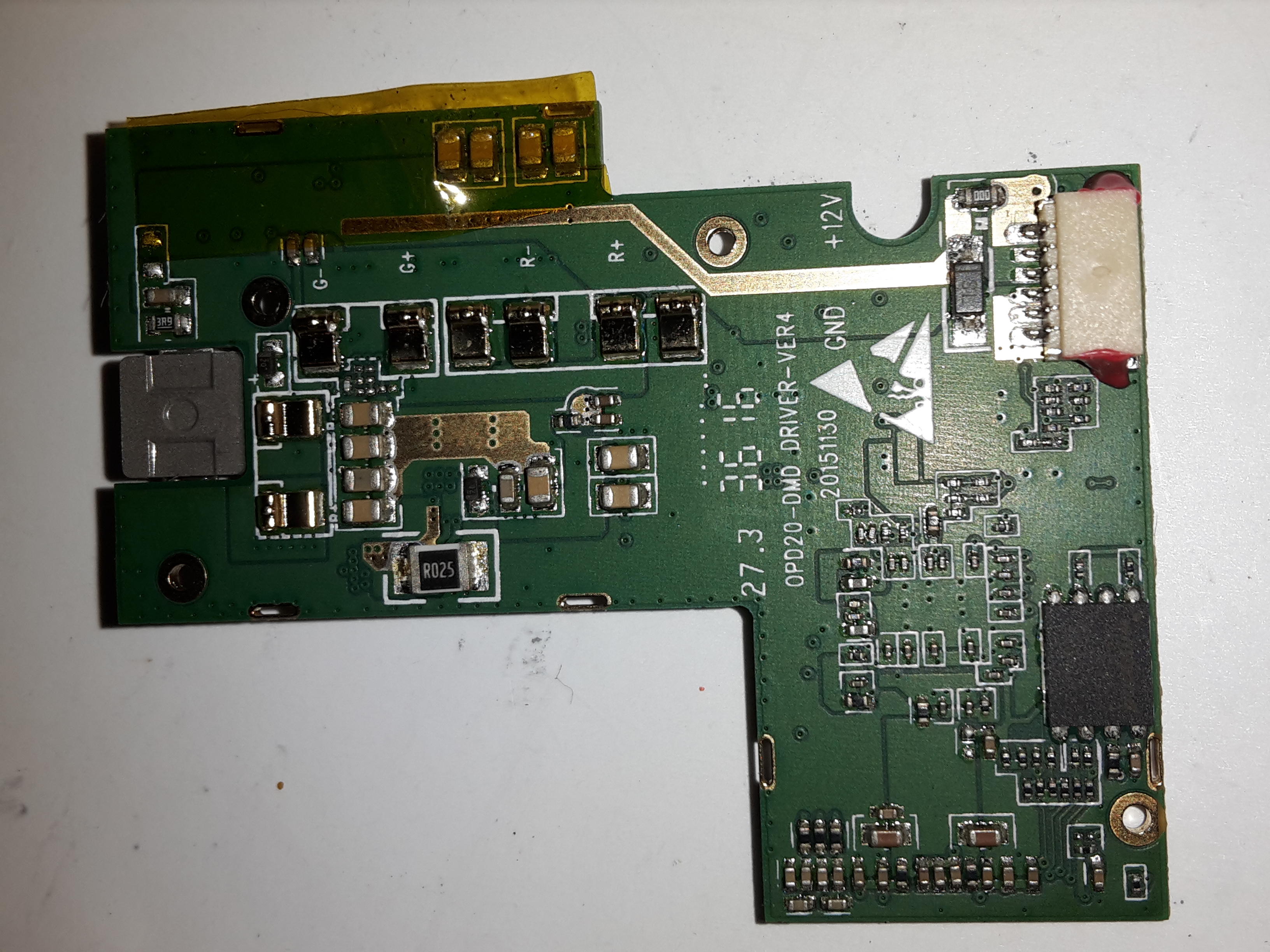

    i have removed the dmd driver board from said optical engine (please see attached pic) it seems the optical engine is made by ongine, the symptoms are about a more than 50% drop in light output, with a pink/purple hue to the entire image, i am trying to figure out if this is due to a failed led or the driver board, from what i can see the green led is an osram ostar q8 led, which from the data sheet i have found should be emitting at 520nm but the light i see from the led is not green and more between 550 and 600nm, also this led is running hotter than the other blue and red leds, before this fault occured, the projector would be slightly dimmer at start up and have the slight pink/hue as said but after about 30mins operation it would be at full brightness with no color hue, i would expect a failing led chip to go worse as the unit warms up not improve
    can you confirm if it is yourselves who produced the dmd driver board in the pic or if it is ongine i need to speak to, and do you have any idea regarding this fault, would it be due to a failed driver board or more likely the led chip
    the driver board contains led driver chip 'DLPA30000'
    and dlp chip 'DLPC3438'
    with a 'DLPS051' dmd chip
  • Hi Michael,
    Thanks for identifying the chipset. However, this doesn't seem to be an issue with the DLP chipset, more likely a failed LED. Moreover, TI doesn't design or produce the driver board either, please contact the manufacturer directly for electrical issues with the board.

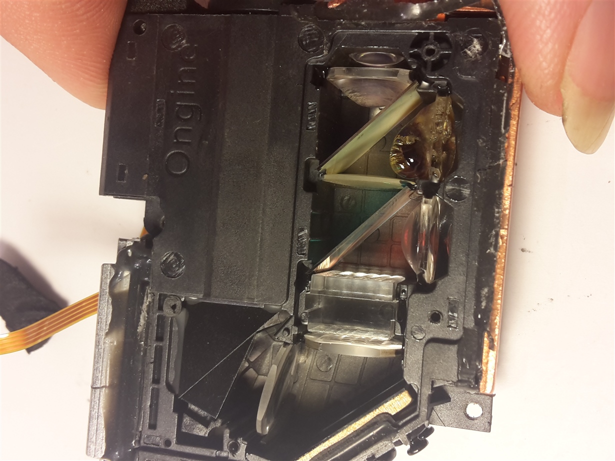

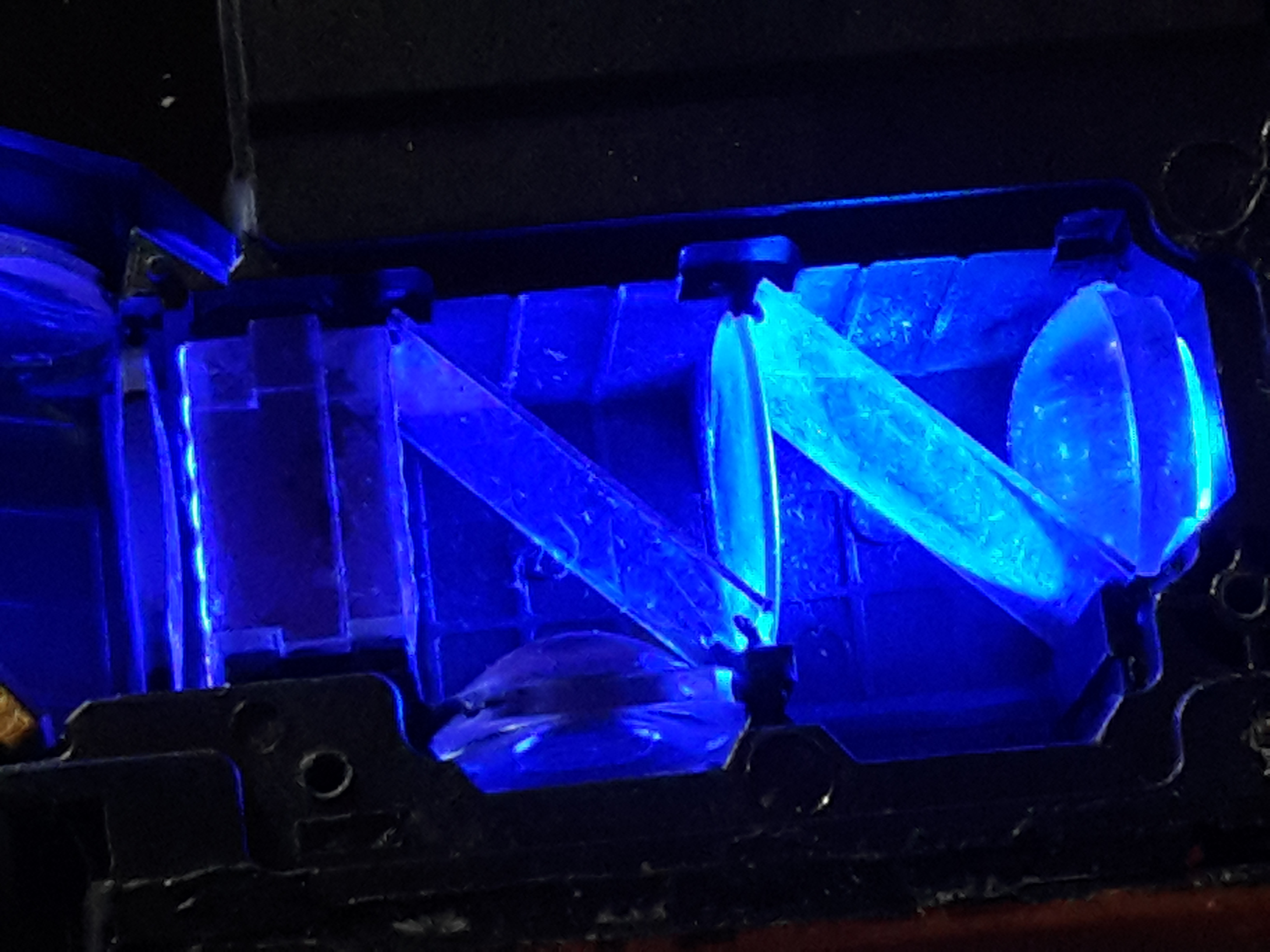

  • hi
    problem discovered,
    the collimator lens for the green led has melted on the inside, this explains how i felt the green led running hotter than the other two, question is how has this happened, could it have been due to contanimants on the lens absorbing heat or something else, anyway it has not damaged anything else i will see if i can source a lens
    i will attach a pic as soon as i can
    thanks for the help

  • hi
    picture attached as promised, as you can see the collimator lens for the green led is completley burnt up, and has deposited particles on the dichroic mirrors, also you can see the lens for the blue led at the top has crazing on it, and on inspection a dark spot..so clearly this was going the same way too, i dont know if there was crazing on these lens from manufacture or there is uv light that causes this?(any ideas) at the bottom the lens for the red led is perfect
    i have managed to clean the dichroics(the best i can) now i just need to source new lenses, i have had no luck from the manufacturer regarding giving me info on these, if anyone has any ideas as to what the focal length may be for these that would be great
    lenses are 9mm dia, 2.5mm thick, edge thickness 1mm.

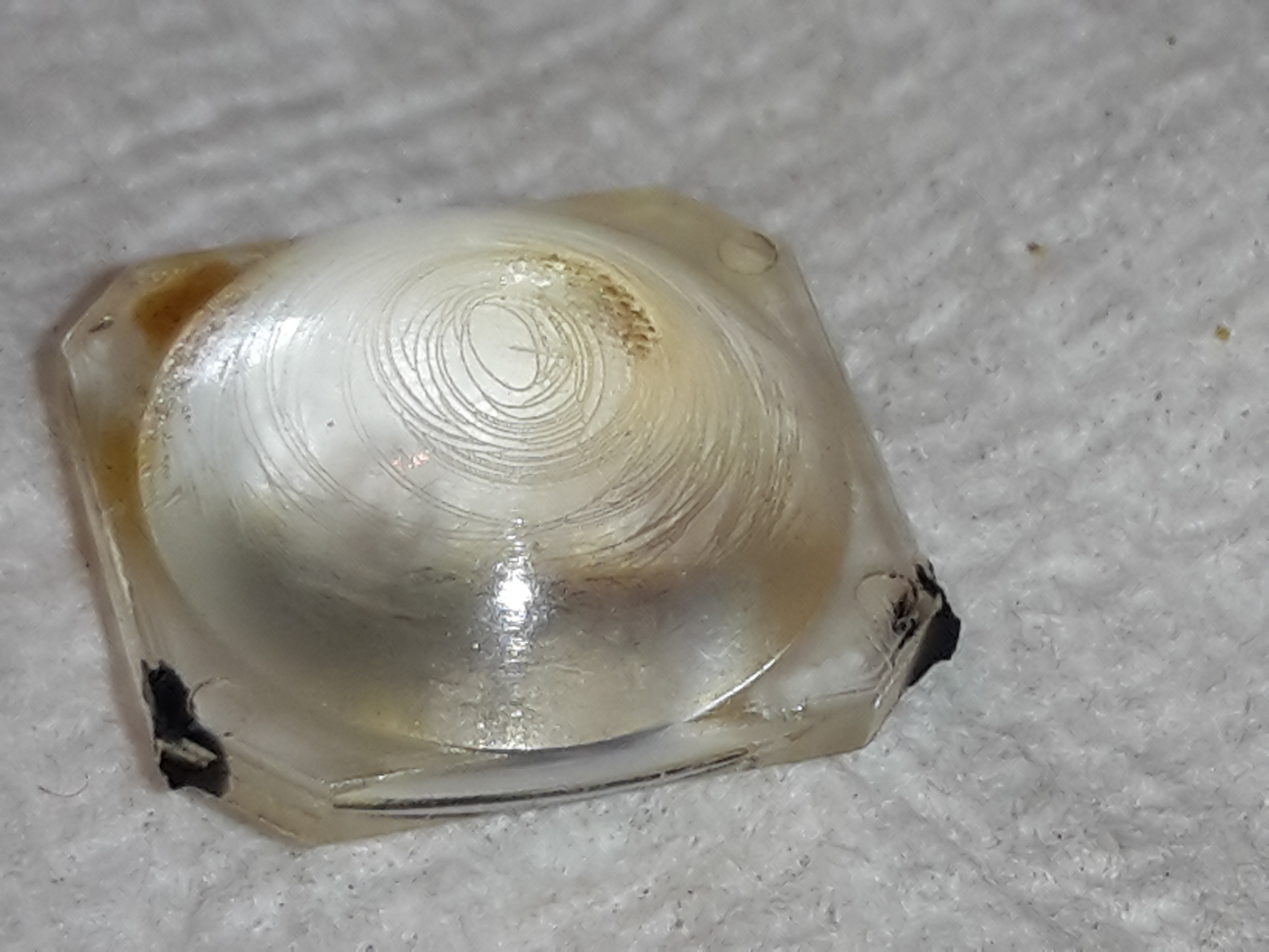

  • hi
    above is the blue lens i have removed, as mentioned it was the lens for the green led that had melted, but as you can see this lens has also started, i assume due to the abrasions on the surface causing it to absorb heat, i think the abrasions have been caused during manufacture...

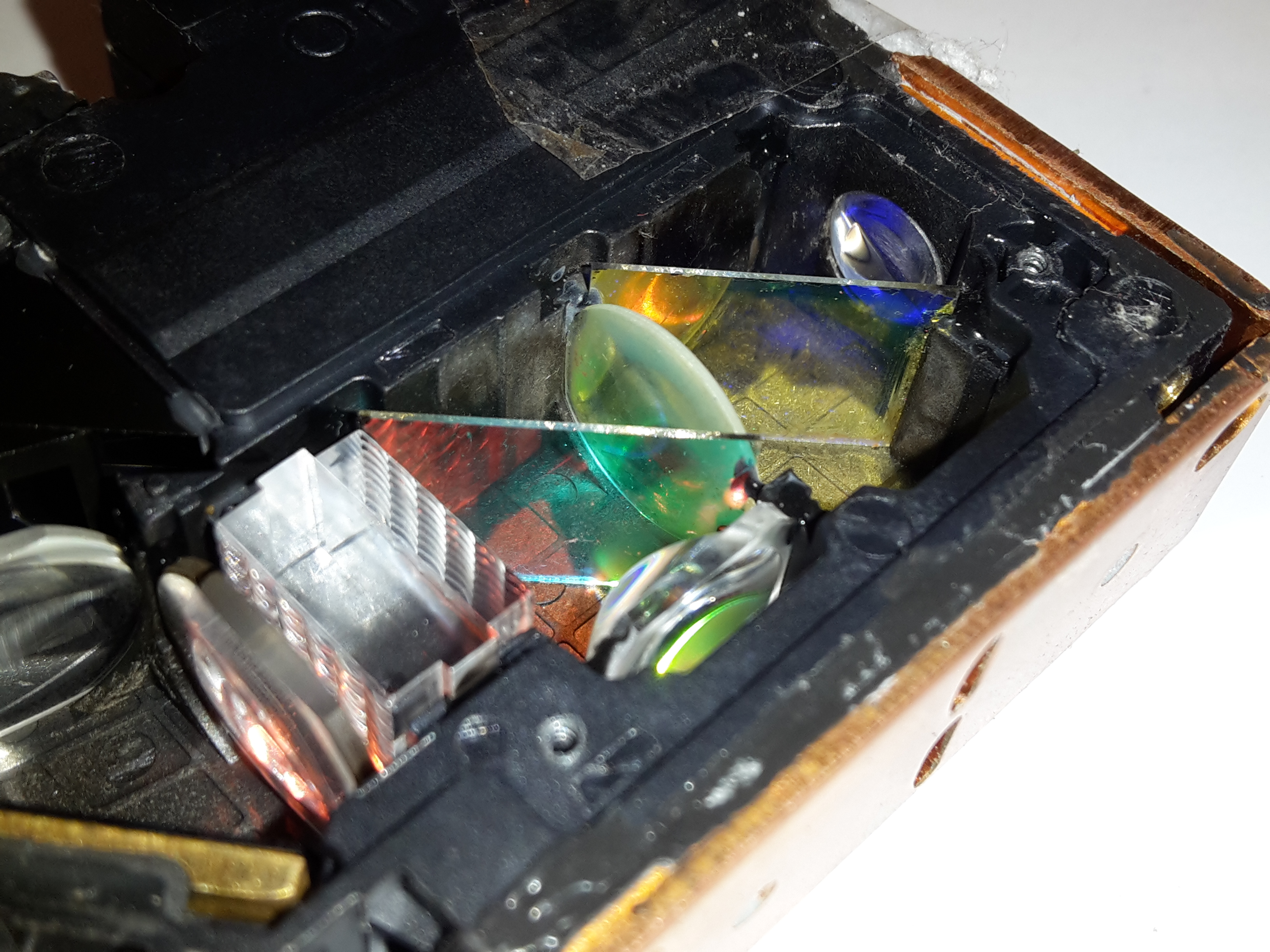

  • optics cleaned, the pic shows some dirt still on the centre lens between the mirrors, ive cleaned since taking this pic, thankfully the mirrors were not damaged by the burning lens

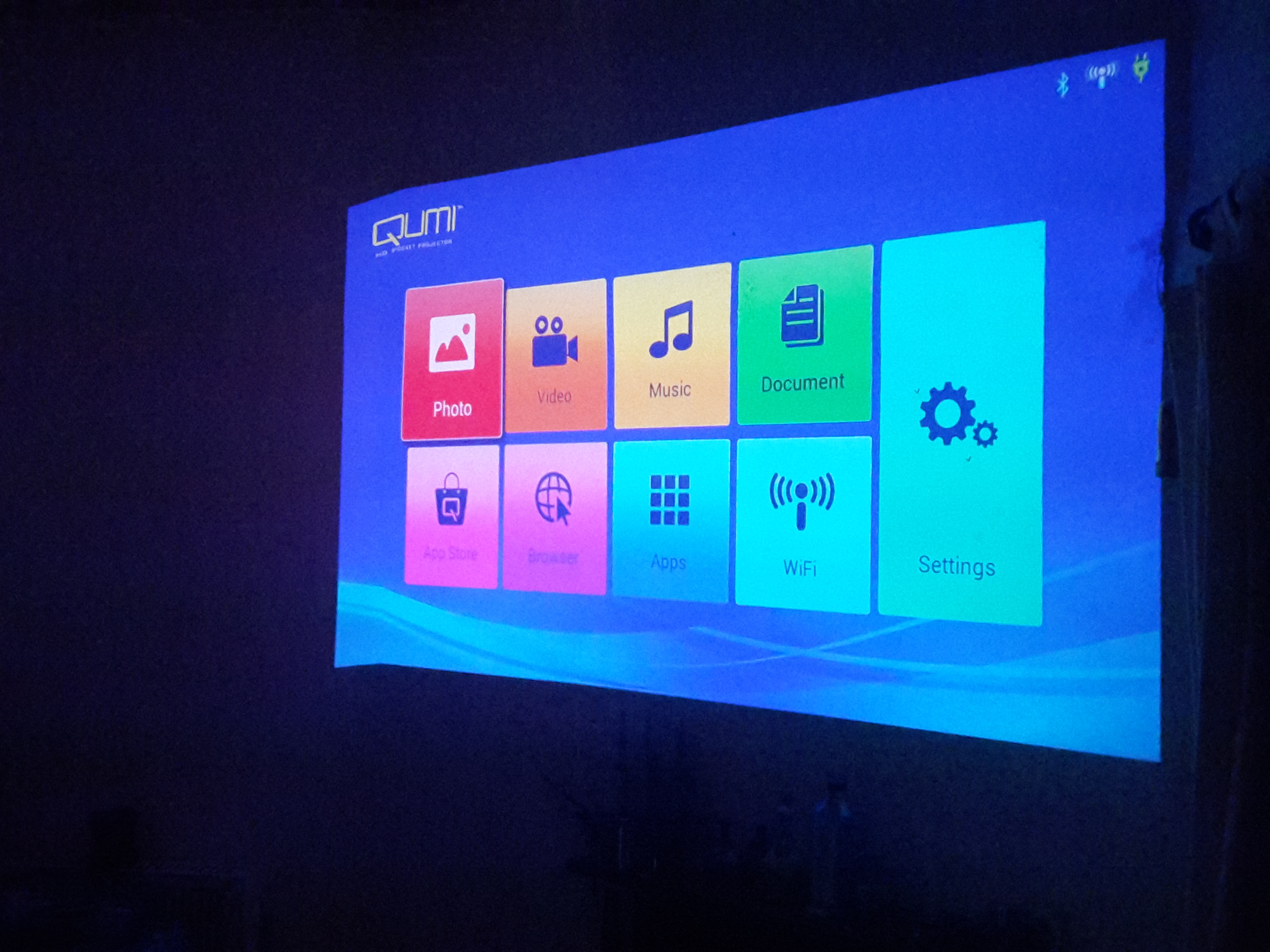

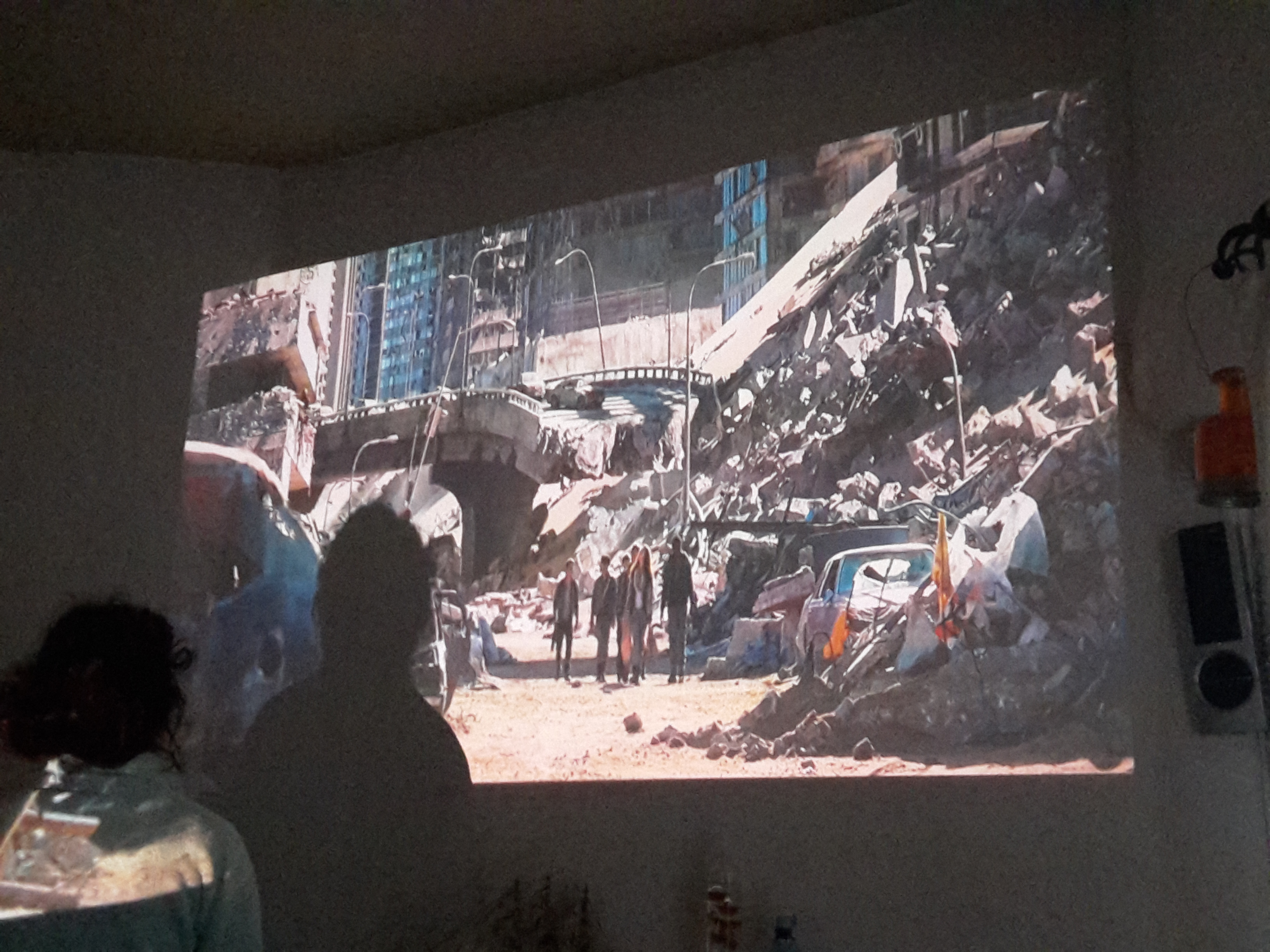

  • Final pics, unit has been put back together, fitted two new collimator lenses, had to shape slightly at the edges in order to fit into the mounting slots within the optical engine,
    above are the test pics, approx a 100" screen, in a darkened room with some daylight coming through blinds. person stood there to give size comparison, overall brightness is good, color is good, and no artifacts are showing on the image, unfortunatly i did not take a picture of the image when the unit was faulty, but as said, it was easily less than 25% of the brightness you see in the picture, as well as having a pink/purple hue over the image
    overall pleased with the results
    thanks for your input, in the questions i asked, deep down i suspected the optics if i think about it

    i have some pics i took when testing the blue led with the new lens fitted and the optical unit open to see where the light was collimating, i will attach these pics soon as i get them on the pc
  • pic showing the new lens for the blue led fitted in the top right hand corner befoe tacking in place with glue, the mirror was cleaned better since this photo was taken as there are quite a few smudges on there,
    if you look at the edges of the lens in the pic, you can see i had to cut slots away in order to fit the lens, though these lenses are the exact diameter of the old, the lens for the blue led would have contacted the dichroic mirror on the bottom edge (as seen in pic orientation) if i had not cut it away in order to recess it slightly, this was caused by it not being aspherical in shape, if it had of been it would have not contacted the mirror,
    lens for green led fitted fine (not shown in this pic), only put a slight edge on the side of the lens in order to slot within the cut outs for the lenses in the optical unit , removed .5mm of depth on either side of the lens
