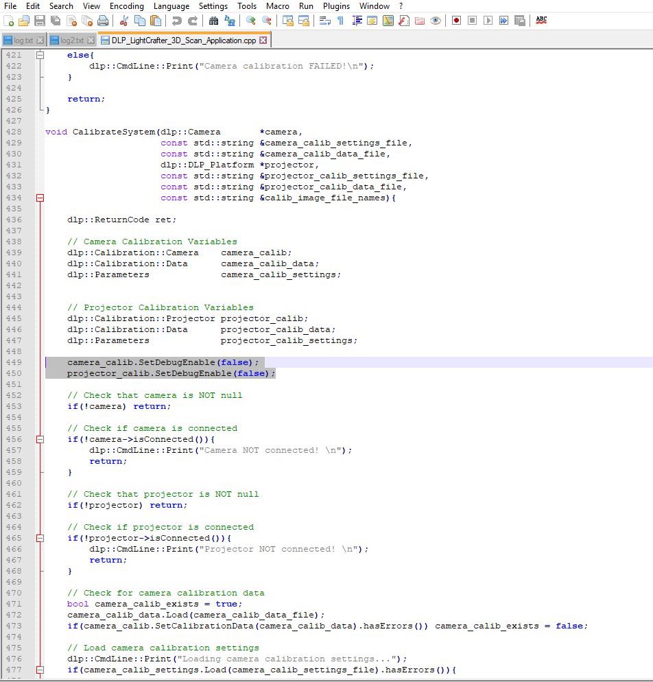

    Extremely sorry, couldn't update. Your suggestion didn't help me. But I could solve the problem by debugging the available source code. The following function
    projector_calib.RemovePrinted_AddProjectedBoard(camera_printed_board,projector_black,projector_camera_combo,&projector_pattern,&success);
    I saved the images that are input to above function. Realized they weren't proper - maybe due to some delay with webcam while using it at 1280x720 resolution. Added delay and made sure that appropriate images are captured i.e white projection. no projection and combo projection images. And also verified, by saving the output image, which removes the projected from combo for further projector calibration. Whenever opencv's findchessboardcorners function doesn't find corners, it gives error. This implies now the code is fine , I just need to make sure to capture well focused images so that it can find corners.
    So far this is what I have debugged. Since there is no trigger_in  and webcam's default resolution is 640x480, I am facing problem and adding some delay with trial &error , could just make it work.
    Conclusion: Change Camera (as it is a fixed focus webcam with default resolution 640x480).  When new camera arrives, I shall try and let you know.
