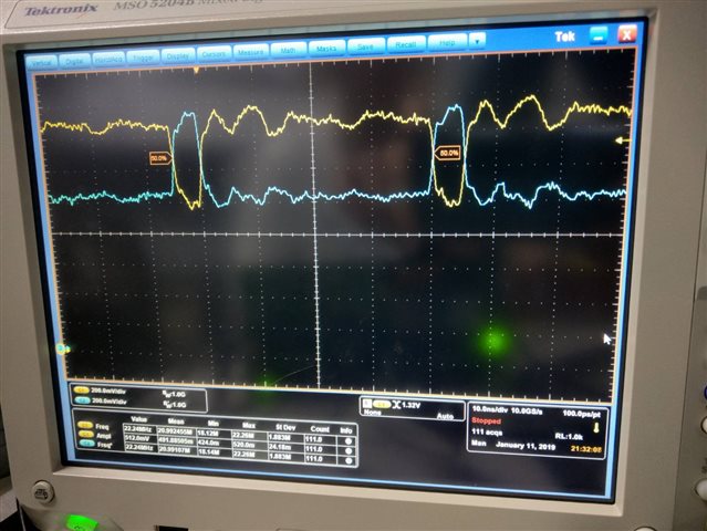

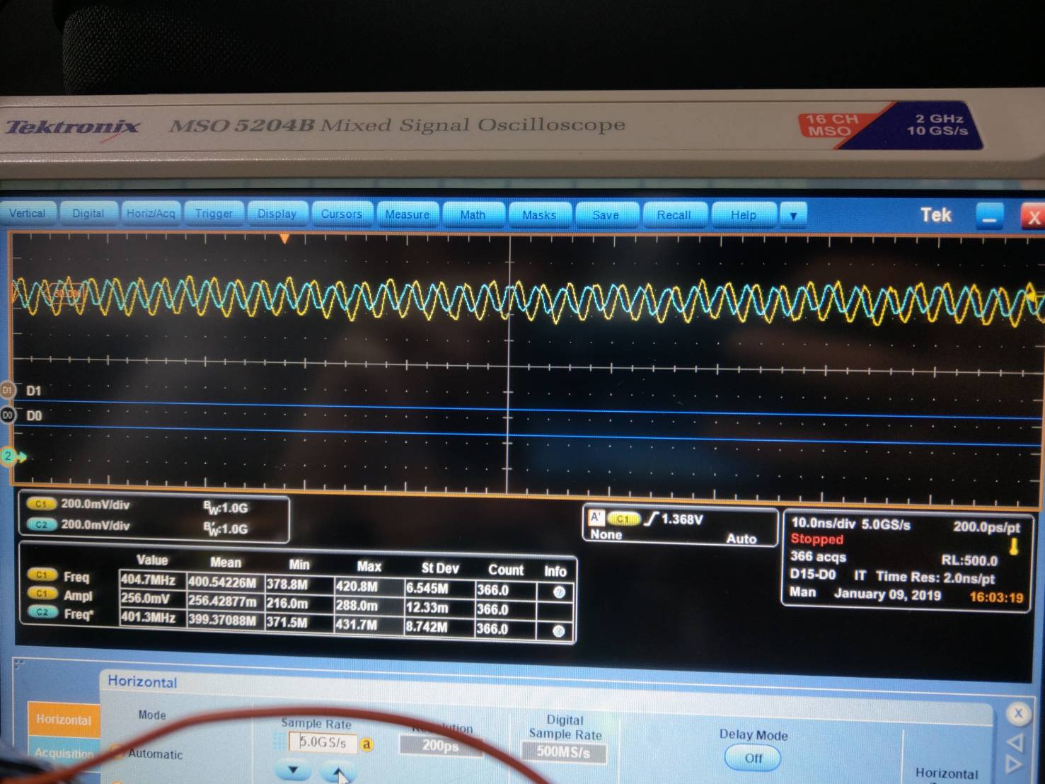

    When the PLL and LVSD modules are ready, the DCLK will always be provided. And after the initialization, our DVALID is constantly logic high (we checked the LVDS output using oscilloscope).
    This is our DCLK measurement, is this a valid one?

  • Hi Justin,
    DCLK scopeshot you attached is it differential signal ?

    "DCLK scopeshot you attached is it differential signal ?"
    We found that the LVDS clock gets well after we inserted a GBUF for the reset pin of the LVDS module. This is our DCLK signal now.

  • Hi Justin,
    Clock certainly look better now. For now keep delay to 32 clocks. Please check skew requirements of Skew, BLK_MD, BLK_AD, ROWMD or ROWAD to DCLKIN in section 8.5.
