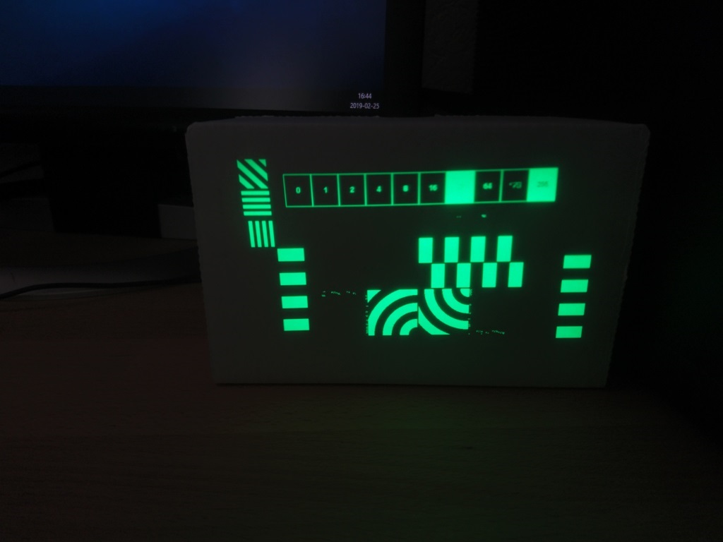

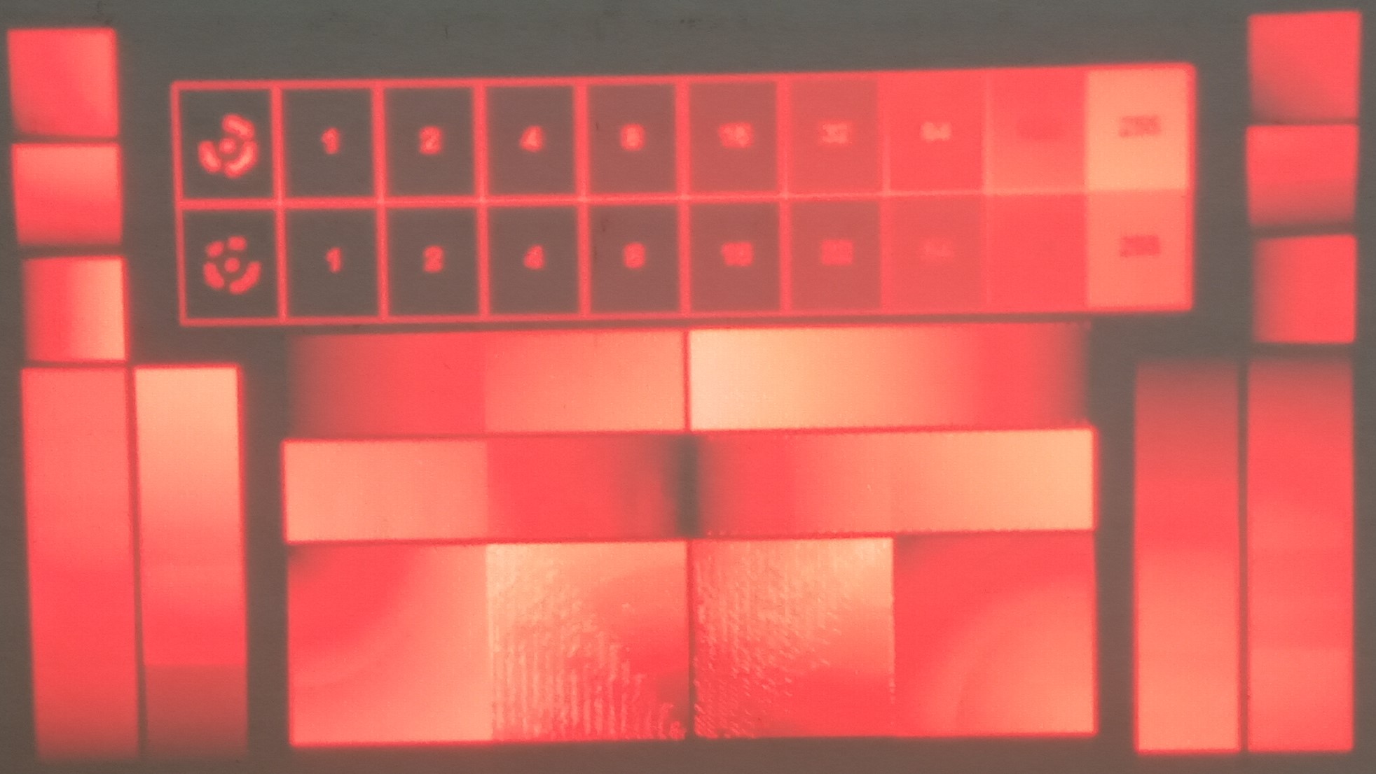

Image artifact issue
One of the major issues I found with this mode is that there are some processing artifacts impacting some of the image bit planes.

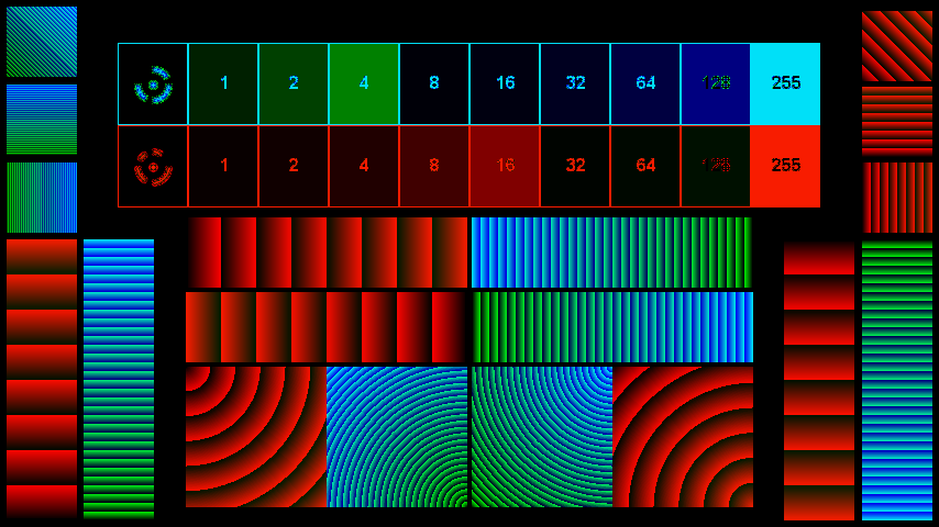

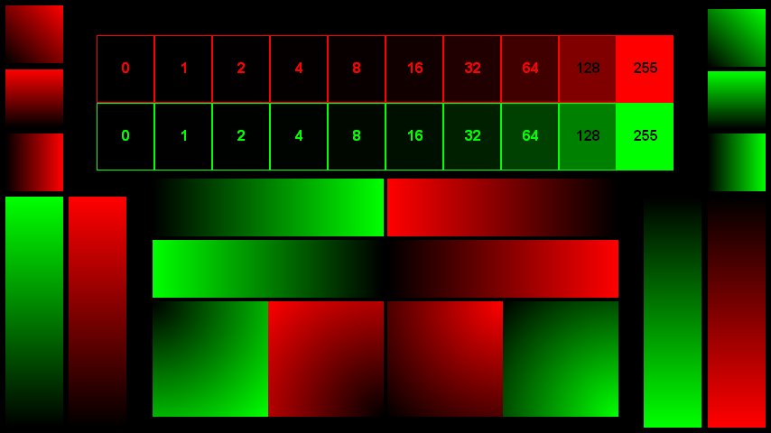

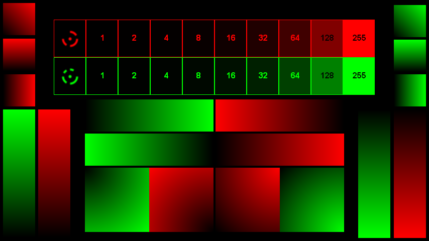

I am using the following test card, in which the green channel is mapped to the upper byte of a splash screen data word and the red channel is mapped to the lower byte.
As you may see from the projected splash patterns (8-bit mode, 1 pattern), in addition to the artifacts, there is a 3-bit shift between the expected bit location and what the DLPC347x chipset interprets. This may however easily be fixed when generating the splash image data, but the documentation does not state which bits from the image are used in which bitplane when projecting in 8-bit splash pattern mode.

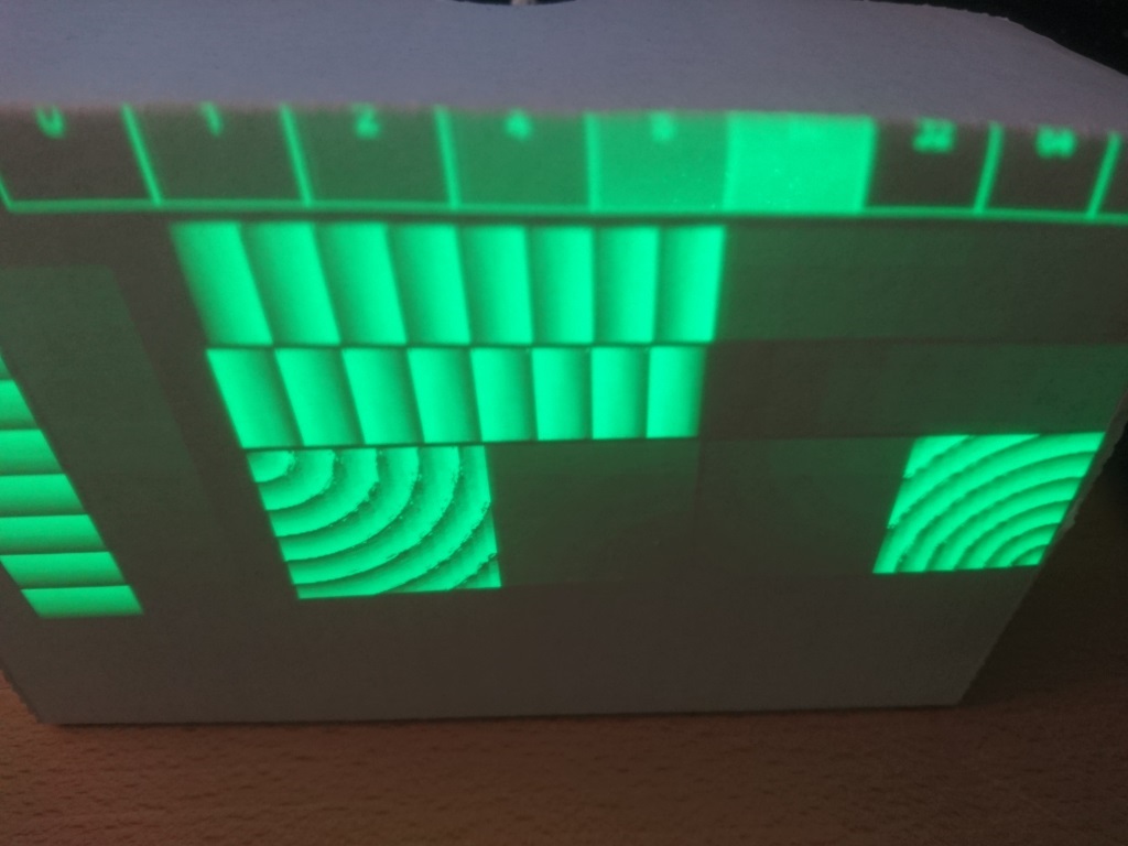

The image processing artifacts are especially visible when projecting a single bitplane (1-bit mode, 1 pattern):
When using the 8-bit mode and projecting 2 patterns (not photographed here), the red source image patterns are projected correctly, while the green source image patterns are distorted.

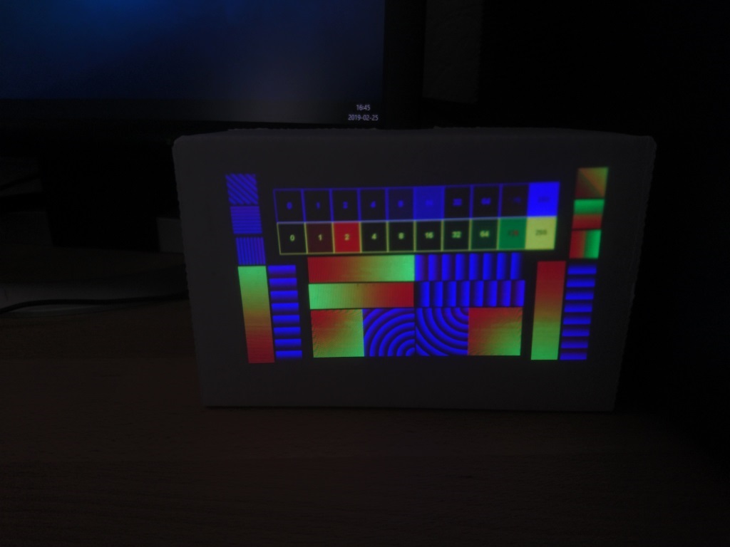

Also, there is no such issue when projecting in standard Splash Screen Mode:
To me, it seems that even though the image processing algorithms (LABB, CAIC) are disabled, some processing is still taking place and producing artifacts on the projected image. If I enable LABB processing, the artifacts become much worse but still only affect the green source patterns (and not the red ones !), even with all sliders maxed out.
What are the possible workarounds for this problem ? Right now I only need to project static 8-bit 2D patterns, so I could live with only using the "red" channel from my images - unfortunately the only way to display that would be to use the 8-bit mode with 2 patterns with a blanked out "green" channel, but this induces heavy flicker !

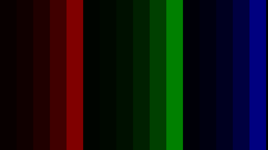

    For a better understanding of how splash pattern mode works, I'd suggest you to try projecting this image on the DLP2010EVM-LC:
    This image consists of 16 stripes, 5 corresponding to the MSbits of red and blue and 6 corresponding to MSbits of green. If stored in RGB format and projected in 8-bit splash pattern mode, the images displayed would look like two 8-step horizontal ramps placed side by side.

  • Dear Azad,
    Thank your for your answer. Using your test pattern I indeed obtain one, or two 8-step horizontal ramps depending on the number of patterns I specify in the interface.
    However, this does not solve my issue, which is the appearance of artefacts in the splash pattern mode.
    More specifically, it seems that these artefacts appear if you have high frequency content on some bits, e.g. the RGB565 green MSbit.

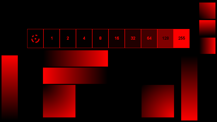

    I corrected my image conversion function so that the "green" and "red" channels of my source image are mapped respectively to the first and second 8-bit patterns in splash pattern mode, taking the bit shift into account.
    Source image
    Image converted to RGB565, shown as 24-bit format (this is what the projector shows in standard splash mode) :
    On my EVM, projecting this image in 8-bit, 1 pattern mode results in a lot of artefacts on the red-colored zones from the source image, which should remain black
    Could you try this image (the directly above RGB565 image) in splash pattern mode on one of your evaluation modules ?

  • Hi Guillaume,
    Here is what I got testing the RGB565 image you provided:
    Splash Image:
    Splash pattern (8-bit, 1 pattern):
    Splash pattern (8-bit, 2 patterns) [Note this is a composite image of 2 patterns]:
    Is this what you expected?
    Azad
  • Hi Azad,
    Thanks a lot for trying the splash image on your own hardware.
    The results you posted are exactly the same as what I observe here. They exhibit artifacts which are not in the original red and green image (which I have shown in my original posting)
    For reference, this is how the test card should look when projected
    Splash pattern, 8-bit, 1 pattern :
    Splash pattern, 8-bit, 2 patterns :
    Guillaume STRUB
  • Hi Guillaume,
    I suspect this to be an artifact arising due to an image processing limitation of the DLPC347x controller. I'm working on confirming this with my colleagues.
    If this is indeed the case then the workaround would be to use source images with lesser high frequency pixel data. I'll get back to you with more information after confirming the details.

  • Dear Azad,
    Thank you for your feedback regarding this issue.
    From my testing it appears that at some point the splash screen is processed as RGB565 even though in splash pattern mode it is displayed as two 8-bit images.
    Indeed, it seems that the artifacts appear when pattern data spans the R and G channels or the B and G channels ; one workaround is to limit the bit depth of the splash screen image to 3 bits (pattern MSBs on the lower 3 green bits) on the first pattern and 5 bits (blue channel only) on the second pattern.
    Maybe one could use the full 5 red bits (which correspond to the 1st pattern's LSBs) by changing the sequences used for splash pattern projection, if 8-bit projection is truly not possible ?
    Guillaume STRUB

  • Hi Azad,
    The red-green image I used as my "reference" image is actually never sent as-is to the projector or into the DLP GUI ; it is just a convenient way to show the two separate patterns I intend to show on the projector.
    I use a Python script to convert it into a RGB565 image for updating the projector Flash ; actually I tried both using the DLP GUI and building the Splash section using Python scripts (which gives me better control over the channel mapping), but with exactly the same results wrt the artifact issue. The mapping is as follows :
    Patterns A and B A7 A6 A5 A4 A3 A2 A1 A0 B7 B6 B5 B4 B3 B2 B1 B0
    RGB 565 image G2 G1 G0 R4 R3 R2 R1 R0 B4 B3 B2 B1 B0 G5 G4 G3
    As I observed previously, artifacts can appear if a pattern uses more than one channel in the resulting RGB565 image :
    • The first pattern uses the 3 lower green bits, and the whole red channel.
    • The second pattern uses the whole blue channel, and the 3 upper green bits.
    The artifacts seem to appear when the most significant bit of the "lower" channel (i.e. R4 for the 1st pattern and G5 for the 2nd pattern) changes rapidly (e.g. in gradients).
    One workaround is to only use the "most significant channel", that is, the 3 lower green bits on the first pattern and the blue channel for the second pattern.
    Then the resulting image is free of artifacts :
    Patterns A and B A7 A6 A5 B7 B6 B5 B4 B3
    This, however, limits the bit depth one can use in the splash pattern mode.
    If the image processing issue causing these artifacts cannot be resolved, would it be possible to change the splash pattern DLP sequence in one of the following ways ?
    • Two 5-bit patterns, using only the red channel and the blue channel of the RGB565 image:
      Patterns A and B A4 A3 A2 A1 A0 B4 B3 B2 B1 B0
      or
    • Three patterns, using each channel of the RGB565 image ; i.e. one 6-bit pattern and two 5-bit patterns:
      Patterns A,B and C A2 A1 A0 B4 B3 B2 B1 B0 C4 C3 C2 C1 C0 A5 A4 A3
    Guillaume Strub
