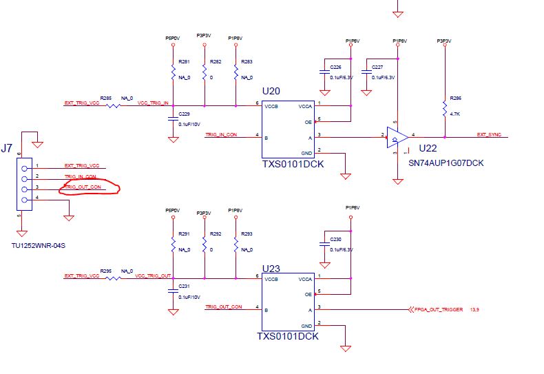

Hey everyone,
I am trying to feed an external pattern into my DLP3000 board and have it trigger the camera trigger on each bit plane.
I have done the hardware modifications (adding 0 ohm resistor to R295). In the windows GUI I can get the camera trigger working with HDMI and I see the signal when I probe the correct pins.
However, for my application I want to use the C API. Currently, my code is roughly doing this:
if(LCR_CMD_Open()) { printf("Unable to connect to the DLP LCr\n"); } printf("Displaying HDMI"); LCR_CMD_SetDisplayMode((LCR_DisplayMode_t)(0x02)); // Set trigger output settings LCR_CamTriggerSetting_t triggerSettings; triggerSettings.Enable = 1; triggerSettings.Source = 0; triggerSettings.Polarity = TRIGGER_EDGE_POS; triggerSettings.Delay = 0; triggerSettings.PulseWidth = 200; //us LCR_CMD_SetCamTriggerSetting(&triggerSettings); //Get trigger setttings LCR_CamTriggerSetting_t triggerSettings; LCR_CMD_GetCamTriggerSetting(&triggerSettings); printf("Enable %u \n",triggerSettings.Enable); printf("Source %u \n",triggerSettings.Source); printf("Delay %u \n",triggerSettings.Delay); printf("Polarity %u \n",triggerSettings.Polarity); printf("PulseWidth %u \n",triggerSettings.PulseWidth)

If I probe the correct pin I can't see the camera trigger.
I was hoping someone could give me advice on what to do.

  • Alex,
    Just to make sure we understand your setup -
    You mentioned about external streaming , so i presume the pixel data is sent over mini-HDMI connector, is it the case?
    Now in external streaming mode, to get the syncs out on J7 Pin3 - make sure you are configuring the LightCrafter EVM properly? Use GUI to experiment first, enable trigger out,
    http://www.ti.com/lit/ug/dlpu004b/dlpu004b.pdf
    Section 2.3.1.1.2.4 8-bit Monochrome External Video onward you will see various configurations, in streaming, once trigger out is enabled, you must see the signal depending upon the selected bit-depth.
    If you are not seeing then there is some-other hardware issue we need to look at, since you mentioned about probing, did you look on o-scope?
    The other option is to install R295 and then select voltage via R281 or R282 or R283 resistors then you can use J7 Pin 1 also to interface with the microcontroller.
