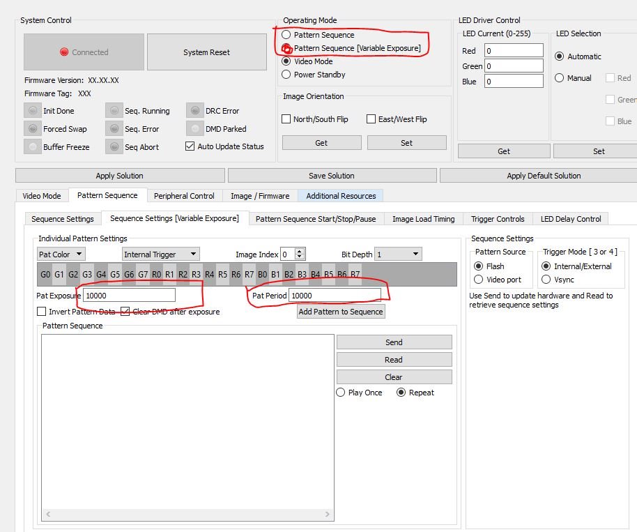

  • Hi Emilie,
    For projector speed, depending on the pattern sequence mode - Pattern Sequence or Pattern Sequence [ variable exposure]
    You can look at these parameters, the projector speed will be accordingly.

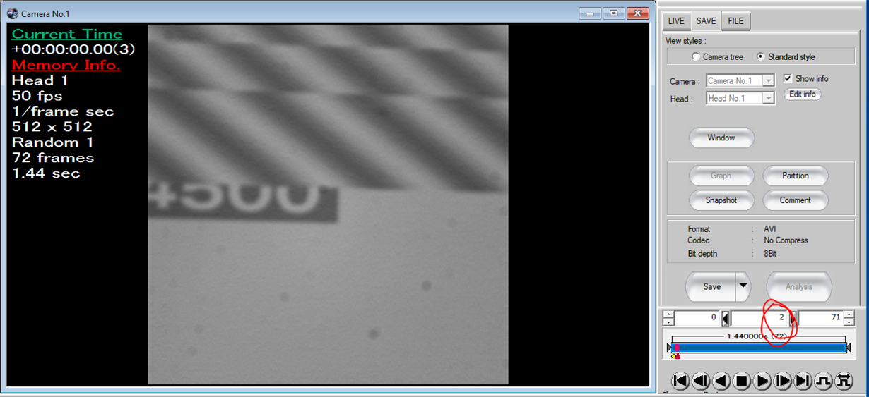

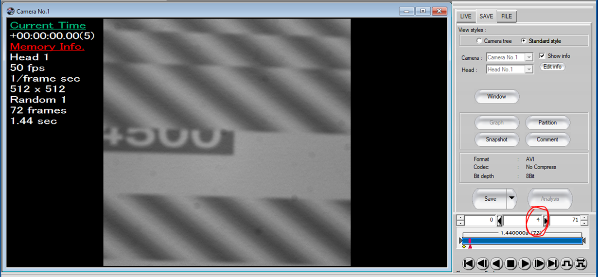

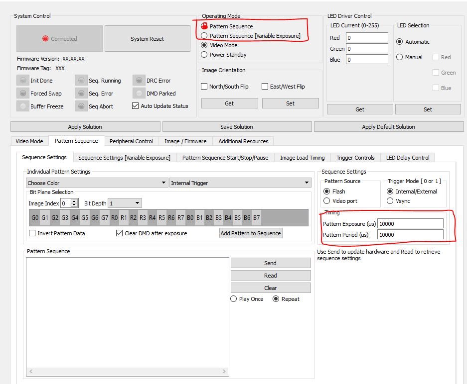

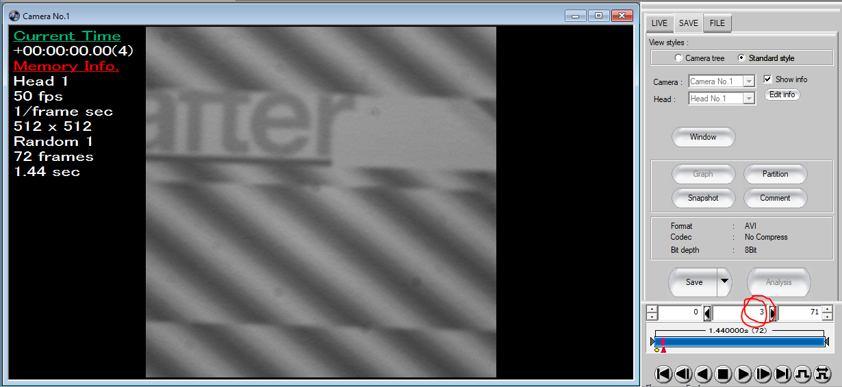

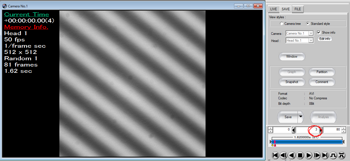

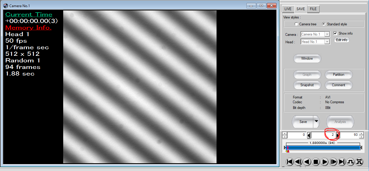

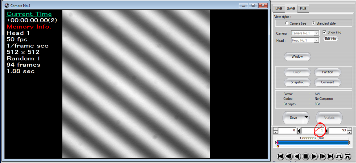

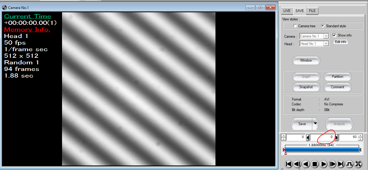

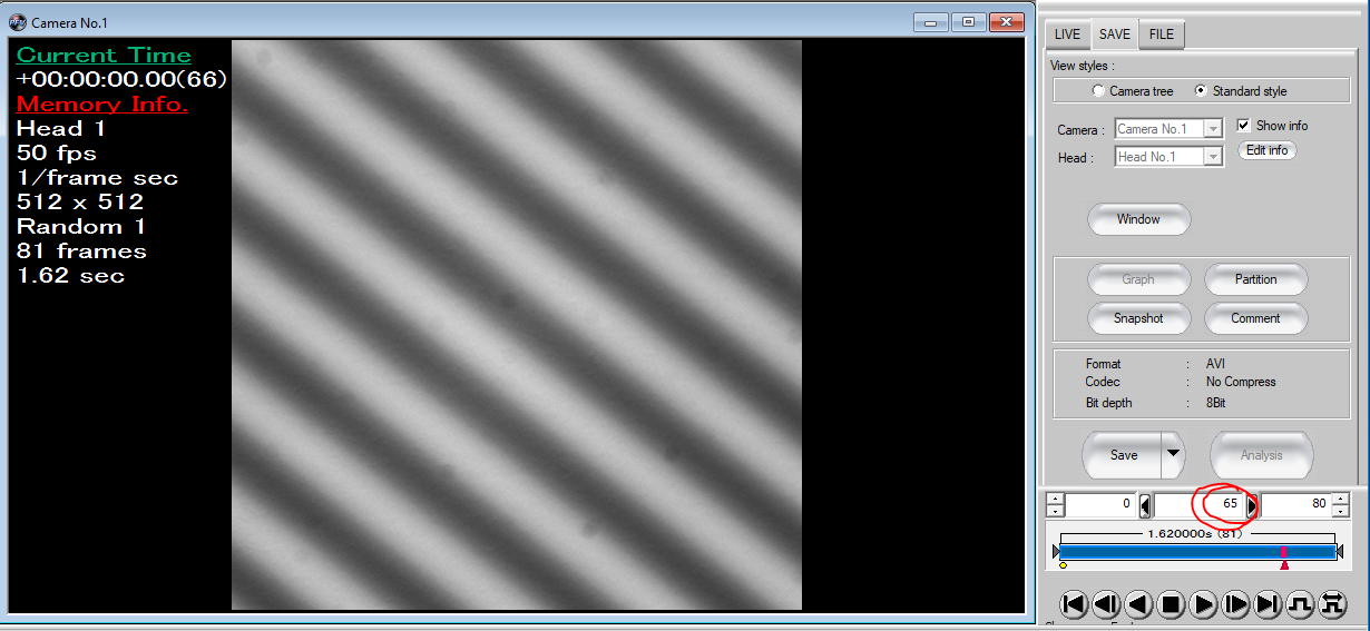

  • Dear Sanjeev,
    I have the same settings as you in the gui...
    So here is samples of what I get using minimum rate i can have: 50fps. I do not try to image at 2Hz I obviously cannot and this is why I want to be able to reach at least 50fps... But at least from the eye and phone camera point of view,it seems that around this frequency the lines are not visible anymore. So the 50fps synchronized camera also sees the some wierd lines...And Interestingly when I only use 2 patterns alternatively (but I need to use more) the lines do not appear and I can verfy that my synchronization works correctly. ( but as proposed I am  also working on finding a way to connect them directly for the triggering but according to the pictures the synchronization seem to work)
    Here are camera view examples taken with the exact same settings:
    When using only 1 pattern (50fps / 20ms) everything works fine....
    When using 2 patterns (50fps / 20ms) everything works fine also...
    But then when i try to add one more patterns, then more than 2 patterns, the strange lines appear. And it is not even a periodic phenomenon.
    Thank you very much for your time, Emilie
  • Hi Emilie,
    Your LightCrafter 4500 GUI snap shot helps.
    I think i know what is happening -
    Basically this is coming from how the DLPC350 controller works when it displays image from more than two splash two splash location which you can see from the GUI
    there S6::R0-R7  S0::R0-R7 S4::R0-R7
    Please read through the FAQ section here
    https://e2e.ti.com/support/dlp/f/94/t/711671?tisearch=e2e-sitesearch&keymatch=faq%3Atrue
    Refer to this topic and threads provided further  => 2. What is the latency caused by loading patterns from the flash memory?
    As long as you limit the 8bit image display from less than two image index you would be able to display them much faster.
    For example: Keep all three 8-bit images in same image index - basically merge three 8-bit images into 1 composite RGB888 24-bit image
    then configure sequence to look like S0::R0-R7  S1::G0-G7 S0::B0-B7
    Now you should be able to go much faster.
    Sanjeev
  • Dear Sanjeev,
    Your solution did solve my problem thank you very much. I can now reach the desired rate. Thank you very much for your support. Have a nice day, Emilie
