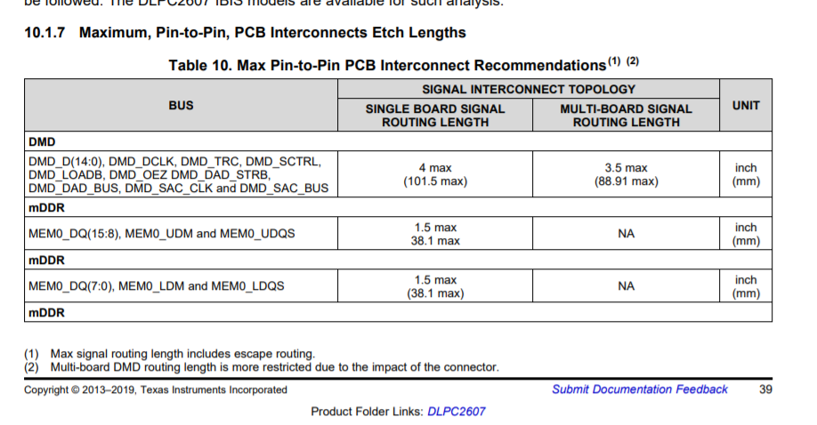

  • Hello Jinyong,
    You can see the maximum signal lengths in the DLPC2607 controller datasheet (the controller for the DLP2000 DMD). You may not be able to make the flex cable much longer than it currently is.
    Kyle
