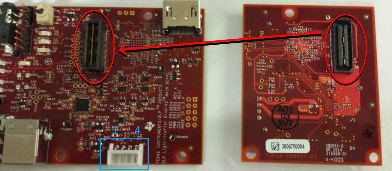

Hi Kyle,
I'm trying to communicate through i2c with the DLPDLCR2010EVM using an Arduino Uno.
How do I do this?
thanks,
Gholam

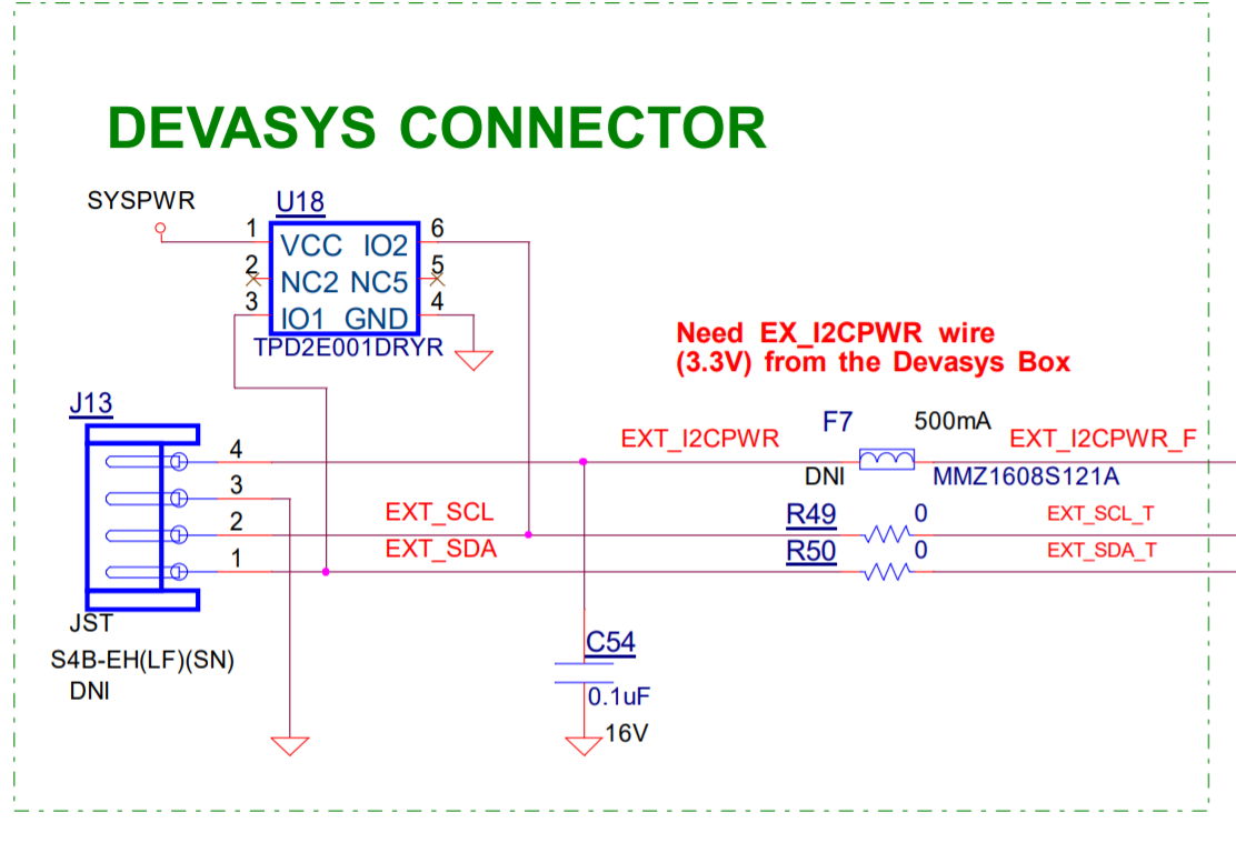

Hello Gholam,
On your picture from left to right the pins are EX_I2CPWR (3.3V), GND, EXT_SCL, and EXT_SDA.
Here is a picture of the schematic:
Note that your numbering convention is reversed from the actual numbering convention. On the right pin of your image there should be a little number 1.

Now,The status of my project is :
And this my code in arduino:
