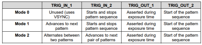

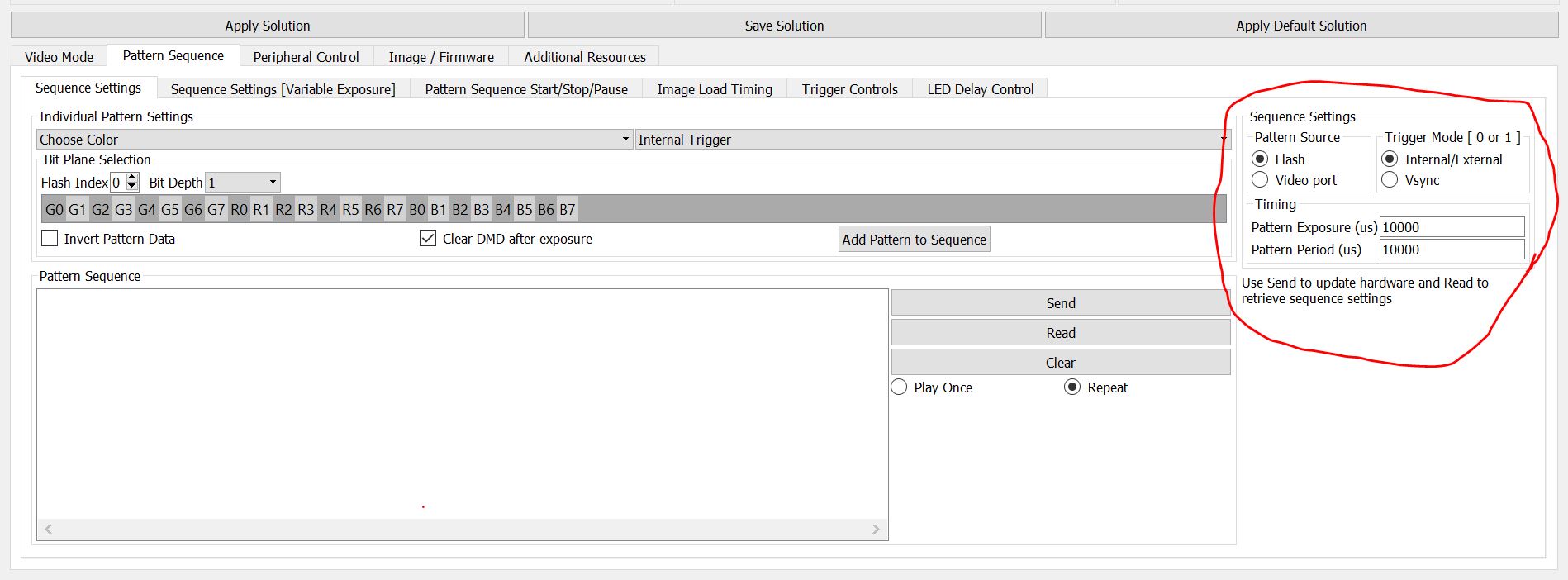

I only see reference to changing the trigger mode in the programmers guide (and even then it appears that the command needs to be sent over USB or i2c). Is there a way to do it from the GUI?
