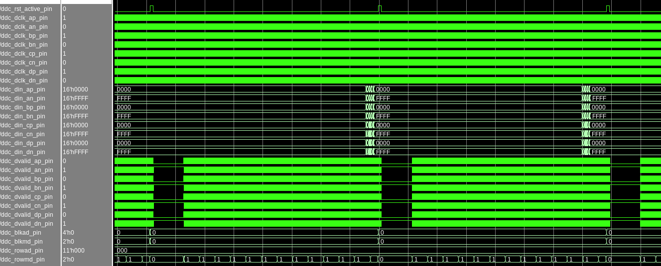

    Below waveform shows loading several images to DMD
    At the end of each "Full DMD Global Load" , We do DMD RST as shown below, I think it is global reset to reset all DMD blocks
    In below waveform, you can see the interval between two "Full DMD Global load".

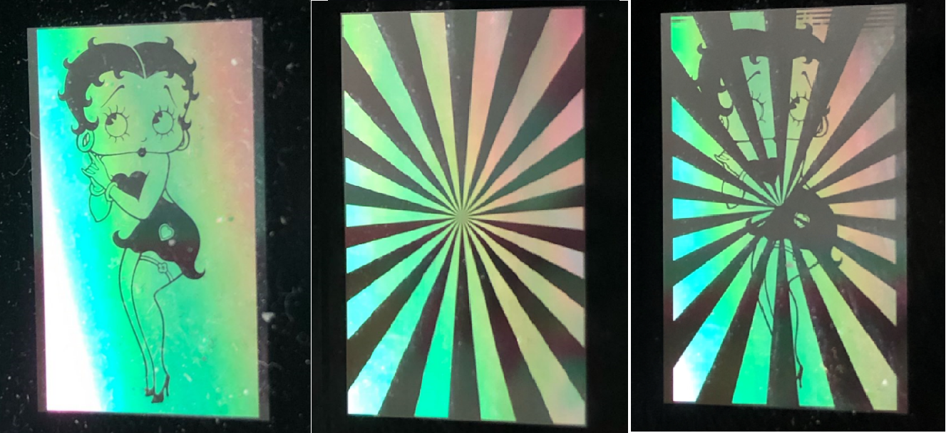

    Below is the picture of DMD showing the two images is ovelapped one over another.  Hope it can help you to understand my previous description on the current issue.
    Good focus image, Good lady image and Image-overlap
    We also observed that when image-overlap happens, there are some strip patterns on the top area of DMD (Not sure where it comes from..).
    Thank you very much for your help!
  • Hello Zan,
    Thank you for the images.  These suggest that there may be an issue between the data timing and the global reset requests.

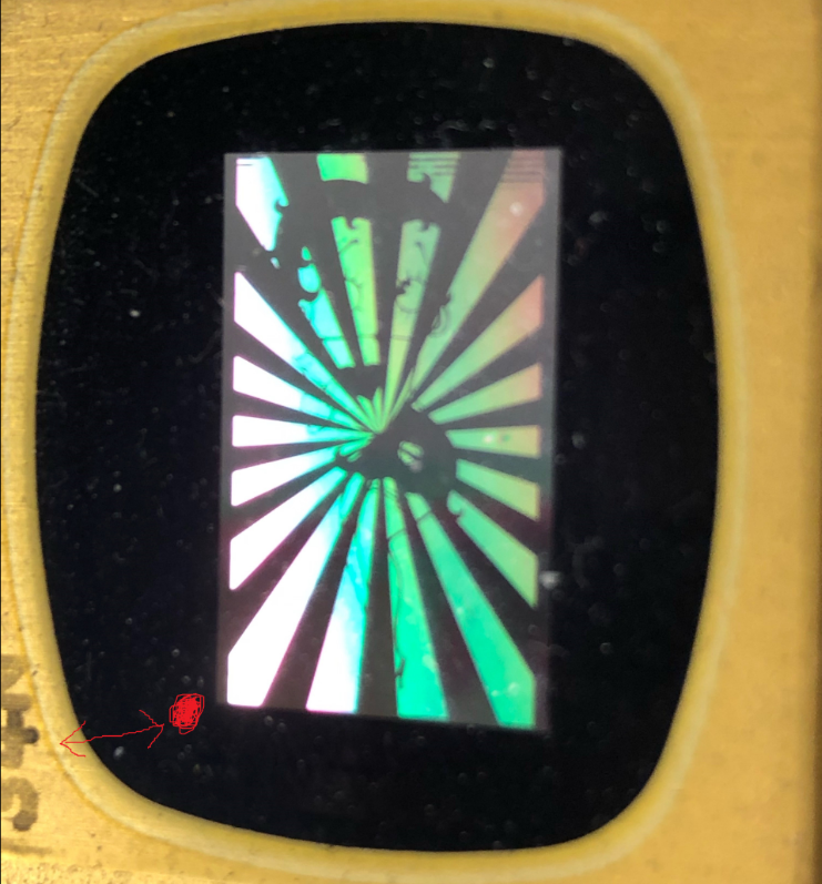

    Also can identify the corner of the images that are row 0, column 0?
    Fizix
  • Hello Fizix,
    We are using Xilinx Kintex Ultra FPGA to send data and control signals to DLPC910.
    About the row0, column0, please to see the red mark in the picture shown below.
    (my colleague told me, on the corner of DMD metal shell, the number means the row0 and col0.  and in current case, ns_flip = '0')

    There is no logic in the DMD (or the DLPC910) to "or" the current binary pattern data state in the DMD CMOS memory with another binary pattern. It loads whatever data is received on the input during a row load and loads it to the specified row in the DMD. The DMD has no "or" function. I would really point you to looking at the actual data on a data input (to the DLPC910) line during this "incorrect" image.
    It is more likely that somehow the data has been "or'ed" in the Kintex FPGA before sending the data the the DLPC910 controller.
    Fizix
