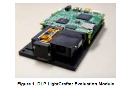

I am using a DLP® LightCrafter™ Evaluation Module with GUI "DLP LightCrafter Control Sofrware - 5.0.0"
In this manual there is an image of it: http://www.ti.com/lit/ug/dlpu006e/dlpu006e.pdf

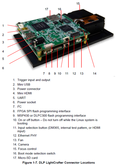

The first question I have is actually about the version of this module. When I looked at this post "Not sure which EVM you have? Read this:" (see the image below) I found none of these match my device. Maybe it is too old?

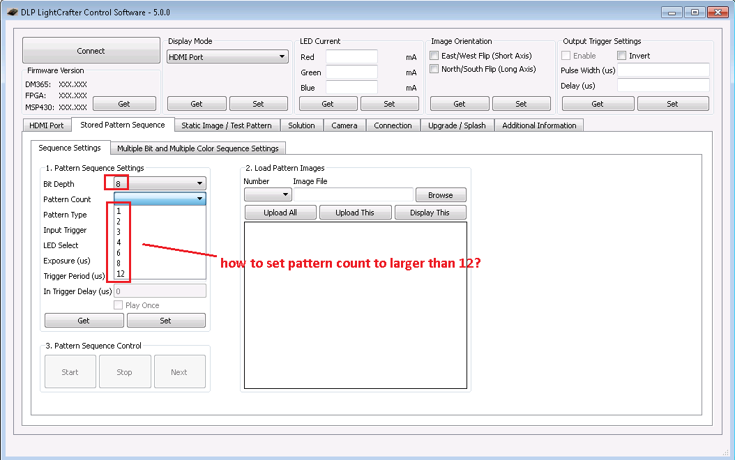

The second question is that when I used the software to upload internal 8-bit monochrome patterns, it does not allow me to enter the pattern count manually. Instead, I had to choose the pattern count from a dropdown menu which has max value of only 12. However, from the user manual it said that I could use "Extended Pattern Sequences" which should allow about 125 patterns. How can I change the pattern count to larger than 12?
Is there a newer version of the GUI? If yes where can I download it?
