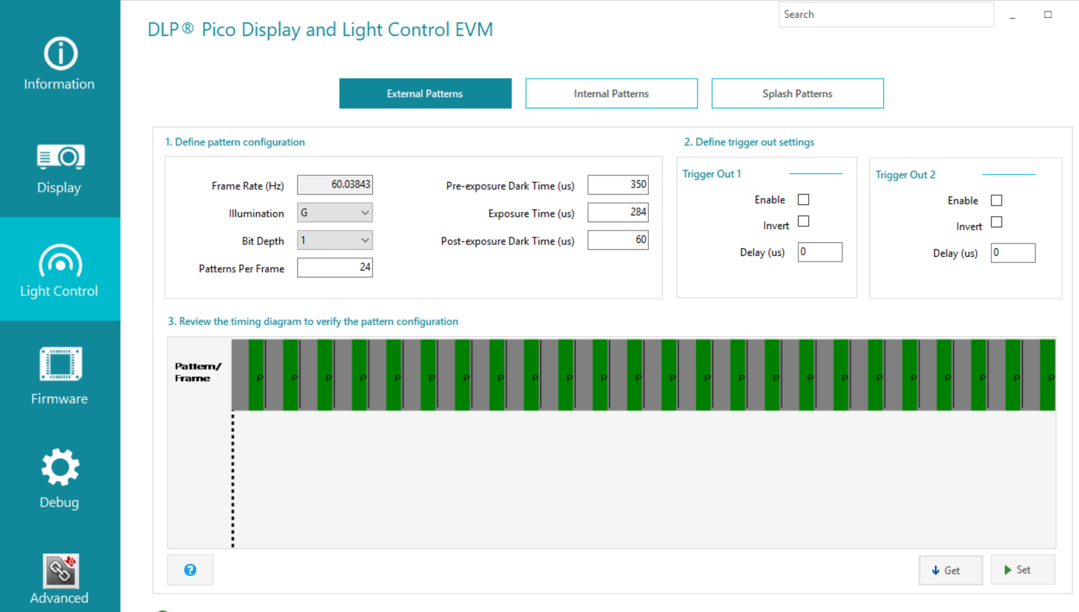

I then switched into what I was hoping would be 1-bit, 1440 mode. This is what the GUI page looks like.

    As you can see from the above image, a lot of blocks in the input image are copied over and over in the output image. Also there's a horizontal strip in the bottom half of the output image that flickers.
    I thought that if I switched into a monochrome 1-bit 1440 Hz mode, I should just get a (monochrome) copy of my input image, right?
    Can you tell me what I'm doing wrong?

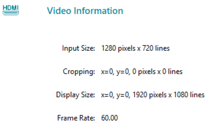

  • P.S. There's one more weird thing I noticed. When I go into Display/Video and Color, and get the video information, it shows
    Although the signal that I'm sending is 1920 x 1080 x 60 Hz (this is what my video card driver is telling me).
  • OK, I've just made some progress on my own. When I go to Display/Display Settings in the GUI, and put "Scale input image to size" to 1280 x 720, and then go to the 1440 Hz monochrome setting on the Light Control page as before, I don't get any distortion or flicker: just a green (or whatever) version of my image centered in the middle of the larger image (like a 720p image centered in a 1080p image). So I guess the trouble is that it thinks I'm sending it 720p image -- whereas I'm really sending a 1080p image.
    So how do I get it to recognize that I'm sending a 1080p image?
  • Sorry, I just realized that my video card wasn't outputing 1080p signal but a 720p signal. When I got a real 1080p signal, the 1440 Hz mode seems to work fine.
