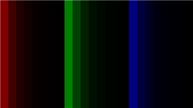

I've gotten rid of the artefacts for static images in 1440 Hz mode. It's the dynamic ones that are now giving me trouble. I'm attaching 6 images that, when shown in sequence, should result in a square moving from the left to the right of the screen over 144 frames, so 100 ms. The images look like they have bands, but actually each color bitplane contains the image of the square in a different position. So the bitplane of red bit 7 (most significant bit) contains the square in its leftmost position in each image, followed by the square slighly shifted to the right in red bit 6, and so on, in this sequence:
R7 R6 R5 R4 R3 R2 R1 R0 G7 G6 G5 G4 G3 G2 G1 G0 B7 B6 B5 B4 B3 B2 B1 B0
So when shown in succession, the sequence of the 6 attached images should produce a square moving from left to right on the screen over 100 ms. Given the speed and the "persistence of vision," this should be highly smeared, but the smear should be uniform, because each image should have the same luminance (the smear should actually taper off to the left). Instead, I see irregular, non-uniform vertical bars. As I said in my previous message, I tried all 4 possible sequences: RBG vs. GBR and bits 7-0 vs. 0-7, and all four seem to give the same artefacts (although some may be worse than others).
Do you have an explanation? Maybe the bitplanes aren't really shown in one of the 4 orders that I tried? Would you have an idea of what I need to do to get the desired output?

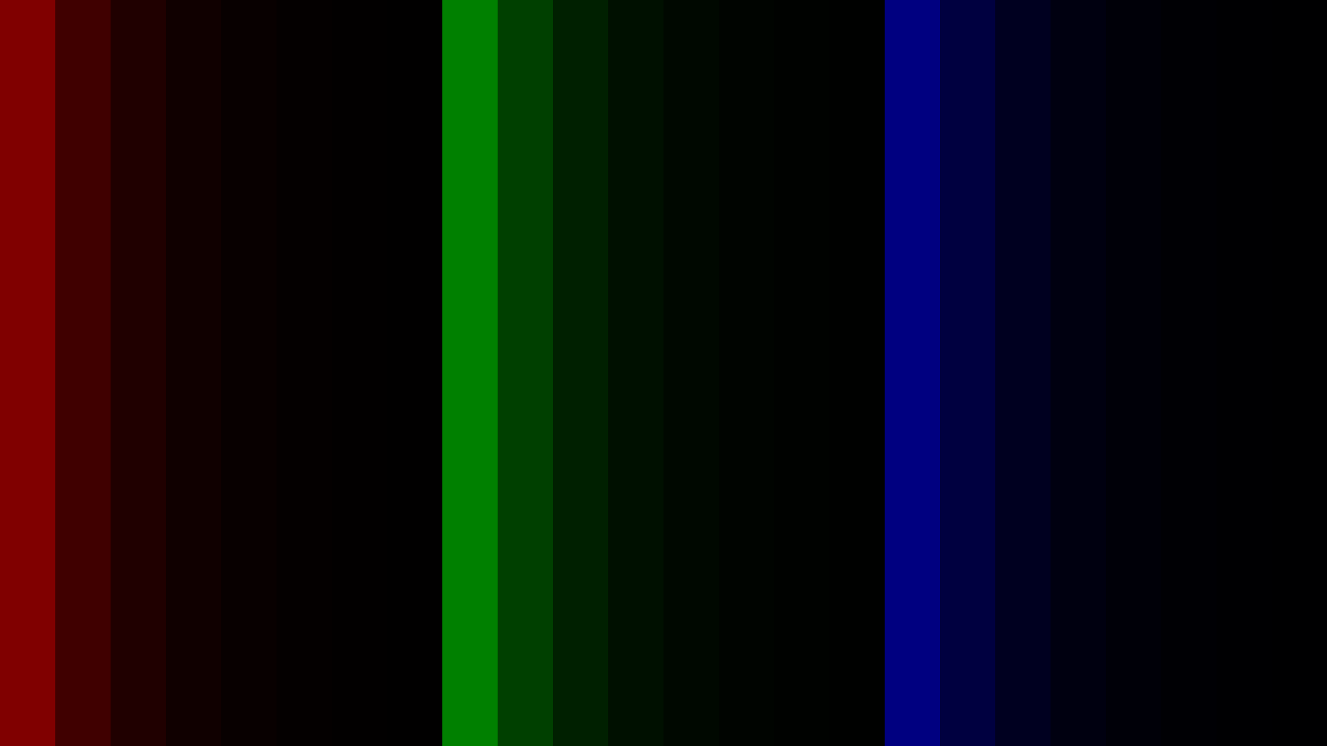

    I've now tried what you suggest. I'm enclosing the actual image file that I use (as opposed to what I was doing before, I'm not cycling through 6 images, I'm just displaying one image--as you suggested). This is what it looks like:
    The first stripe has RGB=(128,0,0), the second (64,0,0), ..., the 8th (0,128,0), etc. The actual image file is attached.

    The output I should get is bar moving from left to right 60 times per second. Since that motion is way too fast for human vision, I should get a uniform brightness throughout. That's not what I see. What I do see is a set of vertical bars of differing luminosities. I can't send you a photo because I only have a lousy smartphone camera, and the image it captures does not look like what I see. They look like this:
    • Divide the screen into 24 vertical bars (like the original image)
    • Consider the leftmost 8 bars
      • from left to right, the first bar is the brightest
      • the next 3 bars all have the same brightness, a bit lower that the previous one
      • the next 2 bars both have the same brightness, a bit lower the previous one
      • the next bar has a bit lower brightness
      • the next bar is the least bright
    • The other two thirds are about the same
    So do you have any idea about what's happening, and why I'm not getting the expected output?

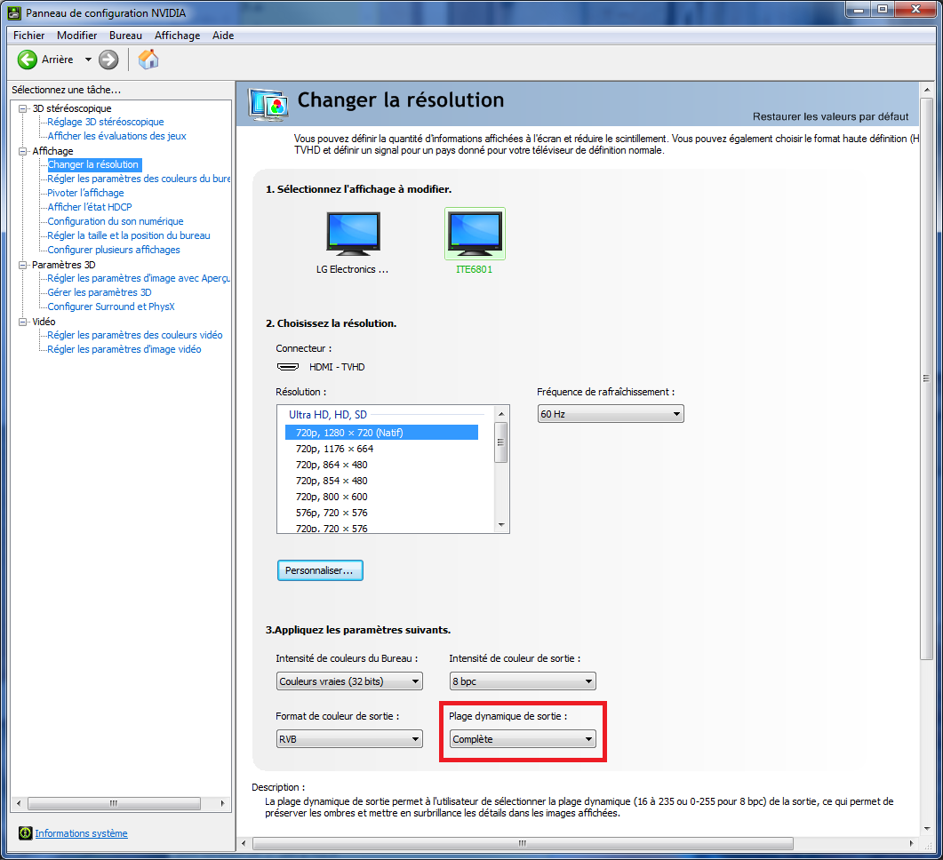

    The HDMI decoder chip and the EVM's EDID are interpreted as a digital TV by the video card's driver and thus they may restrict the displayed range to (16-235) instead of (0-255).
    If you are using an nVidia card, you can check these settings in Nvidia Control Panel -> Display/Change Resolution -> Output dynamic range.
    Hope it helps

    To complete my previous, I tested my DLP3010EVM-LC on an Intel integrated GPU. In the graphics driver, the projector is detected as a Digital Television ITE6801. By default, the output range is also limited, the setting can be changed in Intel Graphics Settings -> General Settings -> Quantization Range.
    Unfortunately we do not have ATI/AMD cards at work but the driver should offer a similar setting.

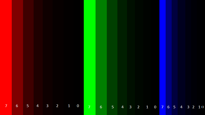

    I do most of my projector testing with a custom-designed test card, that has
    - R,G,B,W 0-255 gradients
    - R,G,B,W LSB to MSB squares (so for each color, the pixel values are 0,1,2,4,8,16,32,64,128,256)
    - fine horizontal and vertical detail
    I am projecting this test card using... the Windows desktop wallpaper (make sure it is using a lossless image format and that it is not recompressing the image using JPEG)
    The easiest way to test that the output is "pixel-exact" is to use the Light Control modes of the projector. For instance, using the 1-bit, 1-frame external pattern sequence mode, you should see the alternating LSB's of the blue and white gradients. If the display settings are left to the driver's default (except for the quantization/output range that should be set to full), the displayed pattern should be equidistant lines from end to end of the gradient.
    Additionally, by default the graphics card should not apply any gamma curve (it may if asked explicitly by the display's EDID) ; the gamma curve is applied by the display itself. On the DLP3010EVM-LC, the standard video modes use a degamma processing step, which is bypassed in Light Control modes.

  • Hi Mark,
    Did you also change the dynamic range under the Change Resolution (Affichage/Changer la résolution) page ?
    AFAIK the settings under "Video" are only used when playing video content, which is not the case here.
    Also, my suggestion about using the Windows desktop to display the test slides does not apply (at least) on Windows 7. I was unable to achieve an uniform projection with the test slides given earlier in this thread, but it worked using the integrated image viewer.
