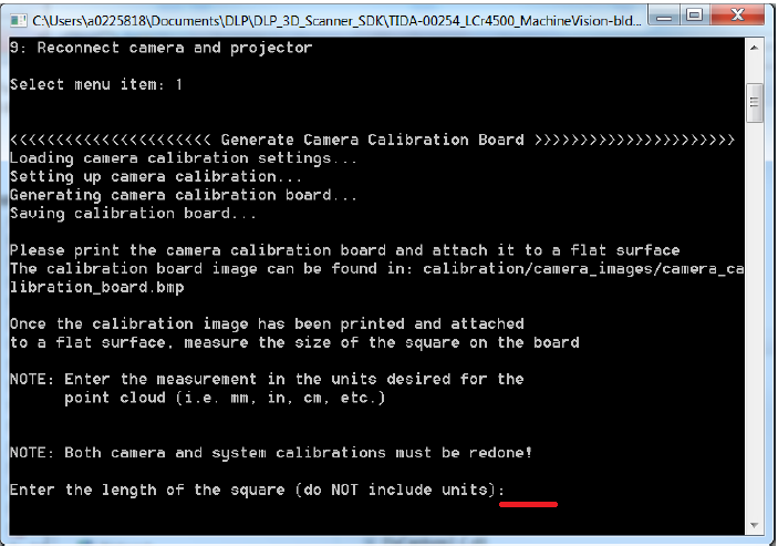

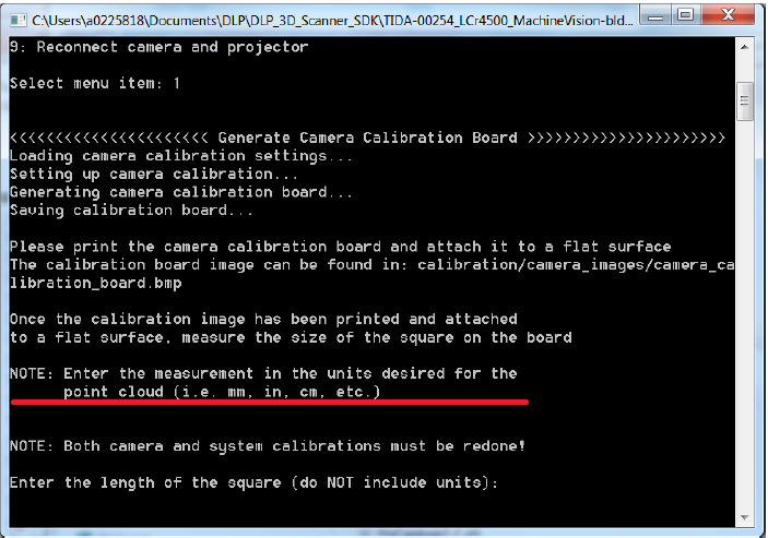

First question: Calibration board size of the square problem.
- On page 32 of dlpu019a.pdf "For example, if each square is 2 cm wide, enter "2" into the prompt"
Since the size of the square of the example is "2 cm", you can enter "2" in the command window.
However, I measure my square size is "0.9 cm", so I don't know if I can type "0.9" directly into the command window. Thank you.
Second question: Because of the red line in the picture ,  If I want the point cloud distance unit to be changed, where should I go to change the size
For example: cm changed to mm, where can  I go to set it?
    You should be able to enter decimal units (e.g. 0.9). Feel free to try and lest us know if you have any issues. The units don't matter to the program and you can use your desired units. The actual units themselves are not stored in the resulting point cloud.
    Kyle
  • Hello Kyle,
    Thank you for your reply.
    But I still have some issues.
    1. "You should be able to enter decimal units (e.g. 0.9)" ←This one I can understand.
    2. "The units don't matter to the program and you can use your desired units" ← But I cant understand how can I use my desired units.
    In this picture, I have no space to enter my desired units, I can only enter the length of the square at the red line.
    Chris
  • Hello Chris,
    You do not enter units into the program. The resulting output is unitless. Therefore, you can use whatever units you want as long as you are consistent. They will simply not be stored in the program. For example if you use inches, all numbers input and output will be in inches; however this unit is not stored anywhere.
    Kyle
