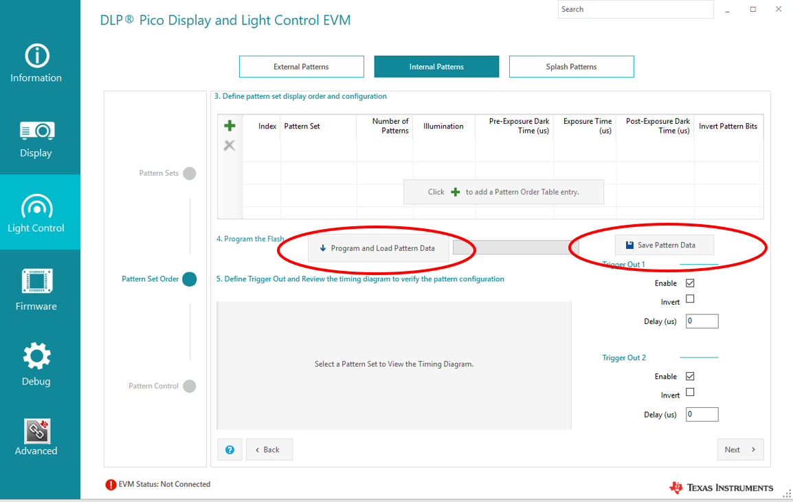

We click "Light Control" ->"Internal Pattern" ->"4.Program the Flash"
Could you tell me means of "Program and Load Pattern Data" and "Save Pattern Data"
We see DLPU074. But I could not understand.

Hiroyasu,
I'm not sure I understand your question.
Load pattern data will generate the pattern data and load it to flash through I2C while Save Pattern Data saves the data as a binary file on the PC.
Please let me know if this answers your question.
