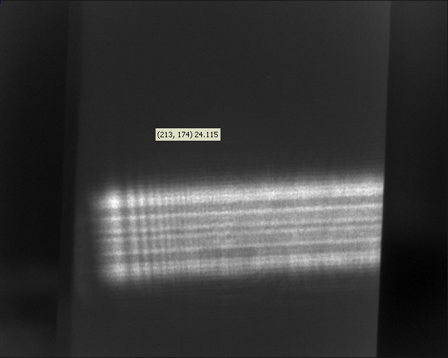

We were trying to use DMD chip to generate specific patterns, powered by laser sources. The DMD generates abnormal scattering stripes additional to the desired patterns. The scattering-like patterns are superimposed onto the desired patterns.
  • The upper image is the pattern generated and the lower image is the projection through a projector lens. The scattering-like patterns are marked in this image.

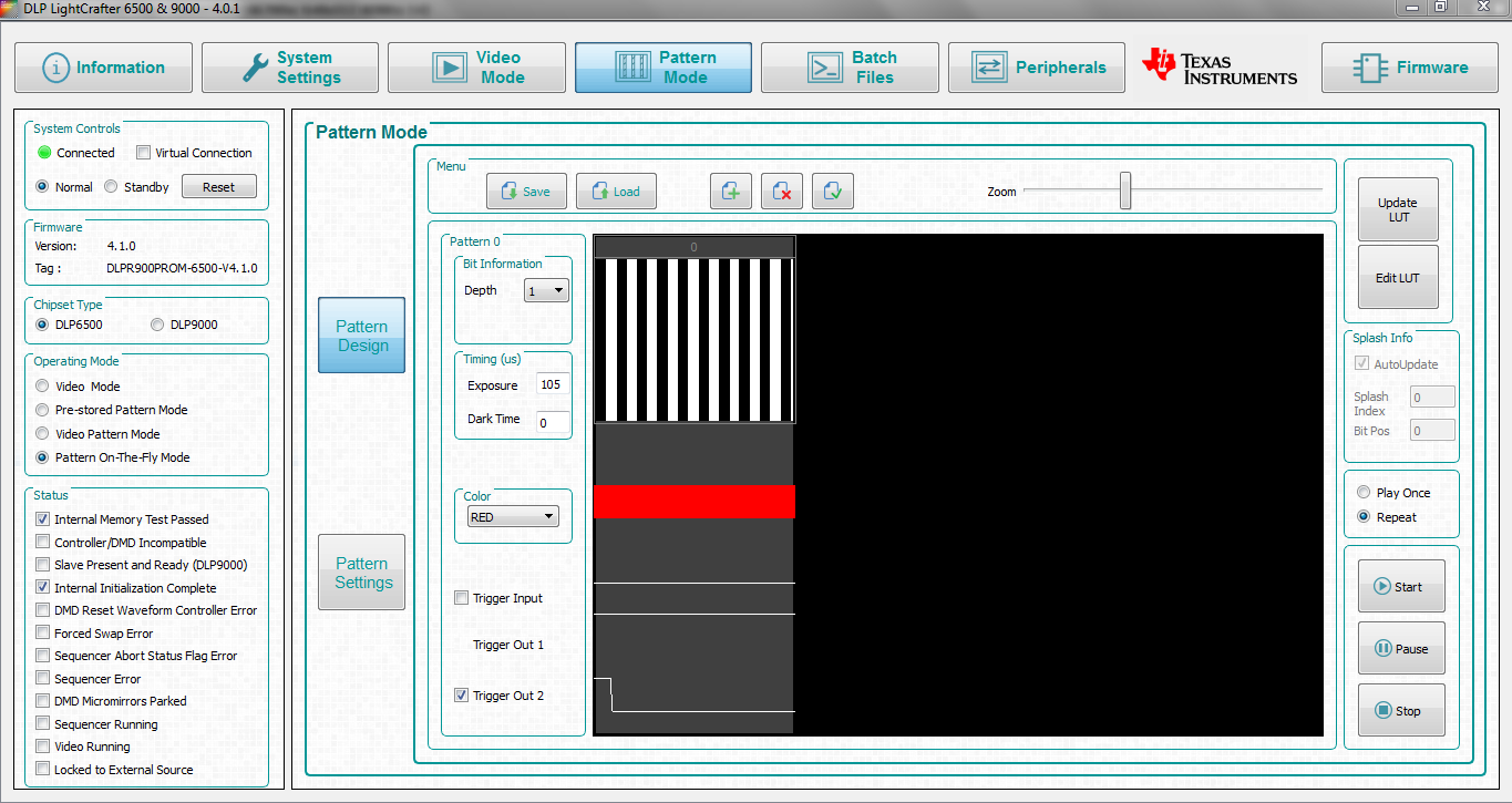

    Please show the GUI setup information/screens and attach a file with at least the image file you are loading to the DMD.
    Without more information it will be difficult to assist you well.

  • The setting and image are attached and I am using an IR camera so I am not sure if I can pull out the complete settings of the camera.
  • Hello Shengtao,

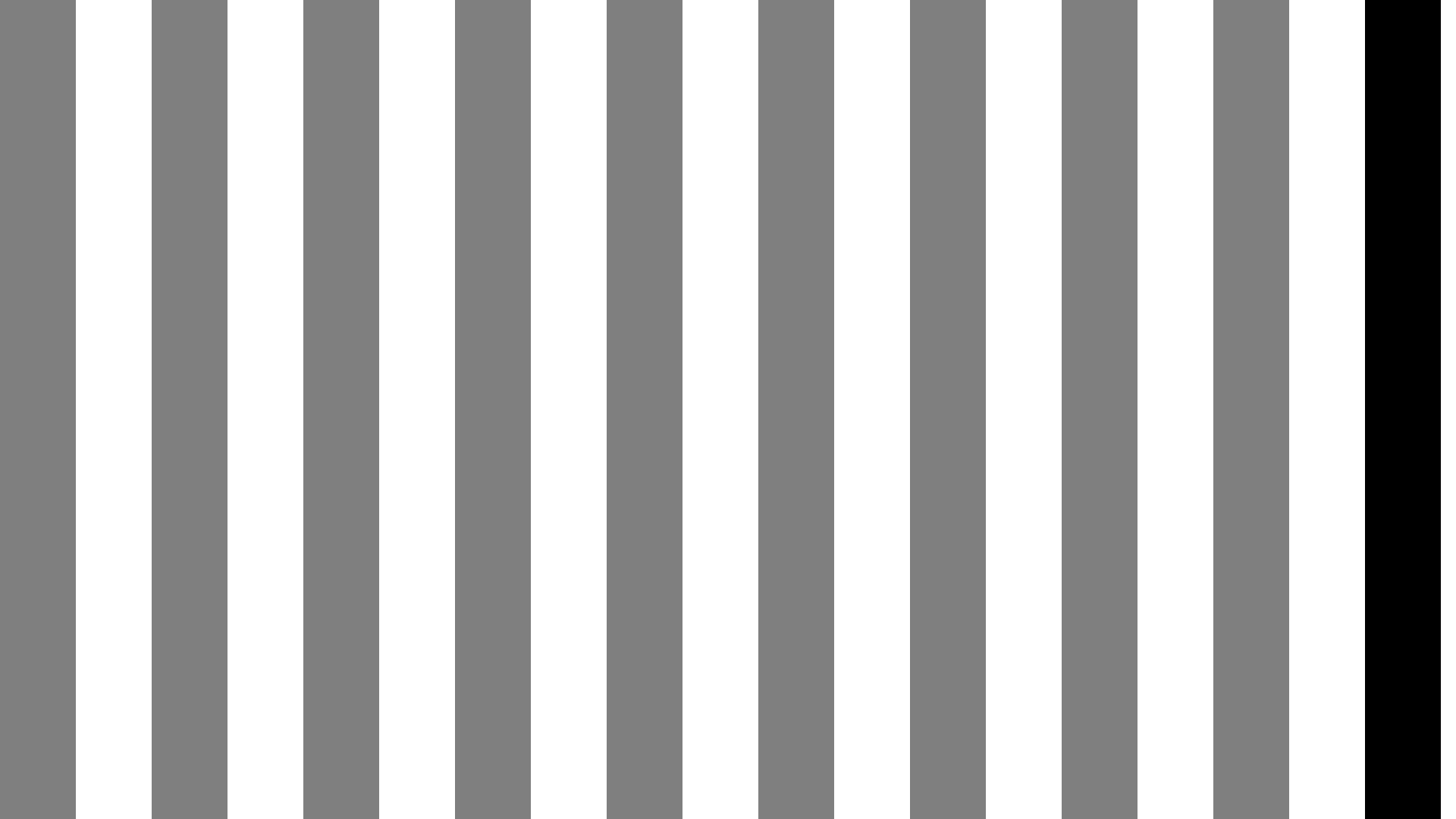

    I notice in your settings you have it set to 1 bit over 105 µs.  Please change it to 8 bit (it will adjust the exposure to 4046 µs).  I assume from the image you are attempting to to display gray stripes with one black stripe.  What you are displaying is black stripes (since the gray is below the threshold value).  I do not completely understand the picture though.

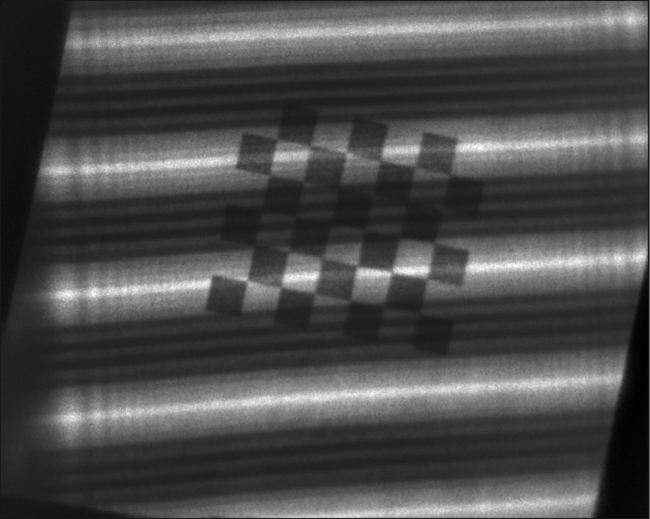

  • Well the problem is not about the color actually. I also used only black and white image and this is what I have after the dmd. The projected surface is a flat surface and it is white background with a checkerboard on it. It will look just the same with a white paper. I would like to know what is the cause of these fade stripes beside the pattern I want and how to solve this problem.

    Are you able to see this with your eye or is this only in the camera images?
    If it is visible with your eye, then I wonder if this is a coherency effect:
    • Is the illumination beam collimated?
    • Do you have a lens system that is imaging the DMD pattern onto your target?
      • If not, then you may be seeing diffraction effects of the pattern that is on the DMD.
      • How do they change if you move further or closer to the DMD?
    Also, what is the wavelength of the light?

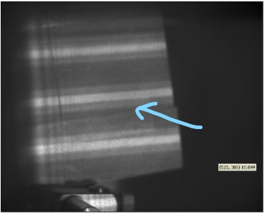

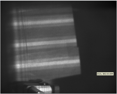

  • Single stripe looks like this.
  • Hello Shengtao,
    It is clear to me that you are getting edge diffraction from the stripe(s) and in the single stripe image it looks like slit diffraction and in the multi-stripe images it looks like orders from the multiple slits.
