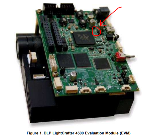

I use my DLP4500 LightCrafter EVM to trigger my camera. I have wires connected from J14 > BNC > Amplifier > BNC > camera. My setup is on an optical table. It appears that if my BNC end enter in contact with my tables, the lights turn off and disconnect from the GUI. This happened a few times.. and what I would do is to take the bnc to my hand for a second and the EVM would light again. So I isolated my BNC cables. But accidentally when changing the setup to a new camera one BNC end slipped to the table... I tried to ground it, to unplug and plug again everything, to restart computers, to uninstall USB controllers... but now my projector cannot turn on anymore. When I plug the EVM (I use the charger sold with the projector) the fan goes on, but the green LED no top STAYS OFF and nothing is displayed. The EVM is not recognized by the computer and does not connect to the GUI.
Can I do something to troubleshoot ? Can I reboot ?

    Unfortunately, I think an IC on the board may have been destroyed in the last incident as a status LED is not turning on and you cannot connect the EVM to your computer. Have you tried to probe some test points to check the voltages?
    Can you tell me which status LED on the board isn't working? I will try to take a look at the schematic and determine which IC may be causing the problem. Sometimes, even replacing damaged components sometimes doesn't fix the EVM when a short occurs.

    Thank you for your support. The green LED that does not turn on is the D4 LED (the one on top of the board next to the mini-usb port, the one circled in red on the picture). And when plugged, the green LED under the board next to the flex cable stays on.

    From looking at the schematic, this LED is tied between the 3.3V supply and the DLPC350 heartbeat pin. Can you please try to probe the 3.3V supply on the board? You should find a marking on the silk screen labeled P3P3V.

    Can you please probe pin 3 on J31? This pin is connected to the 3.3V supply. J31 is a 9 pin connector.

    Pin 3 of J31 gives 3.3V output. Seems fine. Do you have further instructions ? :)

    Because the 3.3V supply seems to be working, I believe the short caused damage to the DLPC350 controller. The DLPC350 controller has a pin called "heartbeat". If the controller were functioning properly, the LED between the 3.3V supply and this pin would be blinking. I was hoping there was an issue on the 3.3V supply, as this could mean the controller was still functional.
    However, because the supply is fine, something damaged the controller. To proceed you have two paths:
    1. Replace the DLPC350 controller. However this may not make the EVM operational, as other components may be damaged.
    2. Replace the DLPLCR4500EVM.
    I'd recommend replacing the EVM if possible, as I've seen other users struggle to replace comments. I wish there was a better way to get your issue fixed faster! Please let us know if you have any questions!
