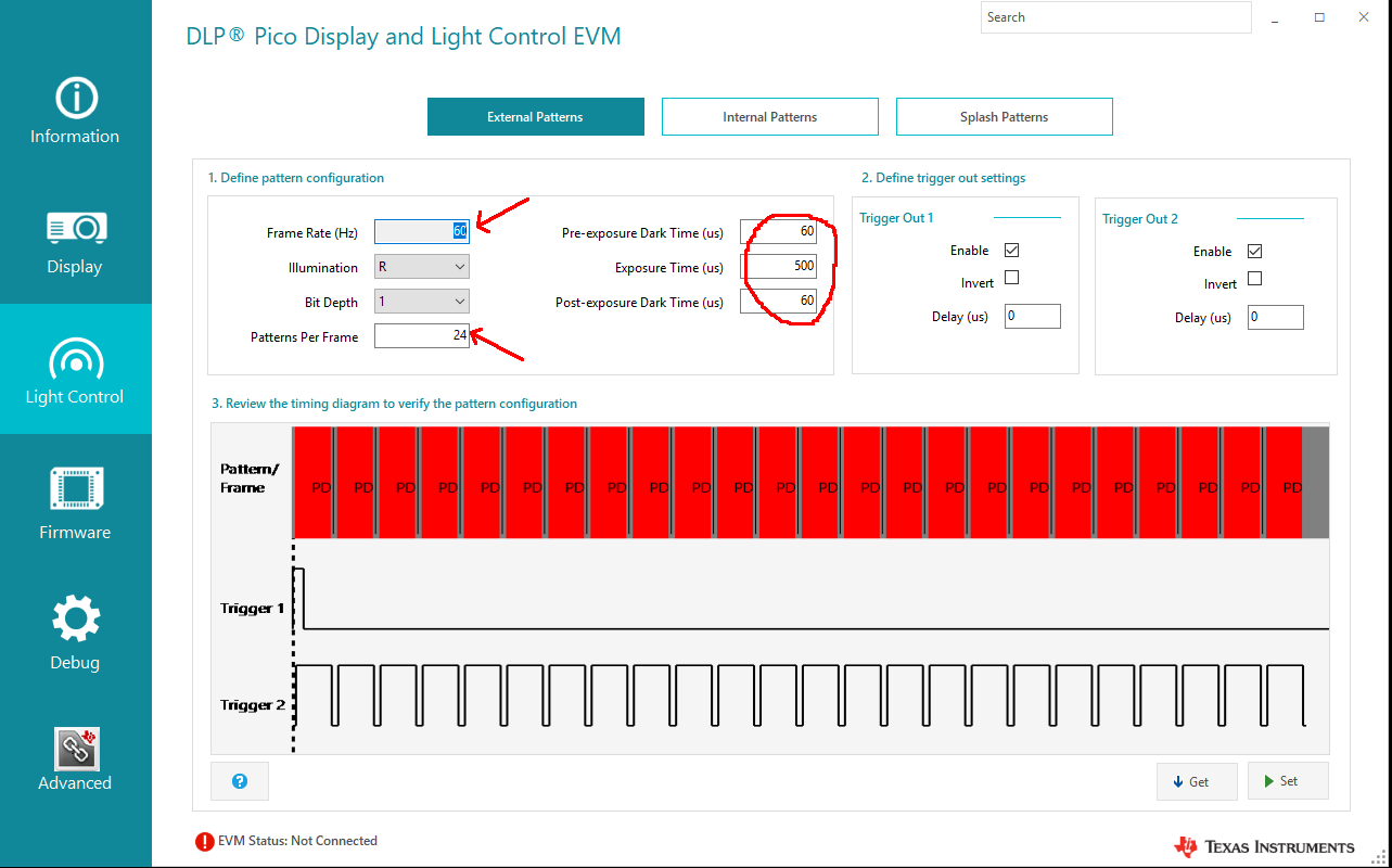

Please check the screencap:
The "Frame Rate (Hz)" is unresponsive and I am unable to change the default value of 60. Why? I want to set it to 103 to get 103x24hz monochrome streaming.
  • Hi John,
    The Frame Rate field is not editable, it calculates the effective frame rate based on the timings and number of patterns specified. You don't have to specify the Frame Rate field, just provide a 103Hz HDMI input and set the appropriate timings.
    To update the Frame Rate field, provide the required timings and number of patterns, hit 'Set', and then hit 'Get' to see the effective Frame Rate. Note that this field is just provided by the GUI software for user information and not actually used by the EVM.

  • Hi John,
    1) The EVM doesn't have an option to specify frame rate. Once it receives a Vsync pulse, the DLPC3470 starts projecting as many patterns as specified by the Number of patterns field. It continues to do this until the requested number of patterns are projected, and waits for the next VSYNC (assuming VSYNC does not arrive in between). Once the next Vsync arrives, it moves to the next frame and repeats the same sequence. It is up to the GPU to ensure that data is sent at 103 Hz.
    2) The number of frames that the EVM will process per second depends purely on the number of Vsync pulses it recieves every second.
    3) The Frame Rate is calculated from the timings entered in the GUI and and has nothing to do with the HDMI input. Frame Rate (Hz) = 1000/[(Patterns per Frame) * (Exposure Time (us) + Pre-Dark Time (us) + Post-Dark Time (us))]
    4) By "this field", I meant the Frame Rate field. As you can see above, the GUI calculates the effective frame rate of input required for the given timings. This is just for the user's convenience and not sent to the EVM, unlike the information in other fields.

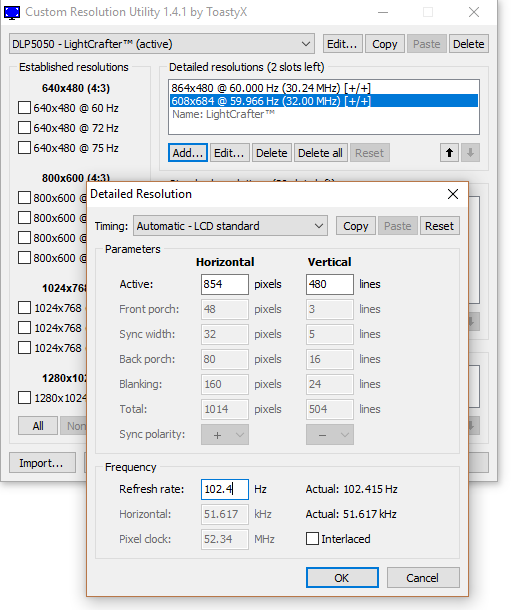

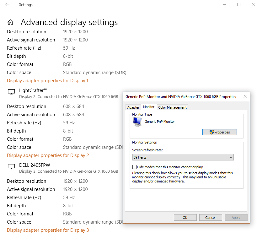

  • Hi John,

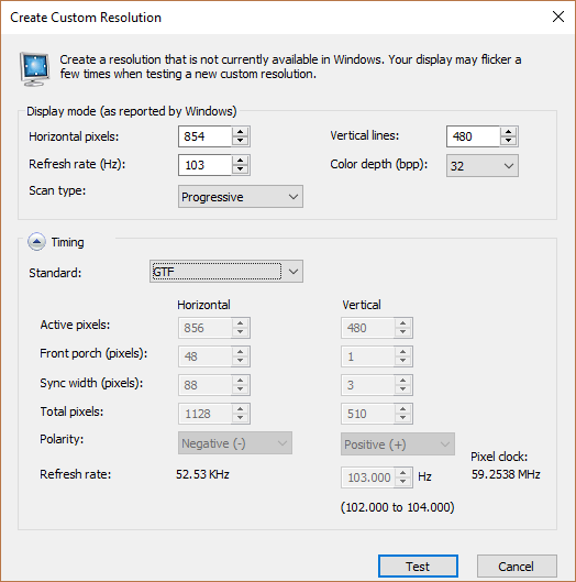

    You can definitely ask the GPU to output "non-standard" resolution and frequencies.
    If you are using an nVidia card, you can enter a custom resolution in the Nvidia Control Panel. Go under the Change Resolution tab, make sure you select the projector then click "Customize". Then, click "Create Custom Resolution" and you'll get a dialog box which allows you to enter the desired resolution and framerate, and you may also tweak the actual video timings. (note that this tools seems a bit buggy, after entering the mode parameters, select any other standard than "Automatic" (e.g. GTF) otherwise the timings are not properly calculated)
    You may also use the "Custom Resolution Utility" (https://www.monitortests.com/forum/Thread-Custom-Resolution-Utility-CRU) which allows you to create EDID overrides in Windows' registry (this has the same effect but I tend to find it more reliable when tweaking the resolution than the Nvidia tool).
    You can then select the newly added resolution in Windows' display settings / Advanced and change the refresh rate (please note that I did not effectively add the 103Hz resolution on my system, this is an older EVM that does not support refresh rates over 60Hz, but the principle is the same).
    To make these changes permanent (otherwise they will only be valid on the computer where you did the manipulations), you'll need to add the mode line to your projector's EDID Flash ROM (I have not tried to do that).
