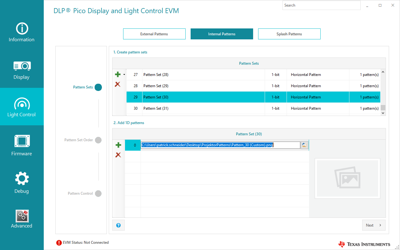

I have several issues with the GUI of the Lightcrafter:
1) I am trying to program about 31 png internal patterns (horizontal + vertical, 1 bit) and not all are shown. The first ~10 are being displayed and everything else stays black ('Run Once  / Run continuously).

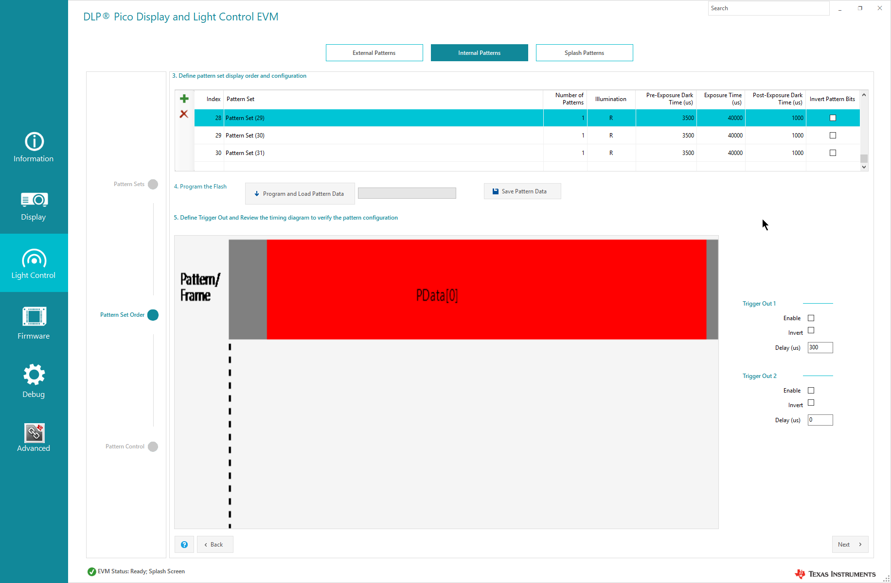

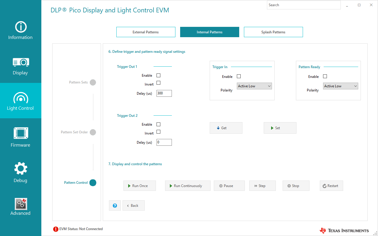

  • Hello Patrick,
    Sorry for  the issues you are experiencing. Could you upload screenshots of the GUI (Pattern Sets, Pattern Set Order, and Pattern Control)? We'll go from there and let you know if we need the log file.

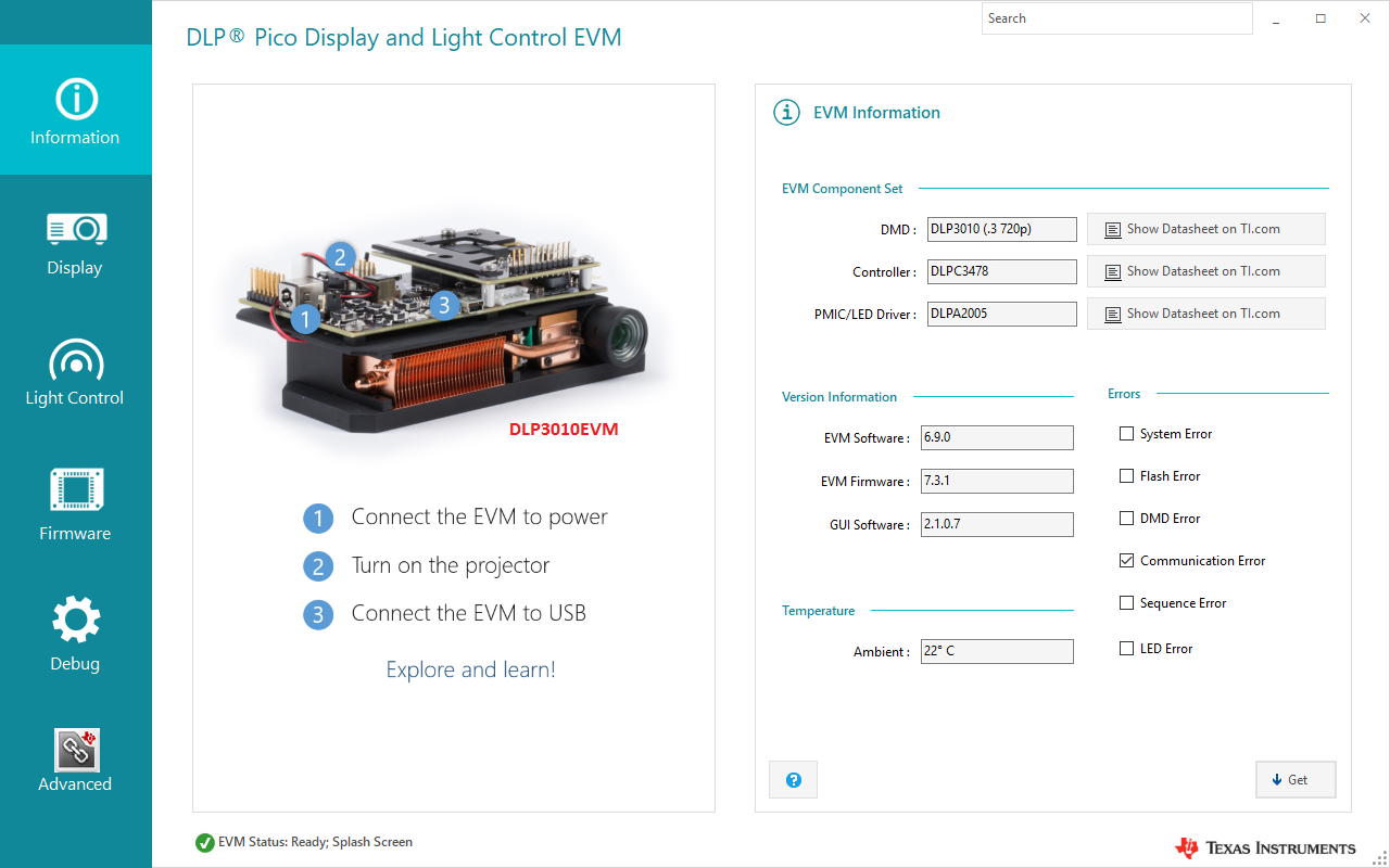

  • Hi Patrick,
    Please also share the firmware and GUI versions that you're using. A screenshot of the Information page would be helpful.
    Azad
  • Of course, here they are (, )
    Information page:
    PatternControl:
    PatternSetOrder:
    Pattern Sets:

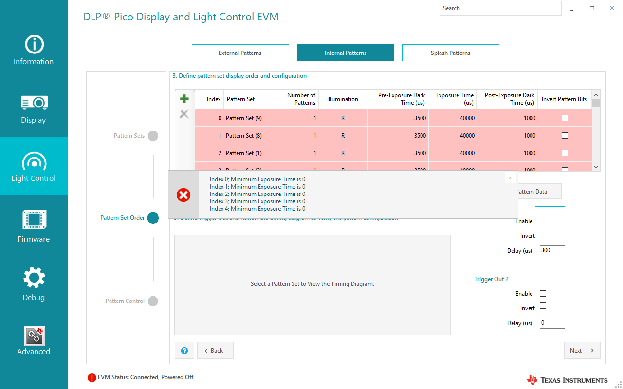

  • Some additional remarks to other issues (contacted customer support, but the refer to the E2E)
    - Might just be a logical bug: The exposure time should be higher than 0. According to the appended screenshot I have definitive an exposure time higher than 0. This only occurs, if the device is connected, but not turned on.
    EDIT: It also occurs if the device is not connected.

  • Hi Patrick,
    Please share the log file with us. You can attach it here, it doesn't contain any sensitive information.
    Regarding your other queries:
    • The minimum exposure time is read from the EVM through I2C, so it will be shown as 0 if EVM is powered is not connected or powered off or if communication fails.
    • The Communication Error may be set initially, but will be cleared after the first read. As long as I2C communication works, you're good to go.
