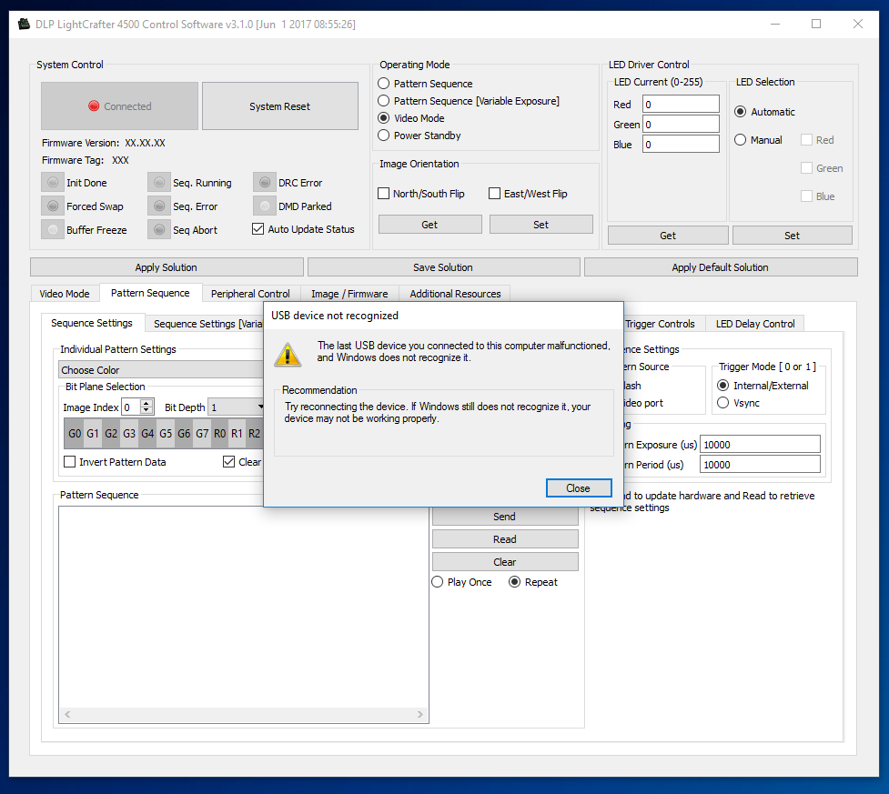

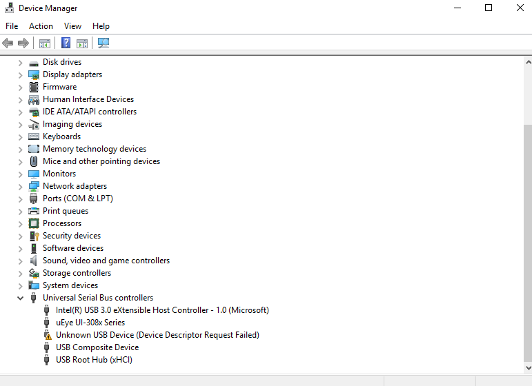

I received my EVM last friday and it worked properly in my setup for 2 days and I could record images this morning. But when I went back for lunch, for no apparent reasons, I am having issues with the device that is not recognized by my computer anymore (see screenshots). When turned on and connected to the computer (Windows10) the fan turns on, a moment later the green LED D4 turns on and stays on (instead of blinking) and then after a moment the projector flashes crazy RGB random patterns... The problem is reproduced with another computer and restarting changed nothing.
Do you have any idea what is happening ? Firmware corrupted ? I tried to look for similar forum thread but I was unlucky. Thank you for your answer,

    Thank you so much for your answer. So I tried to put a jumper on J18 (I used the jumper from trigger input J12) and I turned on the light and connected it to the computer but, unlike in the thread, my computer still gives me a message "USB device not recognized" and the light does not connect to the GUI and I cannot upload any firmware... it does not seem I can enter the " bootloader mode". Here is a video of what is happening.

  • Hi Emilie,
    Could you kindly try another USB Cable / PC ? If this doesn't work, it may indicate there is some hardware issue with your board.

    I tried with other cables and other computers, still the same problem. I just received it four days ago and used it twice, if it is hardware issue is there any warranty on it ?
