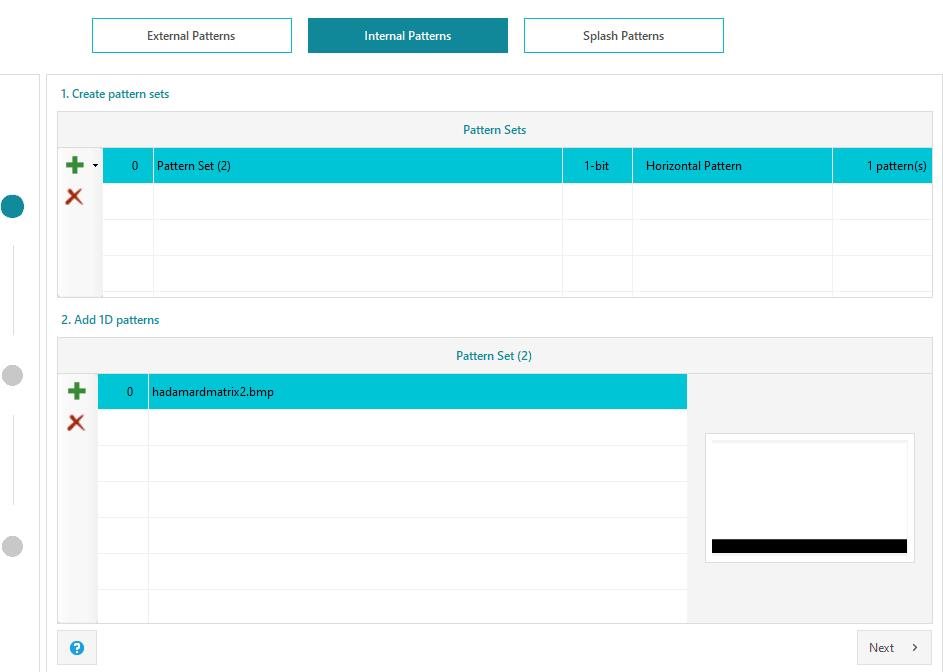

  • Hi Brandon,
    I have operated it in this order.It warns me that my image width is smaller than the display width when I enter the matrix image with black and white blocks, then I choose white light, it projected white light all, not the
    alternating white and black blocks like what I imagined. Projection, I want to know how I verified that the matrix image I entered successfully set each micromirror in the DMD, have you provided the correct test method
    for me.
    Zong

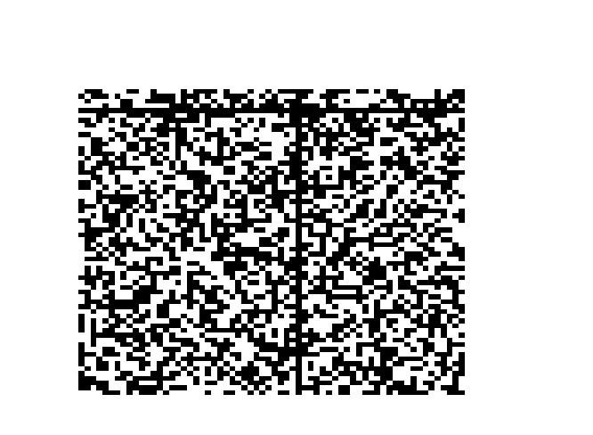

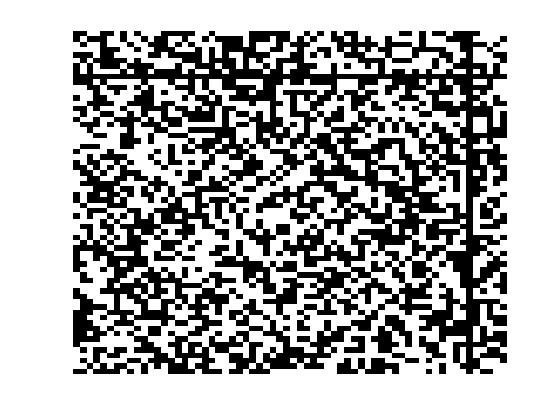

  • Hi Brandon,
    I am sorry to reply to you late because some terrible things happened. I also make attempts . Your answers guide me to achieved results.depicted in Fig.1
    but,It is not my demand,I  want to use the image depicted in Fig.2 to set each Micromirror of DMD,I wish every one can be ON or OFF according to the Black and white block mixed matrix but not be displayed simply as a picture ,My project requires me to use the DMD as a coded mirror instead of a simple projection system by setting up the matrix.
    Do you have any other way to help me achieve it? I am grateful.
    Zong
  • Hi Zong,
    Can you save that image as a .png or .jpg file, then use an image viewer to display the pattern in full screen mode? This should allow the EVM to just display the pattern and the entire computer screen.
    Brandon
  • Hi Brandon
    Above Fig.1,It is sucessful to show  a part of image ,Full screen display is achievable. But ,I am afraid that you may can not understand my idea ,what you say may not help me control micromirror ,which only help me project one image and useless for my designed system ,I have explicitly mentioned that I need to control the flipping of each micromirror according to the image to achieve spatial encoding. It is not a simple display of images. This method of using a photo editor to enlarge the image is not worthwhile for me. Do you have any other methods to control the micromirror? In addition, if I set it up successfully, there are other ways to check my micromirror flipping situation. Can I observe it if I disassemble it?
    Zong

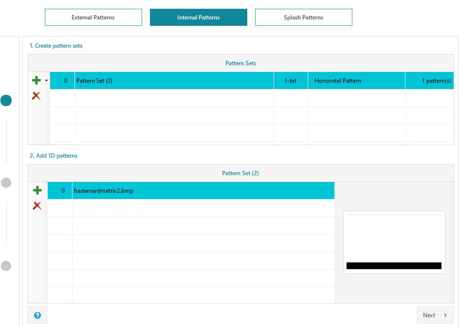

    Thanks a lot for your assistance . I have another idea that input one image with  black and white block matrix into EVM by internal pattern button . The 1D mode means that each row of pixels of the picture controls each line of the DMD In turn, The imaging system receives the data brought by each row of DMD changes, stores them sequentially and then  the signals are integrated during the imaging process and subsequent signal reconstruction. Here I encountered a problem, after the picture entered, as shown in Figure 1. The GUI warning image size is smaller than the display size, and the preview interface shows that my picture has only one line of black rectangle, as shown in Figure 2 below. Ignore this problem and set the parameters to RGB, exposure time, etc. The result of the light machine projection becomes three. The rectangle of the color transform. Can you help me analyze how the problem occurs? My image will become a black rectangle when previewing and projecting, which is inconsistent with any row or column of my image.
    Fig1
    Fig2
    You are going to want to input an image that matches either the vertical resolution or the horizontal resolution of the DMD. For column replication you can use a 854x1 image and for row replication you can use a 1x480 image.
    Kyle
