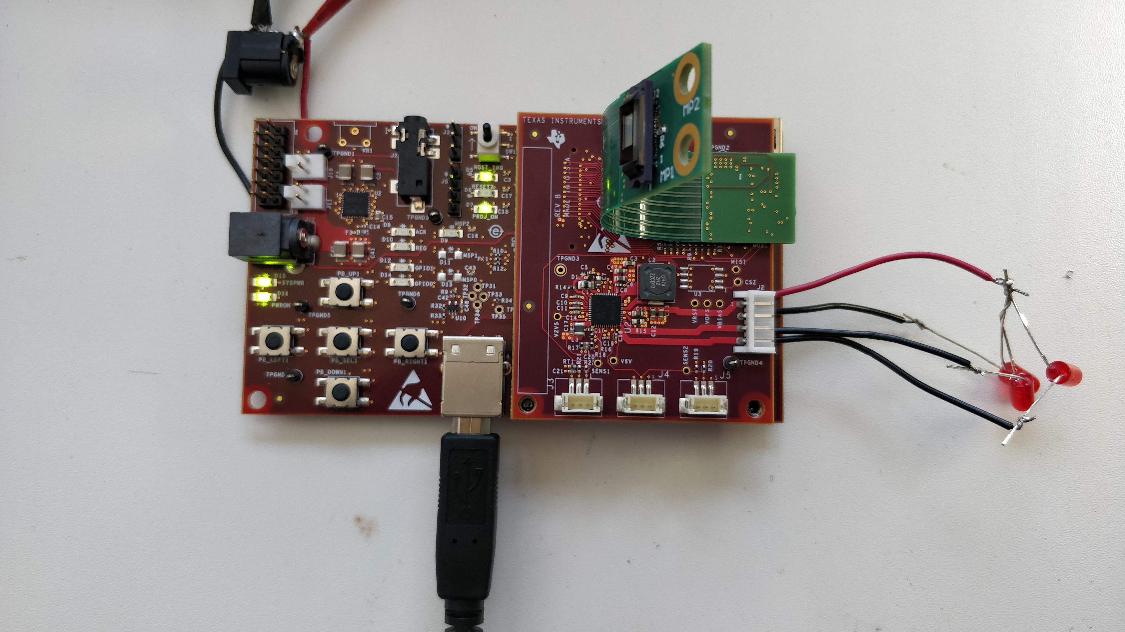

I have DLPDLCR2010EVM-PCB. Before powering it up, I detached the upper board "DLP board" and connected a 5V, 3A adapter to the board. Only one LED was on "SYSPWR". However, I noticed that U12, U9 and U1 were getting very hot. Hence I disconnected the power and found that U9 looks burnt (I am not sure). measuring the resistance between the positive and negative pins of the input, I found it 6 Ohms. This means that there is a short circuit somewhere. To measure the powers, I had to connect the power again and remove it within few seconds to avoid the heat. The measured voltages were:
U1 = 1V6
U12 = 1V8
U17 = 0V8
As you can notice, these numbers are not as expected from the schematics. Do you have any suggestion?
