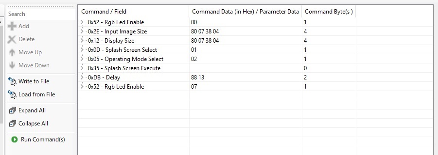

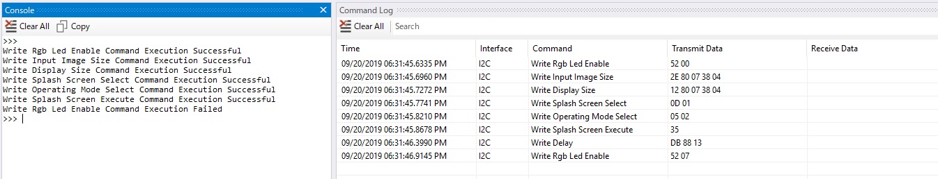

I'm trying to display the # 1 splash screen as a way to run scripts and batch command. Bat command works fine,but scripting doesn't work. What problems do occur in python script? Please reproduce it and provide something of comments.
[Batch Command Execution : OK]
[Scripting Execution : NG]
It looks last command as WriteRgbEnable fails.

  • Hello Uryyy,
    The problem is with the Write Delay command (DBh). From the Programmer's Guide (dlpu081a):
    "This command is used to specify an execution delay time within a Flash batch file. It can only be used within a Flash batch file, and is not a valid command on the I2C interface."
    As the python script basically sends the commands over the I2C interface, it is not a valid command. Instead, you can use the sleep function in python to wait for the splash image to be loaded:
