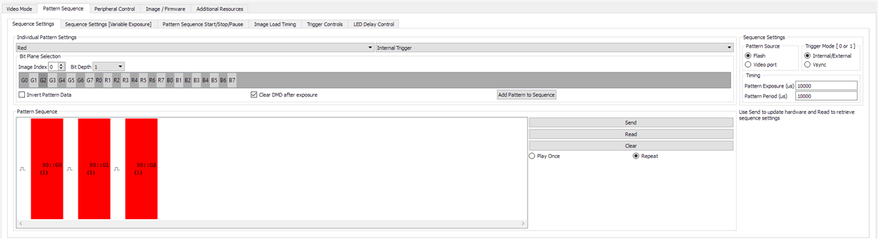

My application is high-speed 3D reconstruction using structured light system. Here I am doing line scanning for the same. I want to make use of maximum available speed, which is 4225Hz.
Available options:
1) Store the patterns in flash memory and achieve this speed. As suggested by manual, only 48 bit planes can be saved in buffers. But line scanning need 912 bit planes(number of columns of projector). So it is not possible to achieve the required speed using this.
2)Use video port and achieve 2880Hz. Here my question is once I use video port, it is again limited by my laptop screen refresh rate which is 60Hz as whatever shown on the screen is being projected. In the manual also it is not so clear to me how to use video port to achieve 2880Hz. Do we need to use GUI for this?
If any other possible option to achieve this, please do suggest.
I went through threads related to it. But not so clear to me.
Kindly please guide me through.

  • Hello Gopi,
    If you need more than the 48 pre-loaded patterns you will need to use external input. As you mentioned this will be limited to 2880Hz. If you can only input 24-bit depth 60Hz video you will be limited to 60 Hz * 24 bit depth = 1440 Hz single bit depth display. You may need a different graphics card or an FPGA if you are unable to achieve a higher external input frame rate.In any case, the GUI is to setup your bit plane display. The way you input video is independent of the GUI.
    Kyle

    1) In my application I want to use single bit depth patterns which are lines. If I combine 24 lines into 24 bit planes and then send it then DLP considers it as color image and displays accordingly as mentioned in $4.1 of the manual. But I don't want this kind of projection. I want to assign equal time for every bit depth plane. How can I achieve this?
    2)If I send every bit plane separately by considering it as 24 bit depth then I can only send 60 lines which limits my speed of application.
    Kindly please suggest possible solution.
    Thank you
    Gopi
  • Hello Gopi,
    This can be accomplished through the GUI as shown below for three patterns (simple extend it to as many as you have in a frame - i.e. 24 for you). You can set equal time per pattern.
    Kyle

    As you suggested I am combining 24 sequential lines into one 24bit RGB image by considering each line as 1-bit plane. Like that I am creating 912(number of columns)/24 images and then created video with 60 frames(max. refresh rate supported by my laptop) per second. Then I created 24 bit planes as given and pressed send and then validate the sequence.
    Is it the same that you suggested? If I am wrong, kindly correct.
    When I started playing the video, I pressed play button in GUI. It is working but there is flickering and output is not that we expected.  One more problem I am facing is: manual suggests that we should have same resolution(912x1140) while playing. But my laptop doesn't have that resolution. May be this is one of the issues that is causing these undesired effects, while playing the video.
    Kindly provide possible solution.
    Thank you
    Gopi
  • Hello Gopi,
    It sounds like what you are doing is correct. Unfortunately you need exactly 912x1140 resolution to use this mode. There may be software that can change this on your computer. But if not you may need an alternative front end (different graphics card or FPGA).
    Kyle
