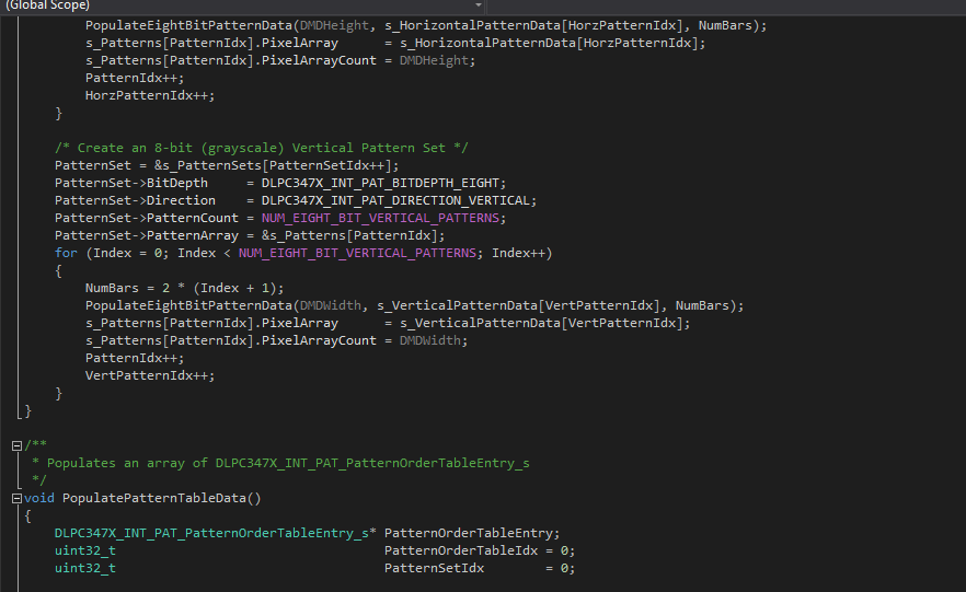

I have a dlp3010 evm lc,I want to control it with c++ ,i download the API on the website, but don't know how to start , and i don't see where can input images like internal pattern in the code as figure below,we need to use fuction of internal pattern , trigger out2 and trigger in, can anyone teach me or supply a sample code for me?

    The sample code is an example of how to create the internal pattern data on fly. You need to modify the code to read the pattern data from a file and create pattern set.
    You need to modify the function like " PopulateOneBitPatternData(uint16_t Length, uint8_t* Data, uint16_t NumBars)" to read from a file and assign the pattern to data variable.  You may replace the parameter "NumBar" with the file name.
    In the function "void PopulatePatternSetData(uint16_t DMDWidth, uint16_t DMDHeight)" please keep only those section relevant to type of pattern i.e 1 bit pattern.

    but i dont understand how to replace numbars with my file name,can you send me a sample code to read?

    The request for programming assistant is beyond scope of this forum. I will request you to consider appropriate  forum and resources for program development.
