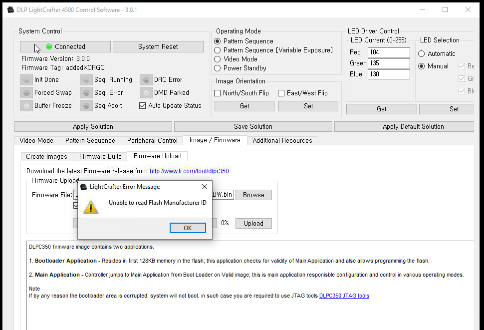

Dear TI member,
I have issue with my Lightcrafter 4500 as below:
- Working environment: Windows 10 v18362
- Working status:
+ Stored pattern sequence mode: working fine
+ Updating firmware: failed due to cannot find Manufacturer ID, please check the attached photo
after getting this message, the projector got frozen, need to reboot projector, replug or switch USB port.
+ Trial: updating firmware works normally with Windows 10 lower version, Windows 7
Have you notice this issue before, and what is the suggestion to resolve the issue?
Thank you.
  • Hi Lam,
    Welcome to TI E2E forums! I'm sorry you had to face this issue. This is a known issue in the LCR4500 GUI on Windows 10 platforms. We'll be releasing a new version of the GUI soon, in which this issue will be fixed. Kindly stay tuned! If it is urgent, and you can compile the GUI QT project, we can provide you a code fix that you can implement and recompile the GUI to fix the issue.
    Thanks & Regards, Hirak.
  • Thank you Hirak. I am glad to that it will be fixed.
    It is urgent to me, so please share the code and show me how to fix it.
    Thanks, and best regards. Bui Quang Lam.
  • Hi Lam,
    Please find the required code changes below:
    1. file: dlpc350_usb.cpp
    Replace the definition of function ” DLPC350_USB_Open()” with the code given below:
    int DLPC350_USB_Open()
        // Open the device using the VID, PID,
        struct hid_device_info *hid_info;
        hid_info = hid_enumerate(MY_VID, MY_PID);
        if(hid_info == NULL)
            USBConnected = 0;
            return -1;
        DeviceHandle = NULL;
        if(0 == hid_info->interface_number)
            DeviceHandle = hid_open_path(hid_info->path);
        else
            struct hid_device_info *hid_next_info = hid_info->next;
            if(hid_next_info != NULL)
                DeviceHandle = hid_open_path(hid_next_info->path);
        if(DeviceHandle == NULL)
            USBConnected = 0;
            return -1;
        USBConnected = 1;
        return 0;
    2. file: mainwindow.cpp
    Comment out line 7220 : “DLPC350_WaitForFlashReady();”
    Hope this resolves your issue.
    Thanks & Regards,
    Hirak.
