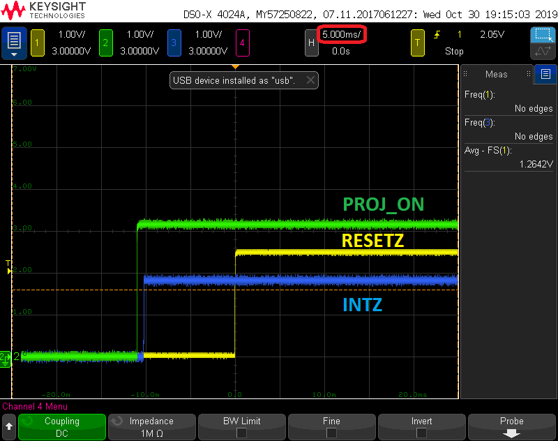

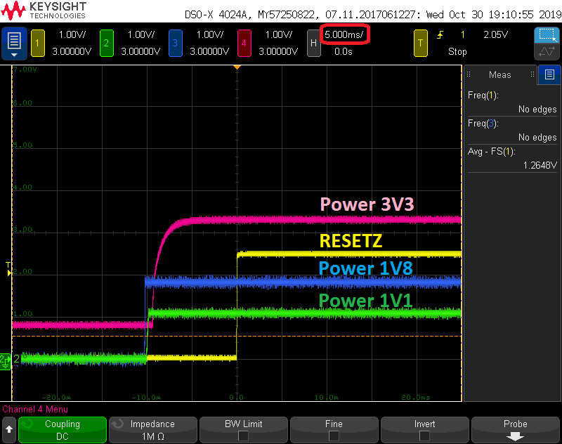

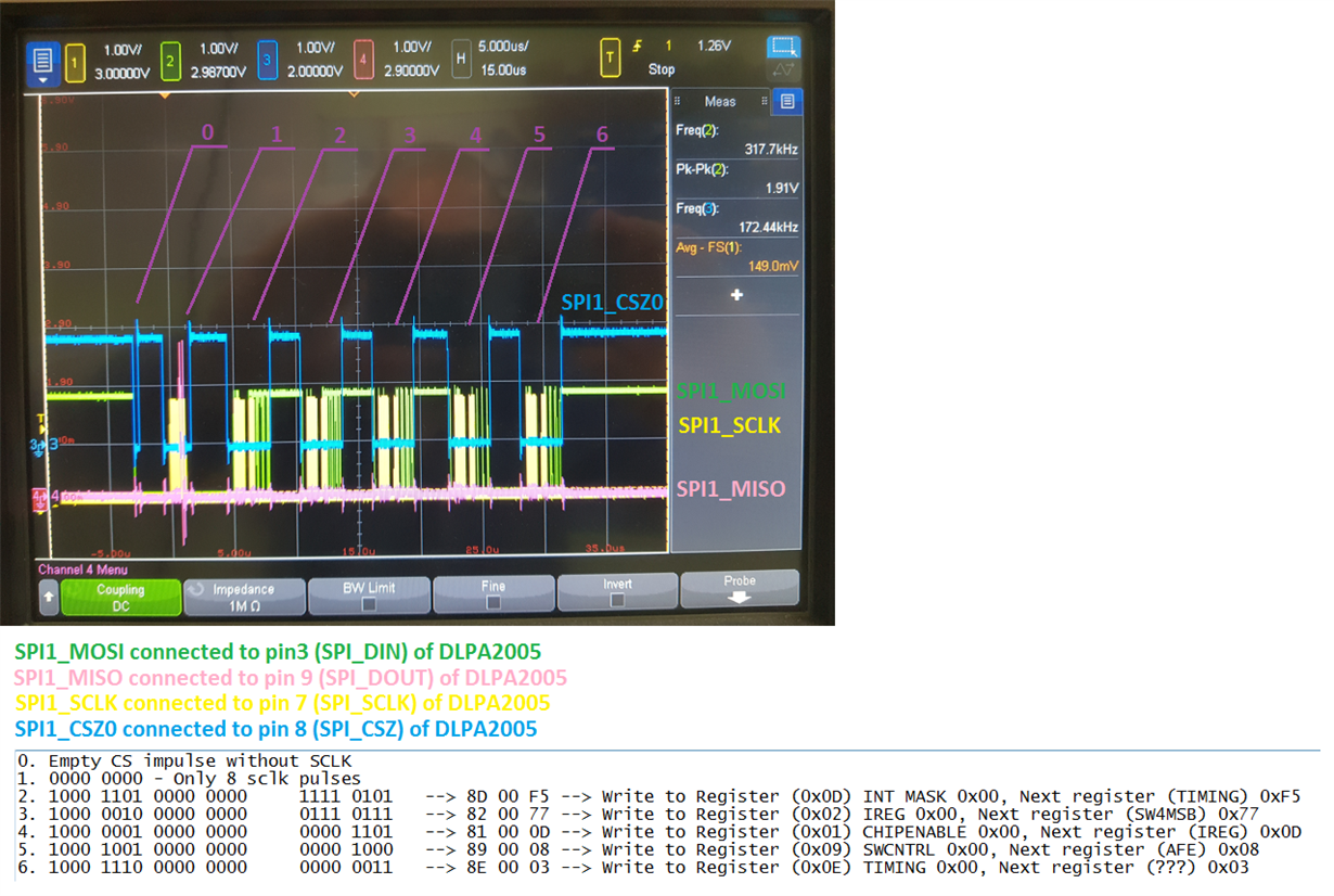

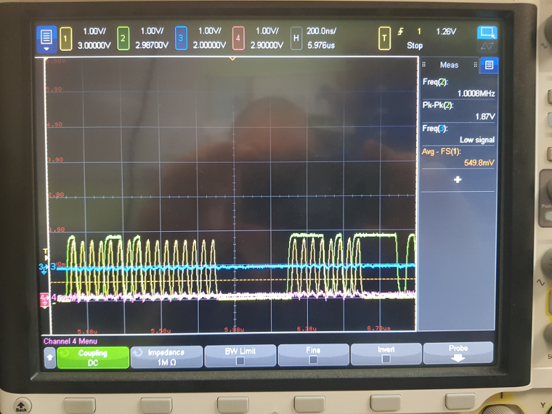

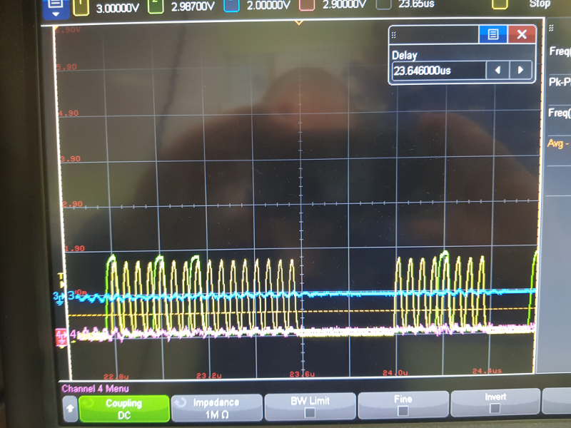

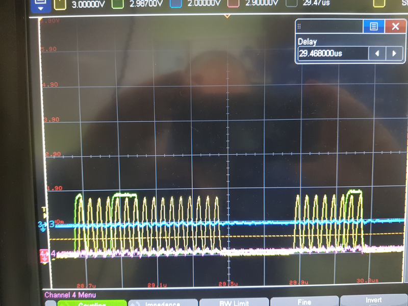

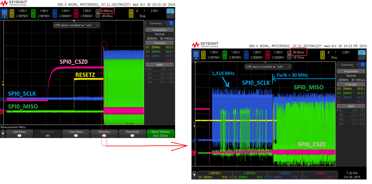

We made custom board with DLPC3478+DLPA2005+DLP3010 chipsets. We used W25Q32FVSSIG flash memory. We programmed flash memory with firmware DLP3010EVM-LC-FW which downloaded from site: www.ti.com/.../DLP3010EVM-LC.

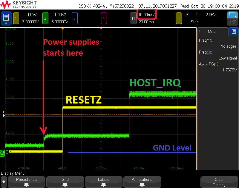

When PROJ_ON signal sets to high:
- power supplies (+1,1V, +1,8V, +3,3V) sets to nominal votages;
- RESETZ signal sets high after 10 ms;

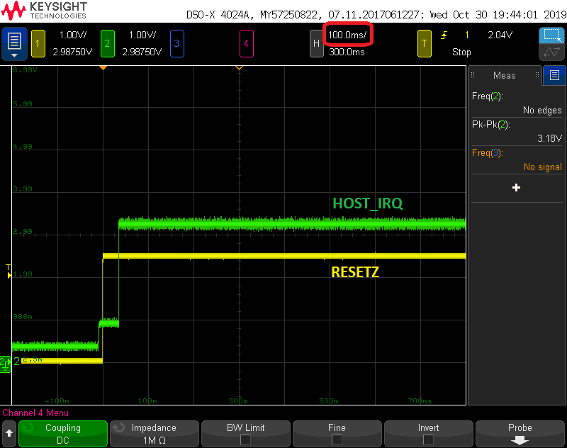

- HOST_IRQ signal sets high after RESETZ;
- 24MHz reference clock for DLPC3478 make stable after power-up after 5 ms.
I attached screenshots from oscillospoe.
I have a problem: why HOST_IRQ not sets to low?
