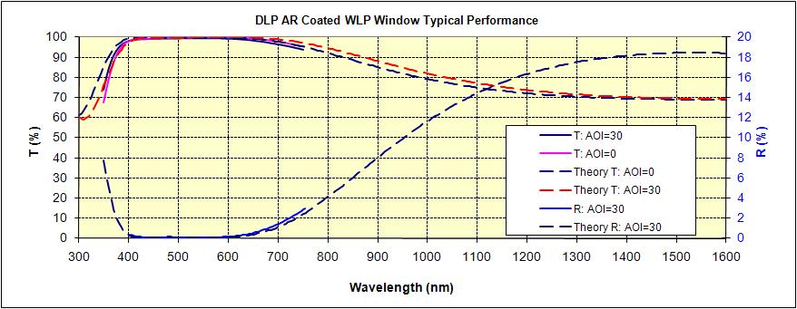

  • Where can I get a spec sheet for the Light commander that graphs the transmission efficiency with respect to wavelength of the window in front of the 0.55XGA DMD chip?

  • Hi Shwetadwip,
    Below are the transmission waveforms for the 0.55XGA S450 DMD on the LightCommander.
    The top lines are transmission, the bottom lines are reflective. The solid lines are measured and the dotted lines are theoretical.
    I have a few questions:
    What does the "AOI" label mean?
    Can I also get a efficiency graph of the reflectivity of the actual DMD micromirror with respect to wavelength?
  • AOI means Angle of Incidence
    The bottom portion of the graph is the reflectivity.
  • Sorry if this sounds like an ignorant question.
    If the bottom portion is the reflectivity of the micromirrors, then this graph says that the actual DMD chip reflects almost nothing (<4%) from wavelengths 400-800 nm.  Are you sure this is the reflectivity of the micromirrors of the actual chip?  I originally thought this was the reflectivity profile of the coated window in front of the actual chip...
    Shwetadwip Chowdhury
  • Shwetadwip,
    I'm sorry, I misunderstood your question previously. The bottom curves are the reflectivity of the window. The DMD mirror reflectivity is stated in the datasheet as 88% up to 700nm. I do not currently have the waveform for  beyond that wavelength.
  • Hello Shwetadwip,
    Although not  exact the mirror reflectivity is fairly similar to that of bulk aluminum.  Please see my response in your other thread.
