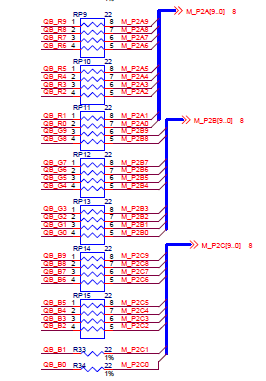

Dear, we are migrating from DLPC350/DLP4500 to DLPC900/DLP6500. Keeping the same Input, so we can use DLPC900 only in Single Pixel mode.
I see the settings in register in order to set this up, my question is:
Do I have to tie the inputs ( P2_A/B/C_(0..9) )of the unused input port to GND?

    You can keep the inputs floating for port 2 - just that you need to tristate the input using Input source commands(Refer section 2.3.3 in programmer's guide). However I recommend you to pull these pins low just in case you miss the setting and its a good practice to pull these lines low.

  • Hi Ivica,
    I assume the data channels A and B referred are the outputs from IT653x HDMI decoder chip. A is connected to Port 1 and B channel to port 2 if you are
    using TI provided EVM. In that case., you need not terminate the unused one or you can remove  RP9-RP15 and R33-34 if you are using only single pixel mode
