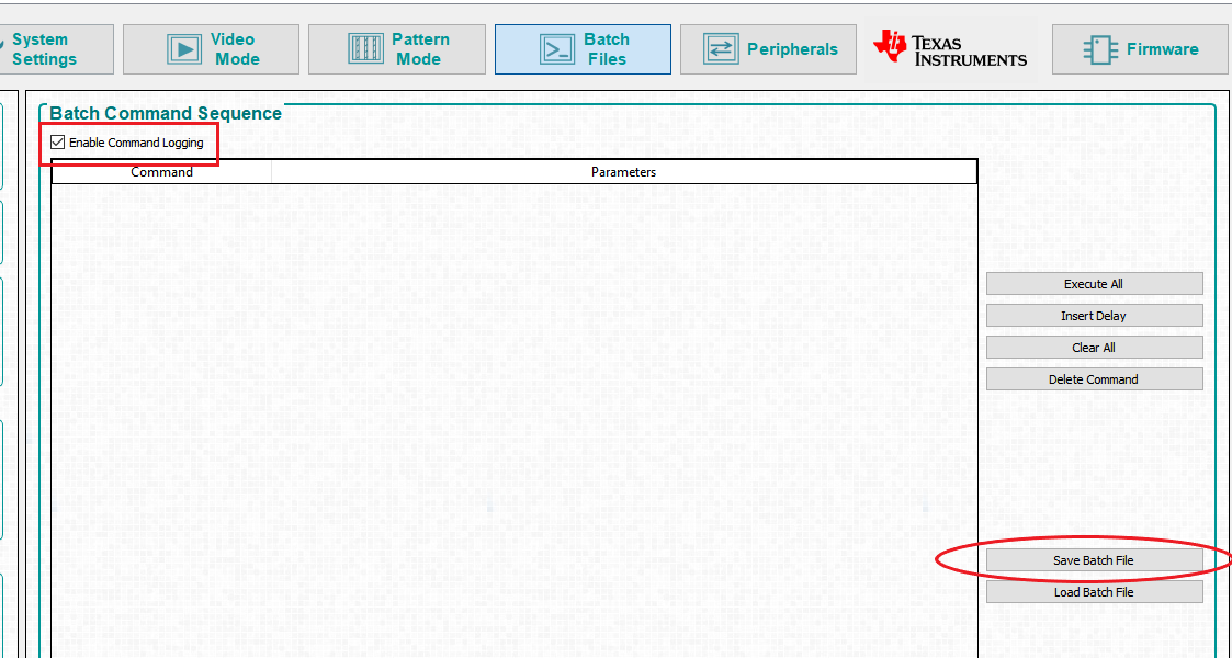

  • Peter,
    Yes, there is functionality provided in the GUI to record the USB commands being sent. You need to go to batchfile page of GUI and enable the command logging tick box. When you edit the GUI to clear the bit, tick this box before sending the command. You can get the script of the command recorded and save it as a batch file.
    Sachin
  • Dear Sachin,
    Thank you for your help! I loaded a pattern using the batch file interface and changed the 5th byte from 0x91 = 10010001 to 0x90 = 10010000, as indicated in the picture from the DLP900 programming guide you posted and things appear to be working. I will mark this as closed.
