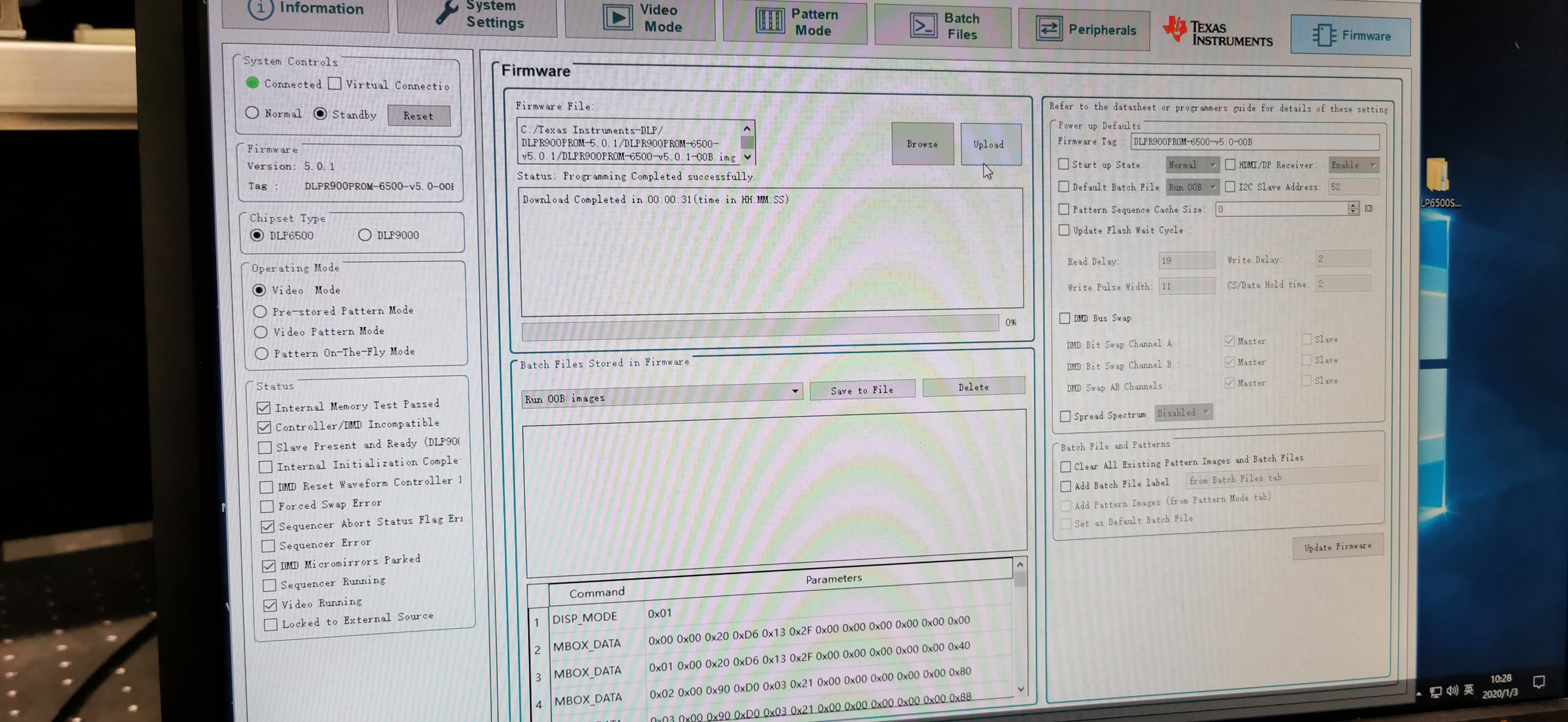

When I connected the EVM via USB, in the GUI I can see connected. But once i switch to the pattern-on-the-fly mode, it appears "unable to swich to pattern mode,ERROR:invalid controller/DMD".
The LED D5 is dark, D8 & D9 green,D6 blink green. The version of GUI is 5.0.1, the new version. And the flex between DMD and DLPc900 is not bended, is exactly as there used to be. And the EVM I bought in Augest,2019. But this is the first time to use.  Could you give me some advise ASAP? Thank you. I am in a urgent need of this EVM in a project.

    First - Does the status show DMD/Controller incompatible at boot up?
    Please make sure the DMD detected is DLP6500. From what mode are you switching to POTF? From video/prestored pattern. Do you have a default batch file?
    Or are you running OOB(Out of Box) project?-
    If not , could you please flash the OOB firmware available in ti.com.
    If yes, Please confirm the firmware version and Tag below the connection box in GUI to be sure that it is OOB. Also, please confirm if DMD is displaying OOB pre-stored patterns

    Thank you for the reply. When the firmware is v4.0, I failed to switch video mode to the POTF. It is like:
    And then I upgrade the firmware to new 5.01, it failed too.
    It seems like DMD incompatible issue. What leads to this issue. And how to solve the incompatible issue and invalid DMD issue?
