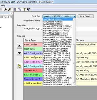

for now, we were using MT28EW128ABA as flash in our DLP system. While we use DLP writing progress, which Part number of Flash should we select?
if we can find right Part number in the list, can we add some contents in FlashDevice.txt. Contents are as follow:
// Mfg      MfgID   LMfgID,                    Device   DevID   LDevID,            Mb Alg     Size #sec  Sector_Addresses

  • Hello Zhanpeng,
    Here is an updated version of our FlashDeviceParameter.txt file that supports the Micro MT28EW128A flash part. You can either replace the file, or you can copy the micron specific contents into your existing parameters file.
    Version, 3
    "Macronix", 0x00C2, 0x00000000000000C2,   "MX29GL128F", 0x227E, 0x000022012221227E,128,0,0x1000000, 128,  0, 0x20000, 0x40000, 0x60000, 0x80000, 0xA0000, 0xC0000, 0xE0000, 0x100000, 0x120000, 0x140000, 0x160000, 0x180000, 0x1A0000, 0x1C0000, 0x1E0000, 0x200000, 0x220000, 0x240000, 0x260000, 0x280000, 0x2A0000, 0x2C0000, 0x2E0000, 0x300000, 0x320000, 0x340000, 0x360000, 0x380000, 0x3A0000, 0x3C0000, 0x3E0000, 0x400000, 0x420000, 0x440000, 0x460000, 0x480000, 0x4A0000, 0x4C0000, 0x4E0000, 0x500000, 0x520000, 0x540000, 0x560000, 0x580000, 0x5A0000, 0x5C0000, 0x5E0000, 0x600000, 0x620000, 0x640000, 0x660000, 0x680000, 0x6A0000, 0x6C0000, 0x6E0000, 0x700000, 0x720000, 0x740000, 0x760000, 0x780000, 0x7A0000, 0x7C0000, 0x7E0000, 0x800000, 0x820000, 0x840000, 0x860000, 0x880000, 0x8A0000, 0x8C0000, 0x8E0000, 0x900000, 0x920000, 0x940000, 0x960000, 0x980000, 0x9A0000, 0x9C0000, 0x9E0000, 0xA00000, 0xA20000, 0xA40000, 0xA60000, 0xA80000, 0xAA0000,0xAC0000, 0xAE0000, 0xB00000, 0xB20000, 0xB40000, 0xB60000, 0xB80000, 0xBA0000, 0xBC0000, 0xBE0000, 0xC00000, 0xC20000, 0xC40000, 0xC60000, 0xC80000,0xCA0000, 0xCC0000, 0xCE0000, 0xD00000, 0xD20000, 0xD40000, 0xD60000, 0xD80000, 0xDA0000, 0xDC0000, 0xDE0000, 0xE00000, 0xE20000, 0xE40000, 0xE60000, 0xE80000, 0xEA0000, 0xEC0000, 0xEE0000, 0xF00000,0xF20000, 0xF40000, 0xF60000, 0xF80000, 0xFA0000, 0xFC0000, 0xFE0000,
    "Spansion", 0x0001, 0x0000000000000001,   "S29GL128S",  0x227E, 0x000022012221227E,128,0,0x1000000, 128,  0, 0x20000, 0x40000, 0x60000, 0x80000, 0xA0000, 0xC0000, 0xE0000, 0x100000, 0x120000, 0x140000, 0x160000, 0x180000, 0x1A0000, 0x1C0000, 0x1E0000, 0x200000, 0x220000, 0x240000, 0x260000, 0x280000, 0x2A0000, 0x2C0000, 0x2E0000, 0x300000, 0x320000, 0x340000, 0x360000, 0x380000, 0x3A0000, 0x3C0000, 0x3E0000, 0x400000, 0x420000, 0x440000, 0x460000, 0x480000, 0x4A0000, 0x4C0000, 0x4E0000, 0x500000, 0x520000, 0x540000, 0x560000, 0x580000, 0x5A0000, 0x5C0000, 0x5E0000, 0x600000, 0x620000, 0x640000, 0x660000, 0x680000, 0x6A0000, 0x6C0000, 0x6E0000, 0x700000, 0x720000, 0x740000, 0x760000, 0x780000, 0x7A0000, 0x7C0000, 0x7E0000, 0x800000, 0x820000, 0x840000, 0x860000, 0x880000, 0x8A0000, 0x8C0000, 0x8E0000, 0x900000, 0x920000, 0x940000, 0x960000, 0x980000, 0x9A0000, 0x9C0000, 0x9E0000, 0xA00000, 0xA20000, 0xA40000, 0xA60000, 0xA80000, 0xAA0000,0xAC0000, 0xAE0000, 0xB00000, 0xB20000, 0xB40000, 0xB60000, 0xB80000, 0xBA0000, 0xBC0000, 0xBE0000, 0xC00000, 0xC20000, 0xC40000, 0xC60000, 0xC80000,0xCA0000, 0xCC0000, 0xCE0000, 0xD00000, 0xD20000, 0xD40000, 0xD60000, 0xD80000, 0xDA0000, 0xDC0000, 0xDE0000, 0xE00000, 0xE20000, 0xE40000, 0xE60000, 0xE80000, 0xEA0000, 0xEC0000, 0xEE0000, 0xF00000,0xF20000, 0xF40000, 0xF60000, 0xF80000, 0xFA0000, 0xFC0000, 0xFE0000,
    "Micron",   0x0089, 0x0000000000000089,   "MT28EW128A", 0x227E, 0x000000000000227E,128,0,0x1000000, 128,  0, 0x20000, 0x40000, 0x60000, 0x80000, 0xA0000, 0xC0000, 0xE0000, 0x100000, 0x120000, 0x140000, 0x160000, 0x180000, 0x1A0000, 0x1C0000, 0x1E0000, 0x200000, 0x220000, 0x240000, 0x260000, 0x280000, 0x2A0000, 0x2C0000, 0x2E0000, 0x300000, 0x320000, 0x340000, 0x360000, 0x380000, 0x3A0000, 0x3C0000, 0x3E0000, 0x400000, 0x420000, 0x440000, 0x460000, 0x480000, 0x4A0000, 0x4C0000, 0x4E0000, 0x500000, 0x520000, 0x540000, 0x560000, 0x580000, 0x5A0000, 0x5C0000, 0x5E0000, 0x600000, 0x620000, 0x640000, 0x660000, 0x680000, 0x6A0000, 0x6C0000, 0x6E0000, 0x700000, 0x720000, 0x740000, 0x760000, 0x780000, 0x7A0000, 0x7C0000, 0x7E0000, 0x800000, 0x820000, 0x840000, 0x860000, 0x880000, 0x8A0000, 0x8C0000, 0x8E0000, 0x900000, 0x920000, 0x940000, 0x960000, 0x980000, 0x9A0000, 0x9C0000, 0x9E0000, 0xA00000, 0xA20000, 0xA40000, 0xA60000, 0xA80000, 0xAA0000, 0xAC0000, 0xAE0000, 0xB00000, 0xB20000, 0xB40000, 0xB60000, 0xB80000, 0xBA0000, 0xBC0000, 0xBE0000, 0xC00000, 0xC20000, 0xC40000, 0xC60000, 0xC80000, 0xCA0000, 0xCC0000, 0xCE0000, 0xD00000, 0xD20000, 0xD40000, 0xD60000, 0xD80000, 0xDA0000, 0xDC0000, 0xDE0000, 0xE00000, 0xE20000, 0xE40000, 0xE60000, 0xE80000, 0xEA0000, 0xEC0000, 0xEE0000, 0xF00000, 0xF20000, 0xF40000, 0xF60000, 0xF80000, 0xFA0000, 0xFC0000, 0xFE0000,
    But to answer you question, yes you are able to modify the FlashDeviceParameter.txt file to support whatever flash device you use. Just ensure you use the correct parameters or you may get errors when trying to read/write to the flash.
