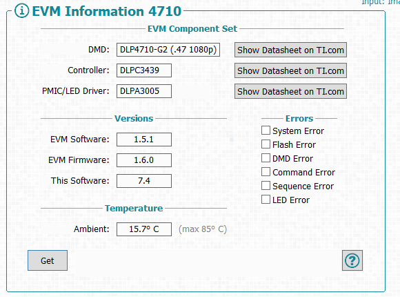

I'm having an issue setting the image orientation (flip and mirror) over i2c.  The process I am using is as follows...
1) Write command to Display Image Orientation register 0x14 with bits 1 and 2 of the data byte set to required orientation.
2) Short delay (tested from 100ms to 1s)
3) Read back register 0x15 to confirm the orientation was set.
My problem is that in about 1 out of every 10 to 15 times, the orientation fails to change on the projector.  During these failed attempts, register 0x15 reports the correct value and I see a disturbance on the projected image but the image orientation doesn't change to the new setting.
Any ideas on things to try or an explanation would be greatly appreciated..
