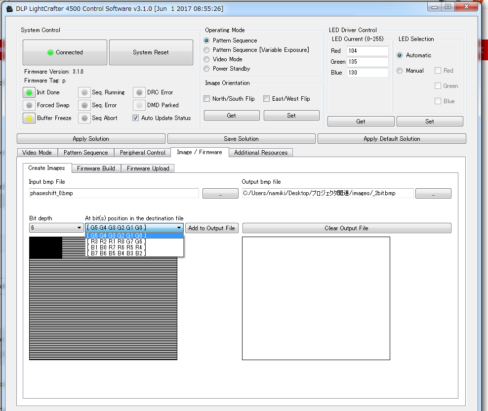

Hi!
I want LCR4500 to project higher speed than 8 bit depth so I attempt to create 6 bit depth image with GUI 3.10 using 8 bit depth image(intensity 0~255). Then I try to project 6 bit pattern, but It seems LCR4500 project 8 bit pattern not 6 bit pattern.
How can I project 6 bit pattern?
Do I have to make the 6 bit pattern (intensity 0~63) first? or Can I make 6 bit pattern with GUI using 8 bit pattern?
This is my attempts. Input bmp file is  phase shift pattern (8bit).

  • Hi User,
    I have looked into your query and with DLPC350 FWv4.1.0 and LCR4500 GUI v4.0.0, we are able to display 6 bit patterns without any issues. Could you kindly update to the latest version and try again? If you still face the problem, kindly provide your INI pattern settings and the test image so that we can reproduce the issue at our end and resolve faster!
