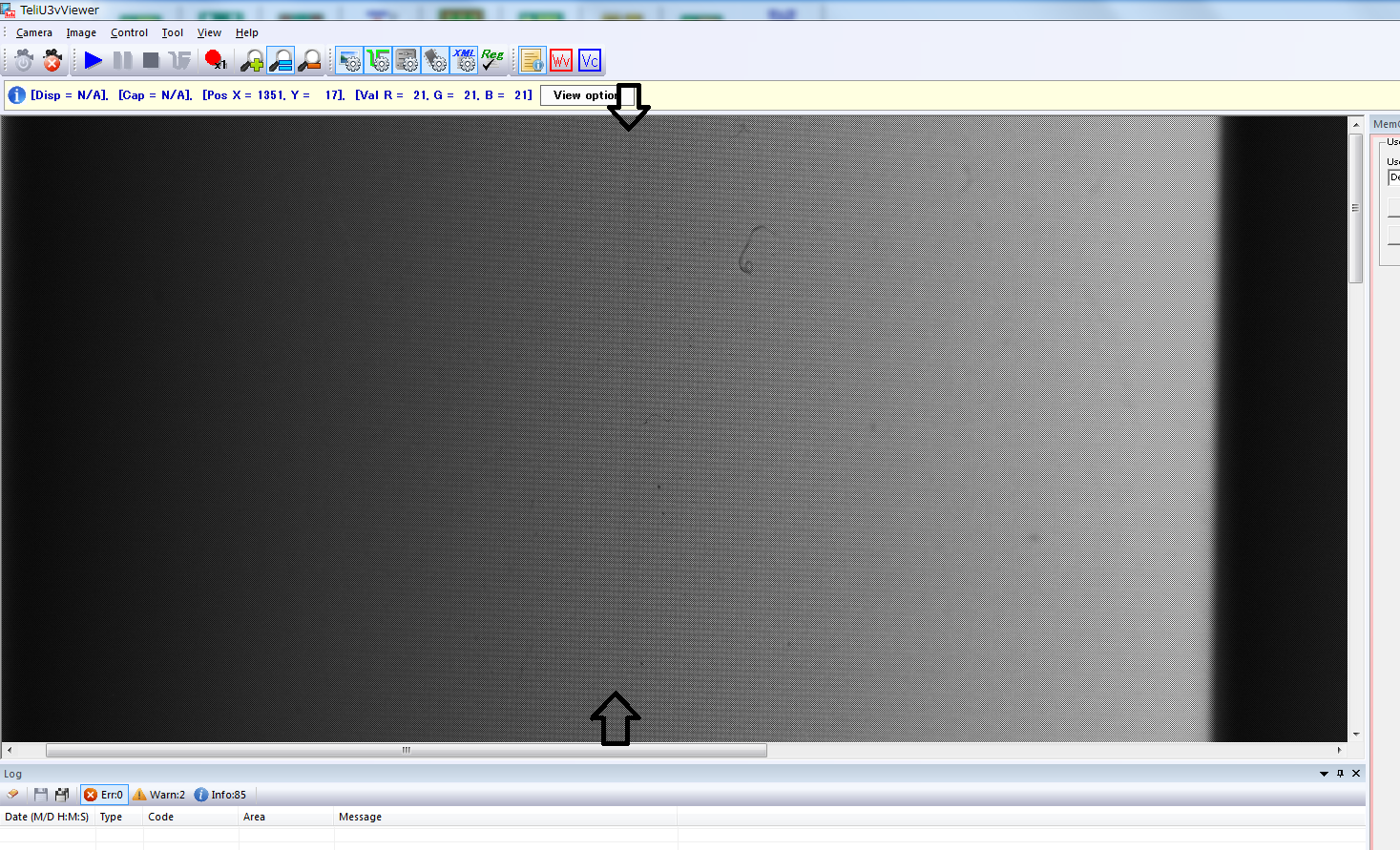

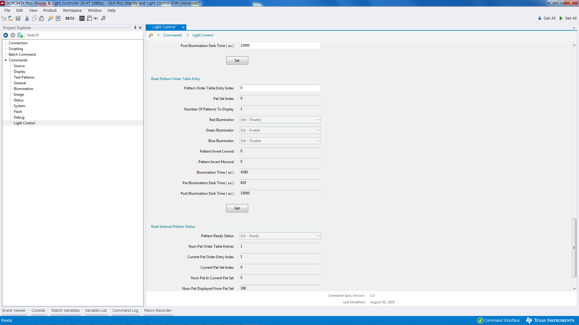

  • Hello Navneet,
    Thank you for your reply.
    I have tested same thing on EVM, and the result seems to be same.
    I will insert 3 files.
    1) 1D Ramp image
    2) Exposure condition on EVM
    3) Captured image of ramp pattern on screen
    You can see gray level discontinuity indicated with arrow on 3rd image.
  • Hi User,
    let me try the same timings as yours on my hardware. I will get back to you with my findings very soon.
    Navneet
  • Hi User,
    I can reproduce the issue as above mentioned. We are working on this to find the root cause and will fix this in next maintenance release.
