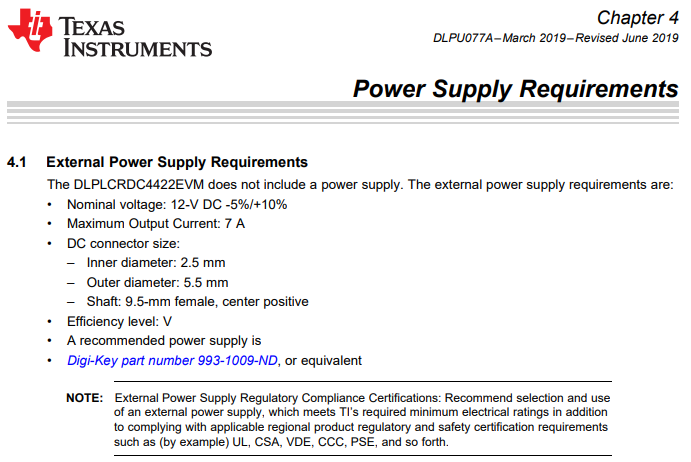

Part Number: DLPLCRDC4422EVM
Which is correct polarization of power supply connector, the center is plus or minus?
What is plug definition?

Per the EVM User's Guide section 4.1 (External Power Supply Requirements), the center pin is positive (+). It should mate with a 5.5mm (OD) x 2.1mm (ID) x 9.5mm (length) barrel plug. 12V -5%/+10% 7A Max is recommended. A power supply is recommended in the User's Guide.
