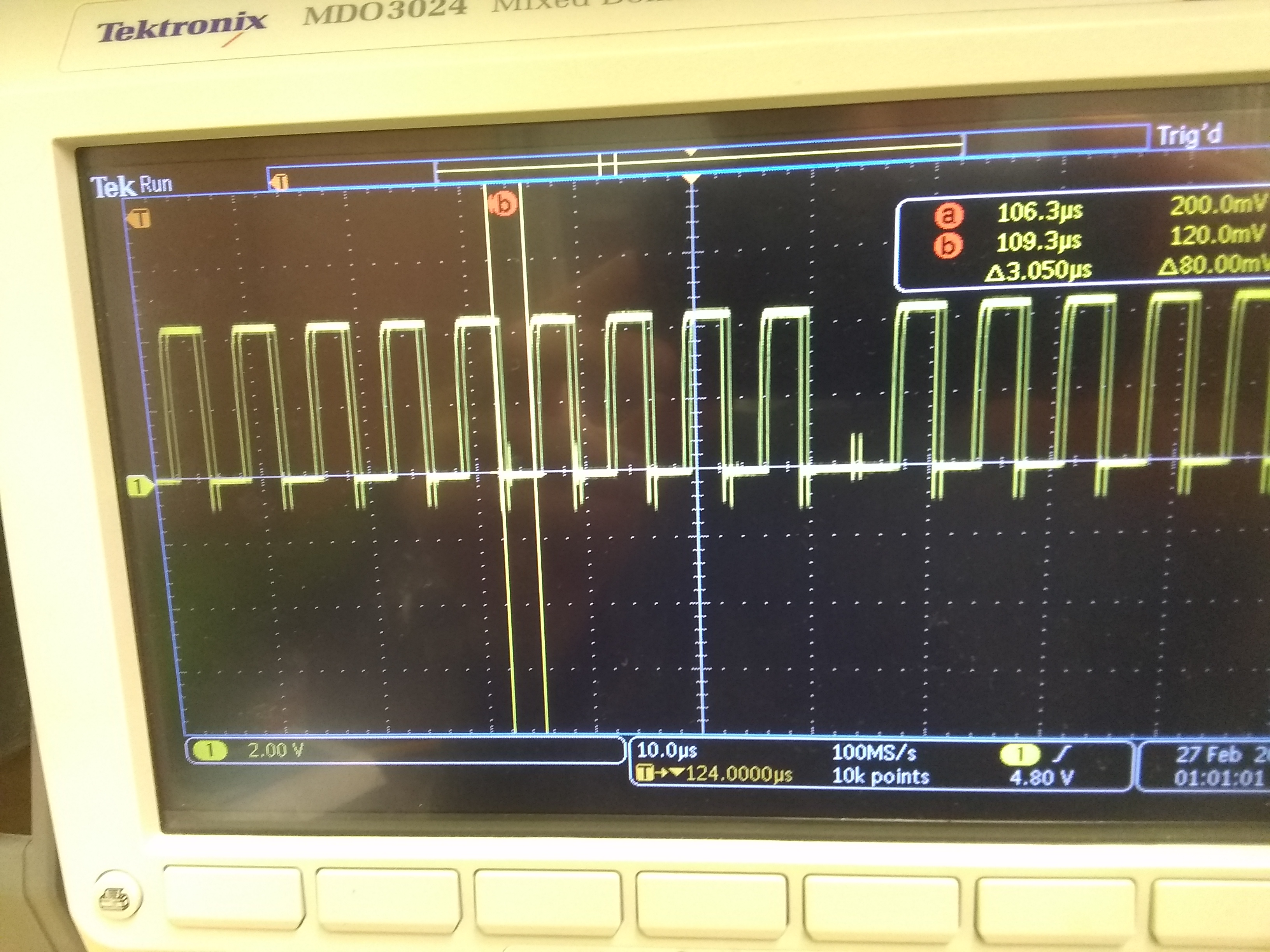

  • Hi Philippe,
    Thanks for your reply.  I have done some troubleshooting and scoped my SCL to confirm the baud rate.  I have attached a picture of my clock signal.
    I am also checking to make sure that the EVM is sending acknowledge bits back to my microcontroller after each byte sent.  I am sending 8 bits at a time and am getting acknowledge bits from the pico after each byte, then sending the next 8 bits.  I am displaying the acknowledge bits on an LCD screen so I know the EVM is getting my data transfer.  The problem is that my splash screen is still not changing even though the EVM is acknowledging data transfer.  I have included my register writes below.  Can you take a look and see if I am missing something?  I feel like the registers are not being written to for some reason.  Thank you.

    After many hours going over my code I found a bug in it.  It had to do with the way I was setting my interrupts.  I can now communicate with the pico using my PIC via I2C.  Thank you.
