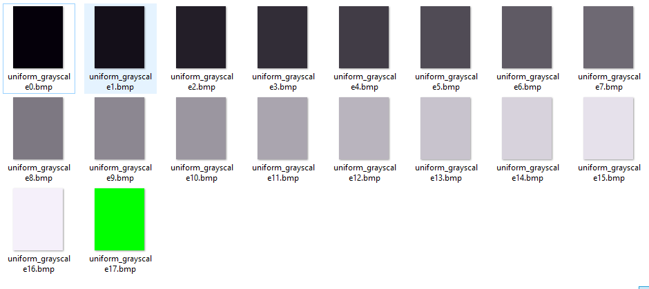

 I have 17 blank pictures which go from black to white. When I try to form pattern sequence on the DLP4500 GUI, I project each picture with 8-bit green plane, 8-bit red plane, 8-bit blue plane. And therefore the projector should project 17*3 = 51 times. Starting from a gray scale point of 0, each time it projects the grey scale point of the picture should increase 5; and when it reaches to the 51th picture the grey scale point should be 255.
          In that sense, if we imagine a plot of grey scale point vs. # of pictures, it should show a positive linear line. However, things did not happen as expected. Below is what I found:
          When we project 51 pictures, when it reaches the 27th time, the gray scale point of the picture drops down to 0 and starts to increase again from 0 gray scale point. This is not expected because the gray scale point should be continuously increasing, meaning at the 27th time it should increase 5 gray scale point in addition to the 26th's gray scale point.
           I did some experiments and found that if the projector projects 30times, gray scale point drops down to 0 on the 16th time; 25 times will make gray scale point drops to 0 on 14; 20 times will make gray scale point drops to 0 on 11; 15 times will make gray scale point drops to 0 on 9; 10 times will make gray scale point drops to 0 on 6; 6 times will make gray scale point drops to 0 on 4; 4 times will make gray scale point drops to 0 on 3........
Why is this and how could I solve it? I would really appreciate if you can take time to look into this problem. Thank you!

  • Hello Hirak,
             I'm using the 4.1 version firmware and the 4.0 version GUI. I have 22 images in total. The 17 images that I talked about starts from index 5.
             What I did was I go to patter sequence and I select a bit depth of 8, and white color. My pattern exposure was adjusted to 8333 μs and my pattern period was adjusted to 200000 μs. Having a long pattern time is for me to observe the problem. Starting from index 5, I add its 8 bit green plane to the sequence, then red, then blue. And I repeat the step for index 5 to index 22. Then I clicked play once, send, validate and play. The LED current was kept as origin, which was red 104, green 135, blue 130.
    Below is the ini file and a capture of my images, as I am not able to upload them here. Thank you very much!

  • Hi Raymond,
    I have experimented with your INI and images and have found that there is a FW bug that causes the pattern sequence to skip through certain splash images in the pattern LUT. With your INI it was missing almost every other splash images. I am sending you a private message request where we can talk more about this. I am closing this thread.
