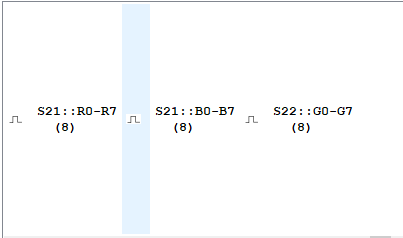

Hellp TI support team:
        I have a projector connected to a Basler camera through trigger wire. I have formed a pattern sequence and would like to trigger the camera to capture images as many times as the number of patterns. Below is a portion of what I have: basically I have inserted an internal trigger signal in between each pattern and expected that every single pattern can be captured. Both trigger out rising and falling edge delay are set to be 187 us. However, when I execute this, the camera could only capture once, which is the first pattern that the projector projects.
        It seems that the camera can receive the correct trigger signal as it can capture the first pattern. However, the trigger signals after that was not received at all. Is there any step that I have missed or anything wrong that I have set?
        Thank you for takin g time to look into this problem. Thank you!
  • Hi Raymond,
    Welcome to TI E2E forums! Could you kindly provide the INI configuration of the pattern sequence you are using ? Also, could you kindly confirm that you are using DLPC350 FW v4.1 and LCR4500 GUI v4.0 ? This will help us pinpoint and fix the issue faster.
