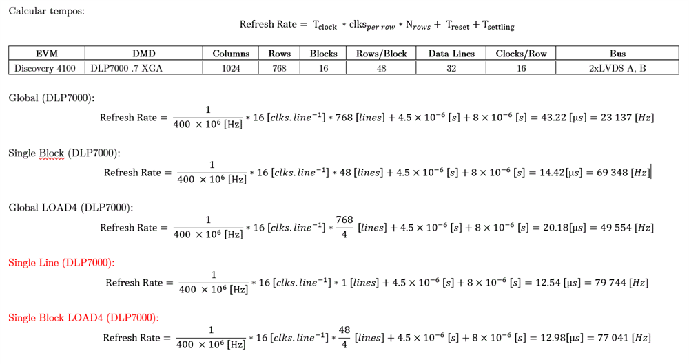

    I'm trying to calculate correctly the refresh rate for different operating modes. Could you please check the following math?
    I'm not sure if I can calculate the refresh rate in this way for "Single Line" and for "Single Block LOAD4"
    Thank you,
    Cédric
  • Hello again Cédric,
    That looks correct assuming you are using Global reset for all these modes.
    Be aware that the DLPC410 does not have any video or RGB input defined.  It has to be programmed at the APPS_FPGA by you.
    Fizix
