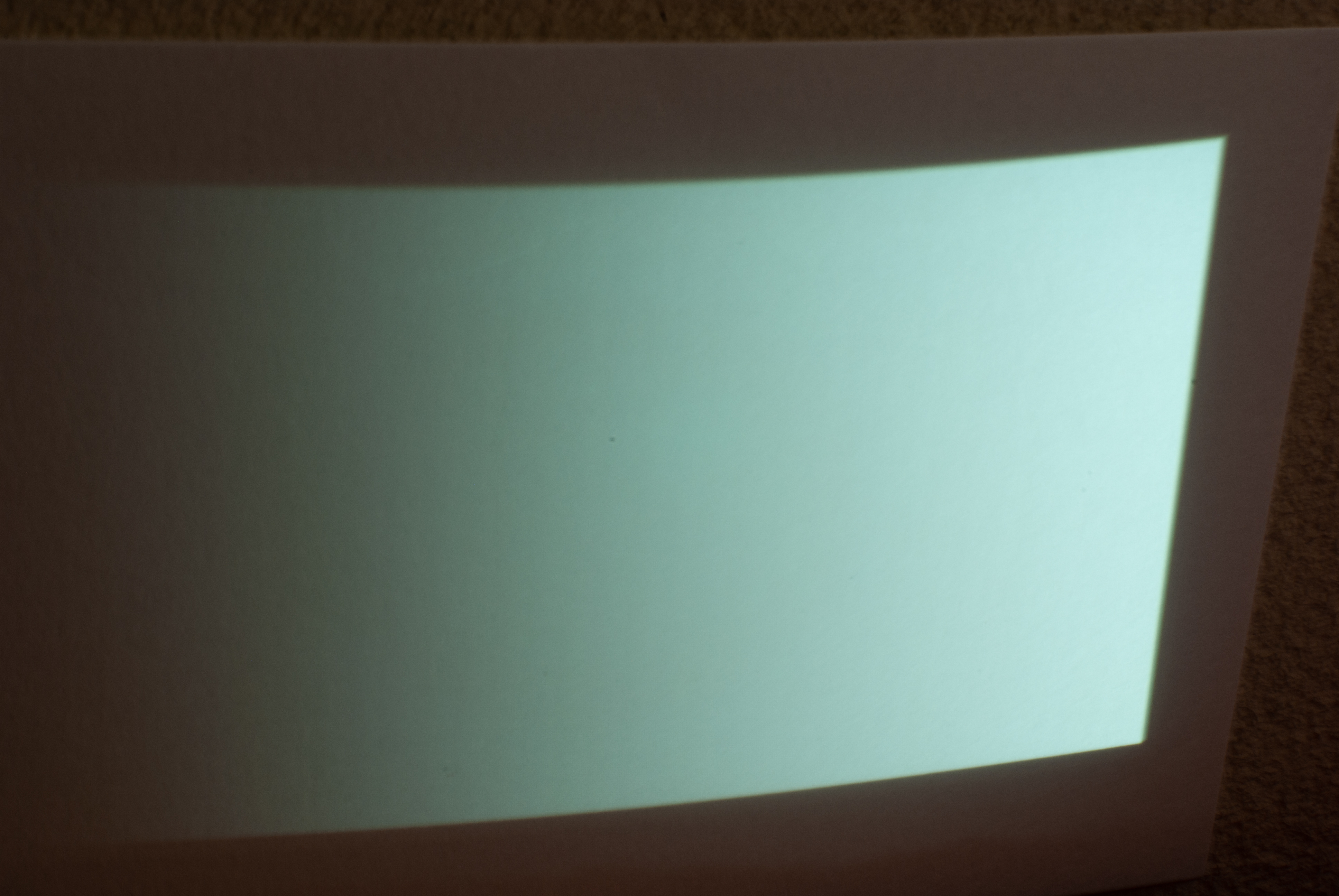

We are still evaluating the DLP3010EVM-LC.

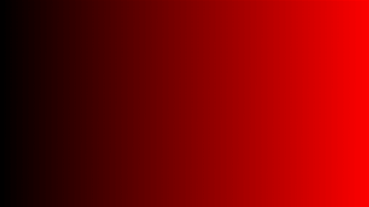

The question is the difference between the splash pattern save format and the screen mode
The display is different.
As a result, except for the combination of ScreenMode_16-bit and YCbCr 422
It was a mysterious display.
With the registered splash pattern data
For the following four outputs
I attached the captured image.
Registration data:
0.Splash_glayscale_ORG
Each display content
1.PatternMode_16-bit RGB 5-6-5
2.PatternMode_16-bit YCbCr 422
3.ScreenMode_16-bit RGB 5-6-5
4.ScreenMode_16-bit YCbCr 422
I want to use "2.PatternMode_16-bit YCbCr 422".
However, it is not the expected display of 8bit scale.
why?
Could you also explain each display content?
Thank you.

  • Tak,
    Kindly explain to me in which mode are you trying to display the patterns - 16 bit formats are not supported in any of the light control modes of this chipset.?
    I am assuming that you have captured the 4 images by displaying the input image (Splash_glayscale_ORG) in the external pattern mode for the first 2 cases mode and in external video mode for the remaining 2 cases.
    Please correct me if I am wrong.
    Mayank

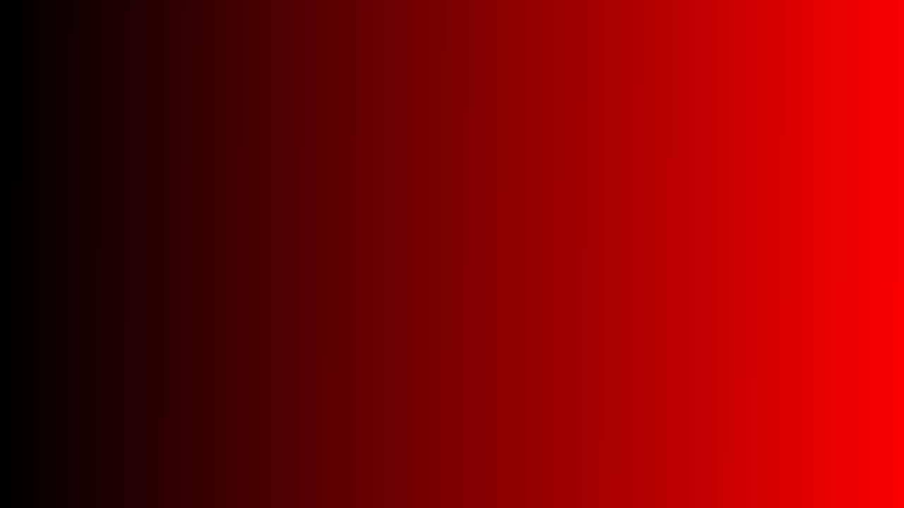

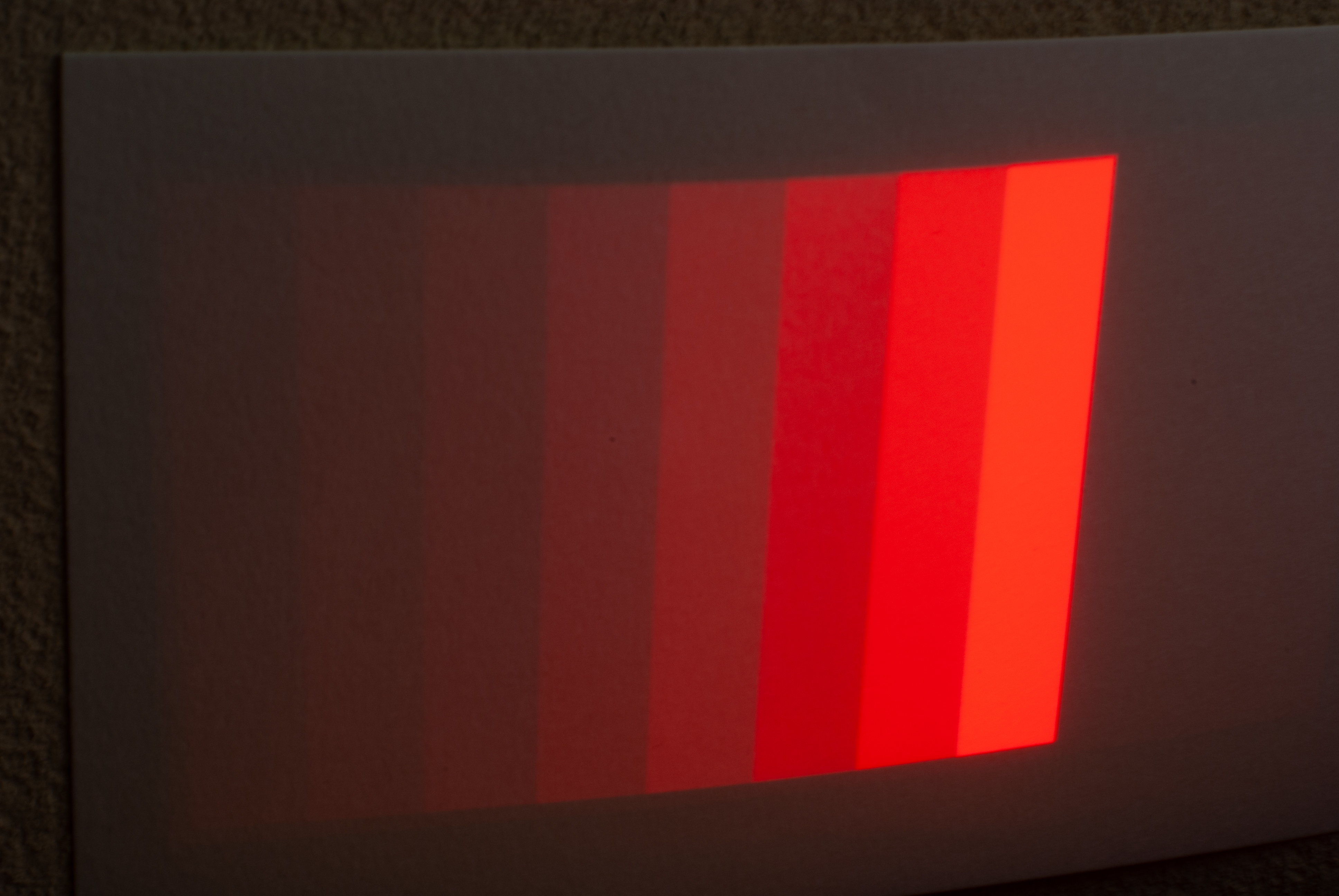

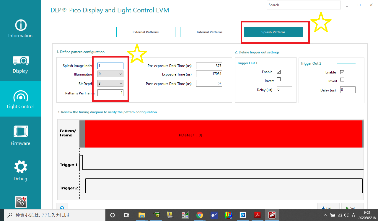

  • Mayank,
    The images I captured are as follows.
    External mode is not used..
    2.PatternMode_16-bitYCbCr 422
    →Light Control . Splash Pattern Mode
    →Display - Splash Screen Mode
    I splash-registered "Splash_glayscale_ORG"
    I made the following settings.
    I think the result will be the following image.
    However, if you capture "1.PatternMode_16-bit RGB 5-6-5" or
    The result is "2.PatternMode_16-bit YCbCr 422".
    Either way, it's not ideal.
    I believe in you
    Will you check again and solve?
    Tak

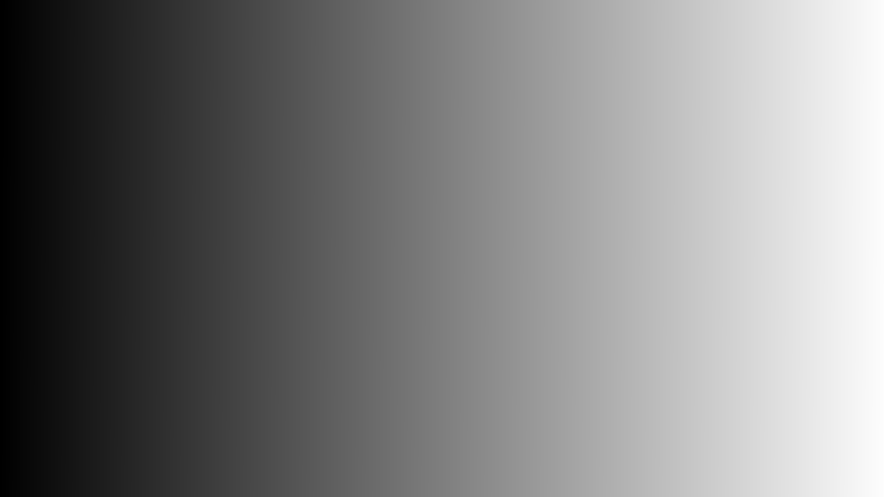

  • Tak,
    The input image that you are using "Splash_glayscale_ORG" is a RGB888 PNG image.
    All the Splash images are stored in the flash memory in a 16 bit format.
    When displaying these images in Splash Screen mode, the system automatically initializes the system color processing based on the splash header information prior to sending the splash image down the controller data path. However, in Light Control - Splash Pattern mode, no color processing is performed and the stored bitmap is displayed as is, irrespective of whether the image is stored in RGB565 format or YCrCb (16-bit) format. Therefore, to get an accurate representation of the input image in splash pattern mode, the images must be stored in RGB565 format in flash.
    This is the reason why you are not seeing expected output while running the Splash pattern mode.
    Mayank

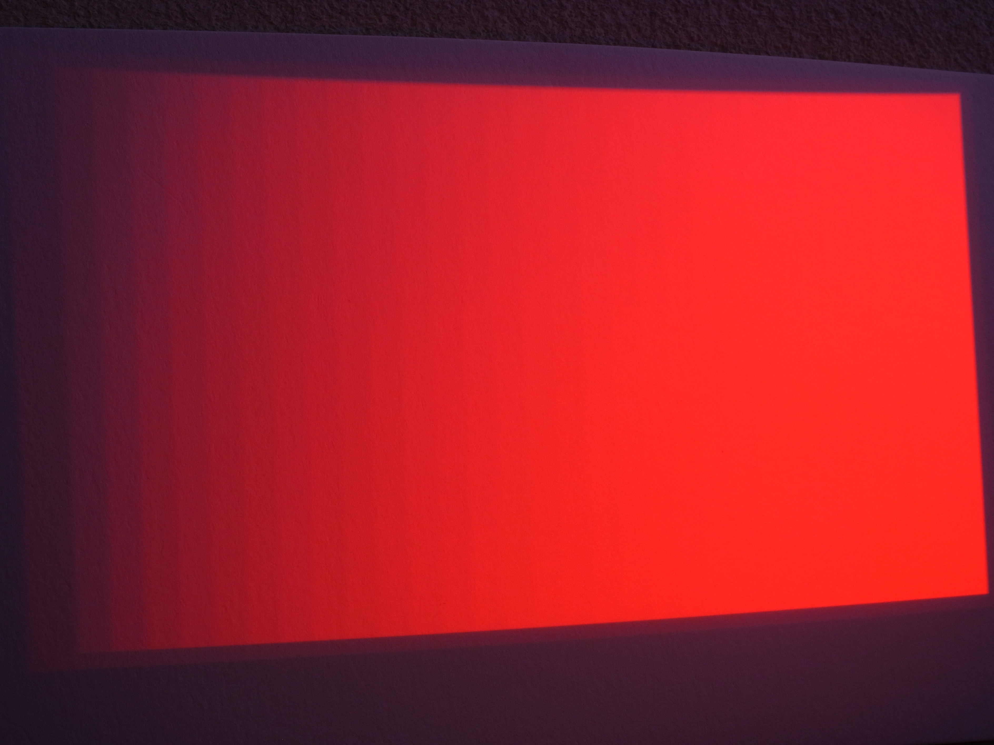

  • Mayank,
    Save in RGB565 format and according to your description
    The following can now be displayed.
    Although it has a gradation of 5 bits,
    My goals have been achieved and resolved.
    Thank you so much.
    Tak
