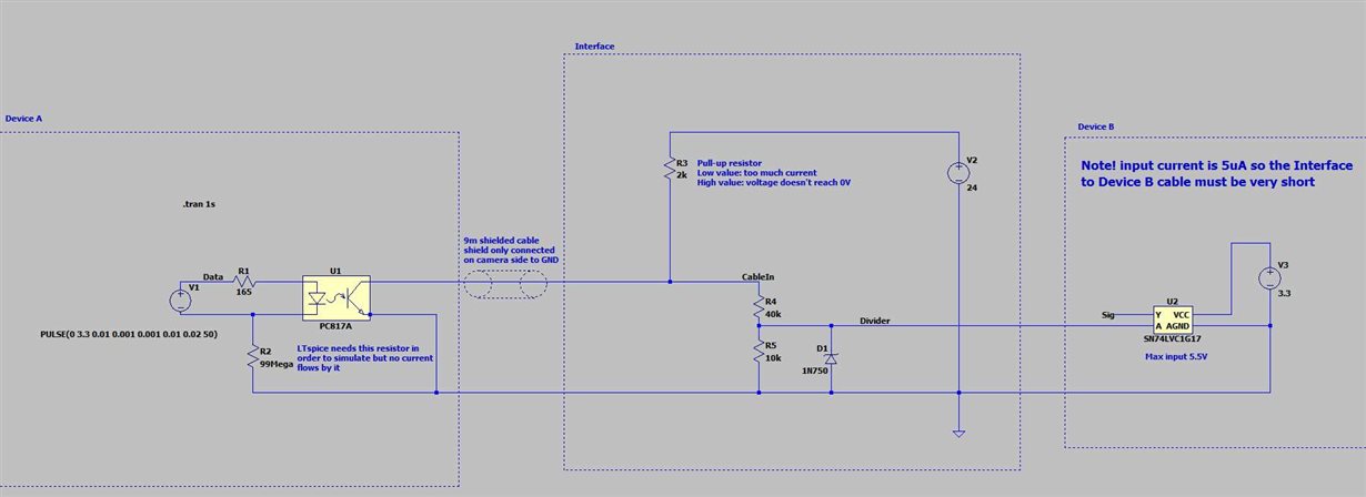

Hi, I want to use the TRIG1_IN signal so that the camera triggers the next pattern in the sequence.
The camera is quite far from the projector (6m cable). So I plug the cable in an opto-coupled camera output and on the other side I have a voltage divider and Zener to lower the output voltage to 0-3.3V
Looking at the DLPLCR6500EVM schematics I see that a SN74LVC1G17 buffer is used at this input. This buffer has an input current of 5uA so I'm afraid that I will have issues with electrical noise. My Interface Device will be connected to the DLPLCR6500EVM via a PicoBlade-to-PicoBlade Off-the-Shelf (OTS) Cable Assembly, Single Row, 50.00mm Length, 6 Circuits. I'm trying to minimize this connection to the projector, will this be enough? What can I do to improve the reliability of this connection?
A simulation of the system is here:
  • Hello again Pedro,
    This will depend greatly on how noisy your environment is.  From your simulation, how sensitive will the noise be?  I know that with some of our camera connections we have used cables of the length you mention, but not a circuit like this one.

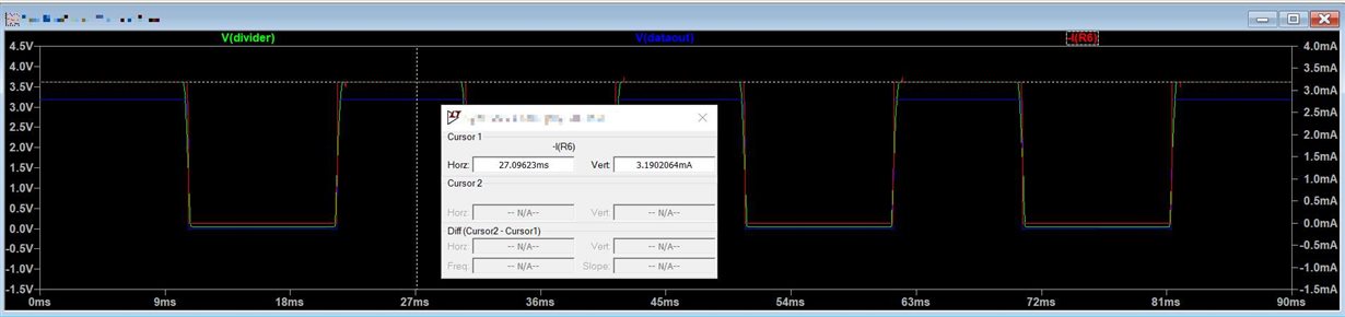

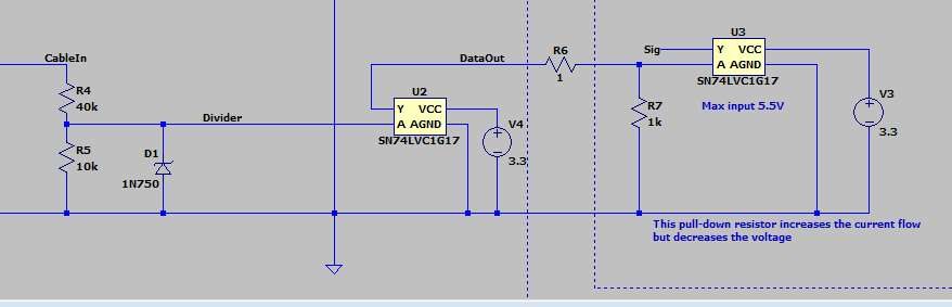

    I've been advised to use another SN74LVC1G17 on the Interface and place a pull-down resistor on the Projector's connector side so the current in the cable increases.
    And this is the result, I have around 0 to 3mA signal, which is 1000 better ;-)
    It would be great that the projector already have this resistor on these inputs, because they are needed.
    I didn't have much info from Wintech side on the software questions, hope they also see this thread and add some information.
  • Pedro,
    I talked with one of our EE's here that is familiar with trigger circuits and he agrees that the second circuit is better than the first.
